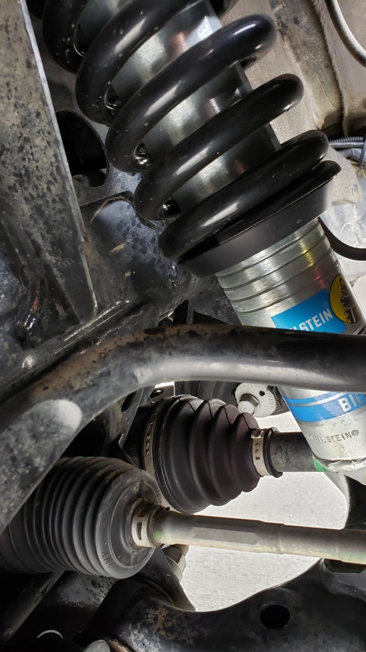

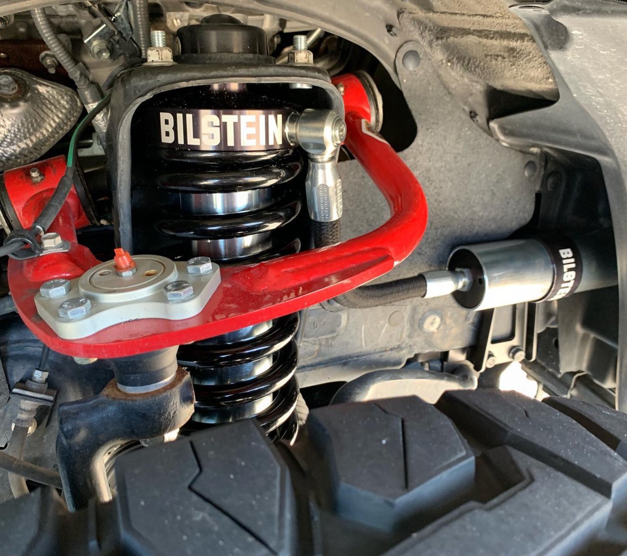

    Are you sure whoever installed the 6112's counted from the bottom up and set them on the TOP clip position and didn't count from the top down to set them on the minimum position? There's no way a #5/4 setting wouldn't lift an access cab. Post a pic of the coilover please.

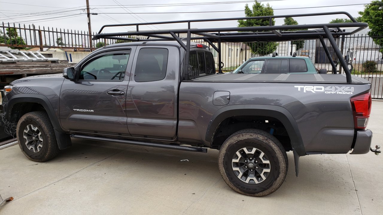

    Do you have pictures before the lift? Looks lifted to me.

    Here is where it sits currently.

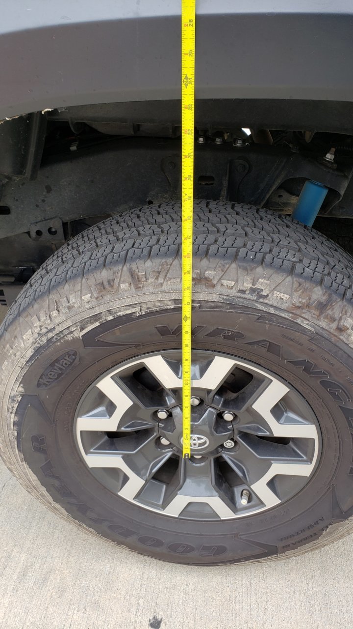

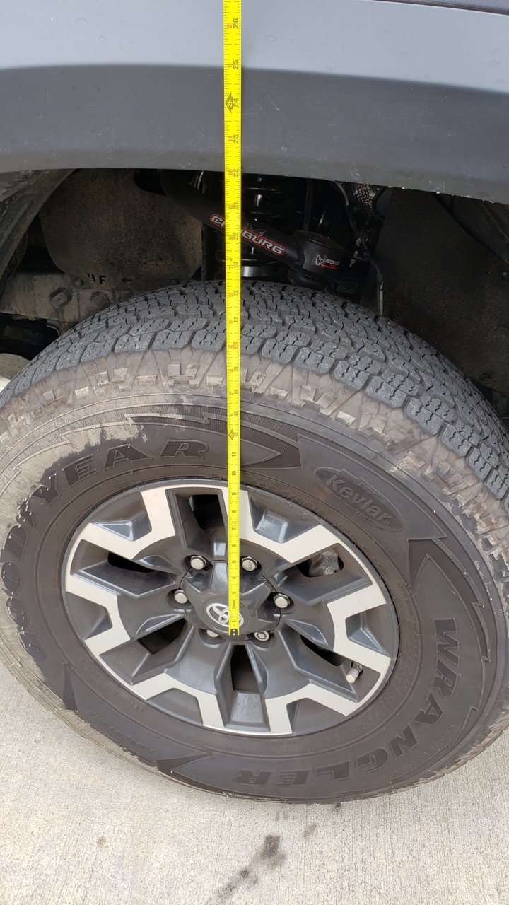

  4. Jun 14, 2019 at 10:55 AM
    #2384
    Tonche
    Tonche Well-Known Member
    Jul 31, 2018
    #261166
    202
    Tony
    2018 Tacoma TRD OR ACLB
    It was at 21 front and 24 rear a few days after install. Looks like it settled more?
    Now its
    22" front driver 22 3/4" front passenger
    23" rear driver 23.5" rear passenger
    I didn't measure preinstalled, I was going off of information that stock height was 21 fronts 22 rears.

    That looks about right to me. 2nd gen with TRD PRO 6112’s and 5160’s. I’m sitting at ~22 inches front, 24” rear with Dakar 95R’s

    Thanks! I was thinking I did something wrong because I didn't get any lift. But I guess it was just settling in.
