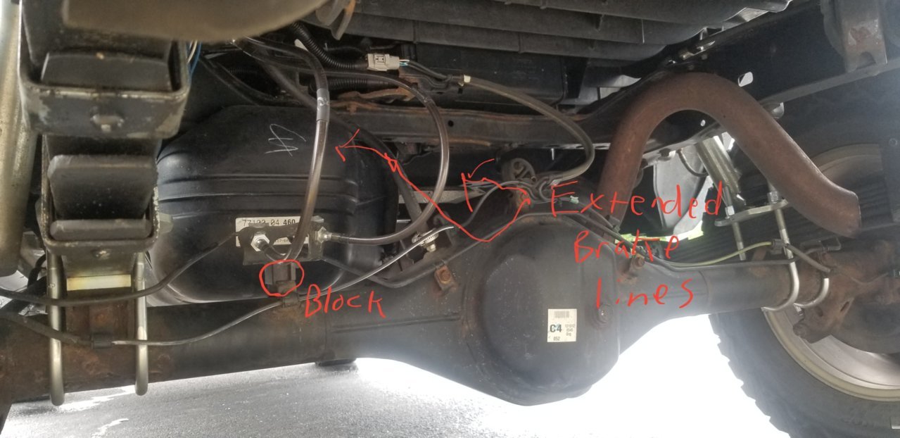

    So this just means that you order 2 right side ones and instead of the break block you can add extended brake lines and you should be all set then. I ordered mine together and put in the spacer block for the break lines but then added extended brake lines anyway to be safe. The brake line spacer just adds more room for the OEM line to flex due to the lift of the rear of the truck.

    I will take a picture of "the block" that is installed underneath my truck to show you that the extended brake lines will do the same thing. Give me a quick moment....here it is....

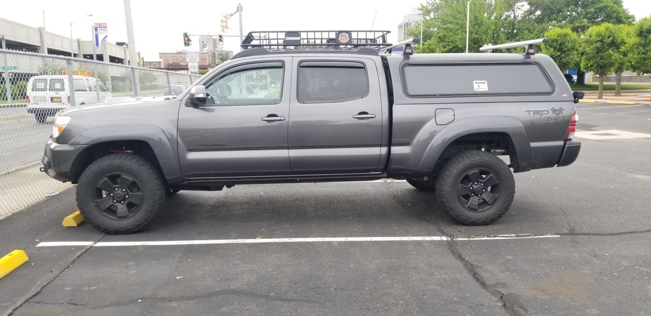

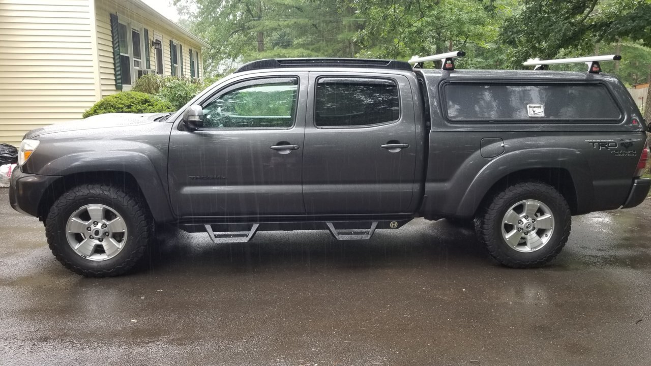

    I had it on before the lift and never took it off. It was level at first but in the second picture I added more weight to the front and a 1/2" lean spacer block in the rear. I just ordered 650 bilstein springs to bring up the front a little due to my bumper and skid plat trio.
    Before
    After
