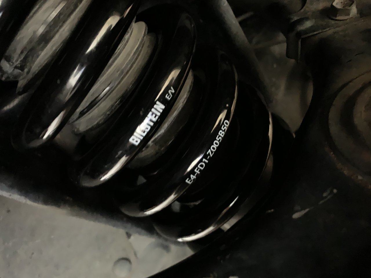

    Just installed the coils(600lb) from the 6112 kit. Bought from someone who upgraded to 700lb spring rate. I purchased just the coils to replace my broken coils on my 2015 TRD Pro shocks. Which is similar to the 6112 shocks. After installing these coils it raised the front by 1” and it rides a lot stiffer than before. From what I read the 2015 TRD Pro spring rate is 600lbs. Does anyone have this same part number on their coils that have 600lbs?

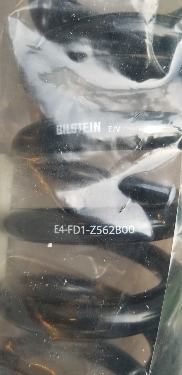

    Pretty sure those are 700lb springs by the process of emilination. 600 are E4-FD1-Y005B29 and 650s are Z562B00

    I am wondering if they are 600lb springs because bilstein had two separate numbers for 600lb springs, one for the 2nd's and one for the 3rd gen's in the 6112's. I just checked my second gen springs and I couldn't find a number on them but they are caked with mud though.

    Hmm..not sure if its 600LB. All the research i did for the 15' trd pro spring rate was 600LB. But im still trying to find out what these are.
