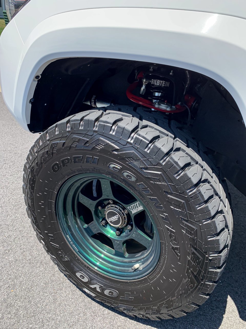

  10. Jul 1, 2019 at 6:21 AM
    #2470
    Akkording
    Akkording Well-Known Member
    Mar 19, 2018
    #247722
    666
    Pete
    Houston
    03 +300k Still Truckin, 2012 4Runner
  11. Jul 1, 2019 at 7:22 AM
    #2471
    Yota_Ivan
    Yota_Ivan Geaux Tigers!
    Oct 31, 2018
    #271238
    278
    Arlington, TX
    2006 Tacoma DCLB 4x4 TRD Sport
    A little bit of this, a little bit of that...
    Looks freaking awesome!!
    Would you consider selling and shipping the 650# springs separately?
  12. Jul 1, 2019 at 7:24 AM
    #2472
    oscolivar1
    oscolivar1 Well-Known Member
    Oct 30, 2013
    #115568
    2,267
    Oliver
    VA
    2017 Tacoma Limited
    Bilstein 8112/8100, JBA UCAs, Icon RXT leaf pack, work wheels 17x8.5;-10os, 285/75/17 cooper LTX AT3, Mobtown HC rear bumper and Sliders, SSO front bumper, BAMF greceased grill.
    Currently sale is pending.
    Yota_Ivan[QUOTED] likes this.
