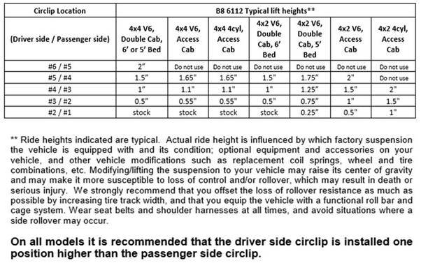

    I'm a "slow mover" as my son calls me so it took me two full days on and off to get it all done without help (except for bleeding brake system). I put in 6112, JBA UCA, Dakar el095, 5160, extended brake lines. Now to investigate why i'm idling low (500 - 550RPM range) after two days with battery disconnected. Enjoy the install and watch your head :D.
    BTW how do you get 5/6 ? They only have 5 notches. Is there an adapter?

    I Got a 2006 TRD Sport DCLB and here are my before/after lift numbers. My 6112 were set at clip 5 and I have OME Dakar in the back. Angle figures are based off my garage floor and are absolute
    Are these numbers OK? Thought I would get 2.46 or better upfront. Seems I got ~2" all around.

    "OME Dakar Springs part # EL095R provide approximately 2.75" lift on a 05-15 Tacoma"
    "Bilstein 6112 Spring Ring location #5 average lift 2.46in."

    There is 2 different models of 6112s. One for the 2nd gens 1-5 notch and one for the 3rd gens where it’s staggered for taco leans.
    2nd gens will offer more lift if placed on 3rd gens

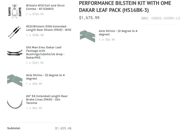

    im now thinking of getting the 6112s with extended rear 5100s since its taking the 5160s so long to be back in stock. but with that being said, headstrongs complete 6112/5160 combo with medium dakars is only $75 more than if i were to piece out the 6112/5100/medium dakars separately. anyone able to piece these parts out separately and save more than that?

    mostly just a weekender for camping and driving on fireroads. i wont be doing any crazy offroading. with that being said, i have 17x8 wheels with 33'' tires and JBA UCAs waiting for install as well. heres the pricing from headstrong with 6112/5100 on the left and 6112/5160 on the right

    5100 should be a good option I think.
    What is the shim kit for?

    Sometimes lifting the truck introduces driveline vibrations, so the shims help adjust the angle of the differential close to factory settings. You'd need to measure the angle before and after to know what shim size you'll need.

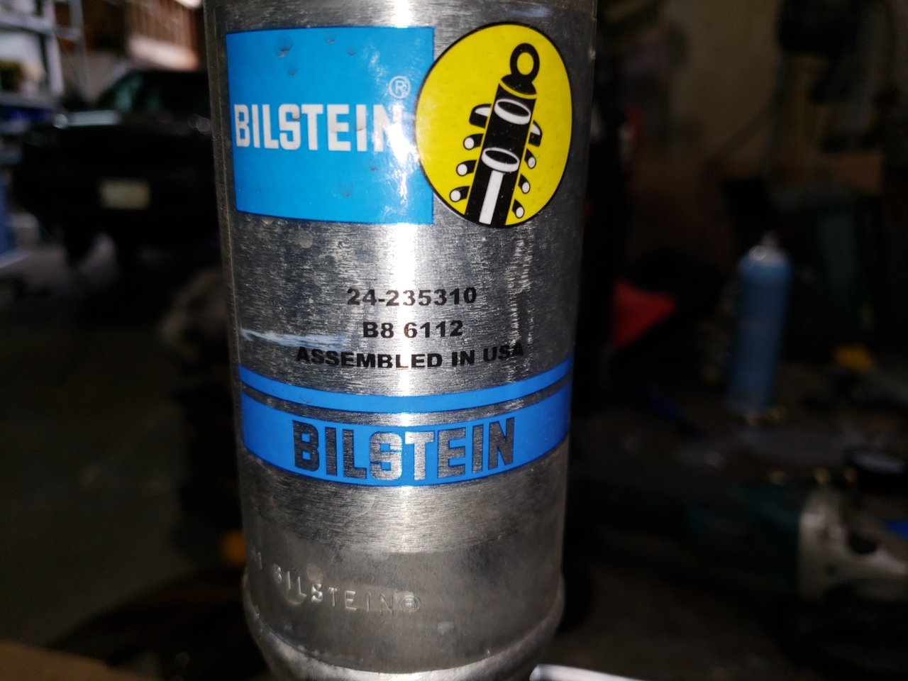

    @Dalegribble02 the easy way to Visually identify if you have 6112's for 2nd Gen or 3rd gen is at the bottom of the shock casing where it is welded to the shaft. The 2nd gen shock housing is square at the bottom of the housing (like pic posted in above post) and the 3rd gen is conical.
