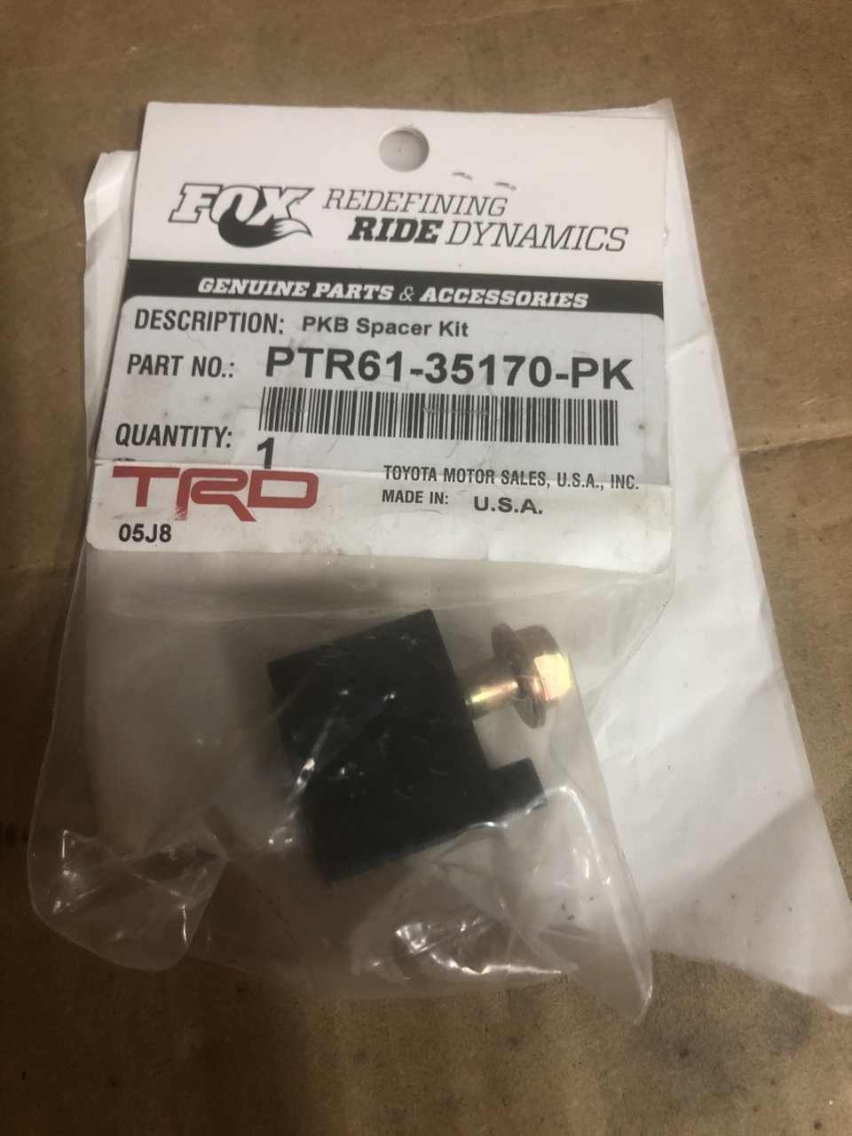

    It’s really not bad at all. Honestly I think it rides better than stock. It’s more supportive but without being harsh and jarring. Truck feels more stable and planted on the highway. Haven’t had a chance to do any trails yet but just driving around my field watering trees it felt pretty good. My wife is super picky about the way suspension rides and she likes it a lot.

    You know after looking at that a bit more, it almost looks like the little block Bilstein gives you for a brake extension with the left side shock.
