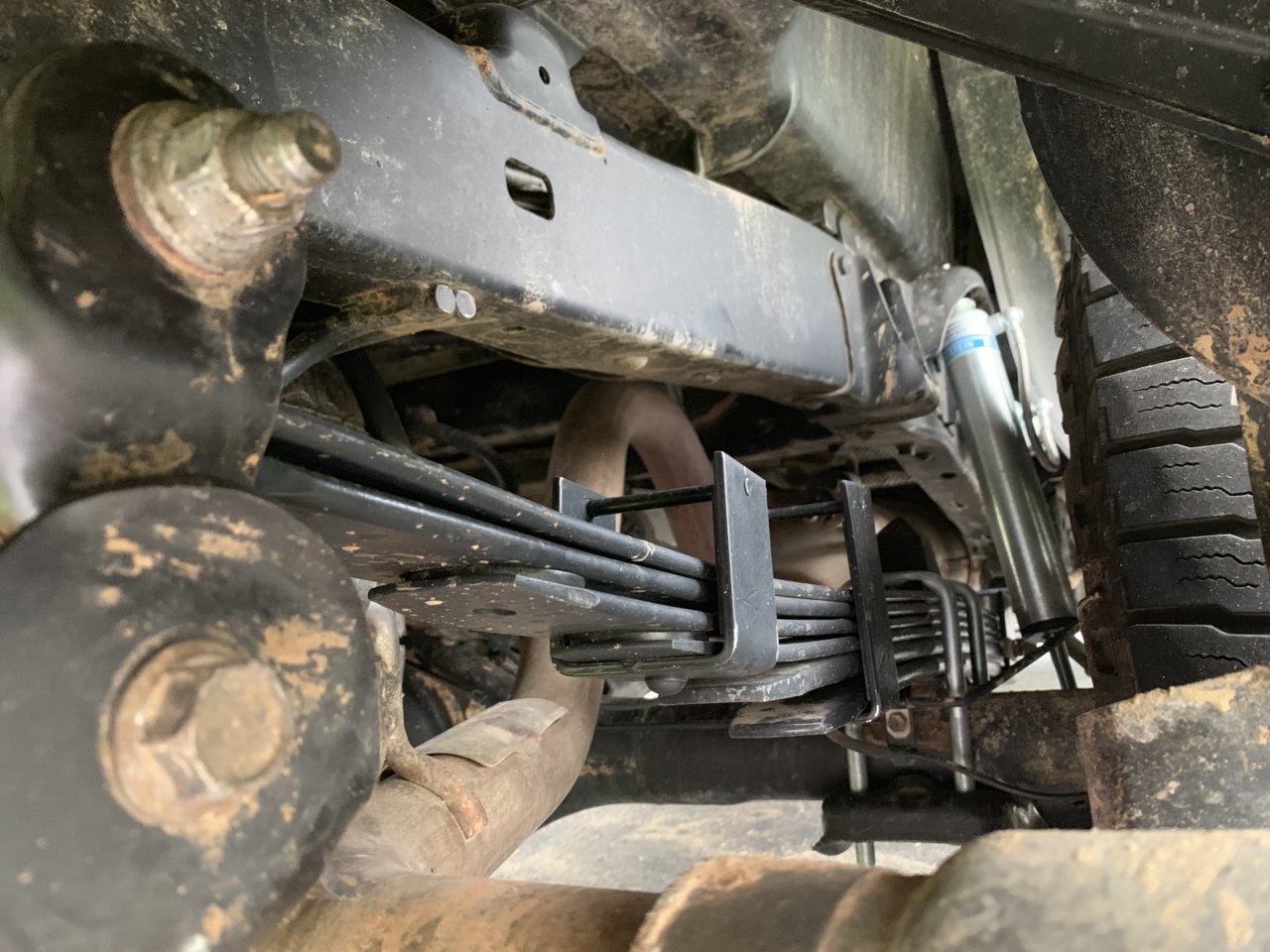

    Bilstein 8112/8100, JBA UCAs, Icon RXT leaf pack, work wheels 17x8.5;-10os, 285/75/17 cooper LTX AT3, Mobtown HC rear bumper and Sliders, SSO front bumper, BAMF greceased grill.
    As far as I know you should not be on option 1 on that much weight even with airbags. You will destroy the leaf pack by making them flat and by that time adding the leafs will be useless, if you really wants the RXT leaf pack at least be on option 2 if you want air bags. Otherwise get a custom leaf pack.
    My offroad trip I had about 400lbs plus in the bed and the 8100 and RXT leaf pack option 3, soaked up all the bumps compared to my 5160s that did a horrible job. The bed was packed to the roof of my softopper with more wood in this pic and other gear from friends, waterport full of water etc. if your wondering the rear dropped about 1.5”-1.75” iirc.
    Good luck. 6CEF3371-70AF-4971-9E1C-C276250CC2EF.jpg5F7C8695-830C-4E47-B14D-676517F1B17B.jpg

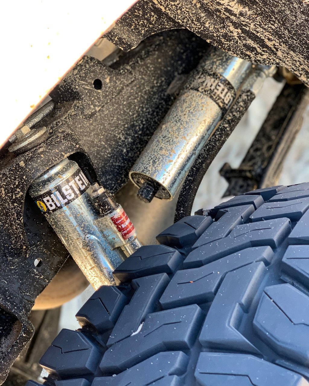

    Hit some trails this weekend. Guess this is why I added those 4” extended brake lines when I installed two right 5160s.

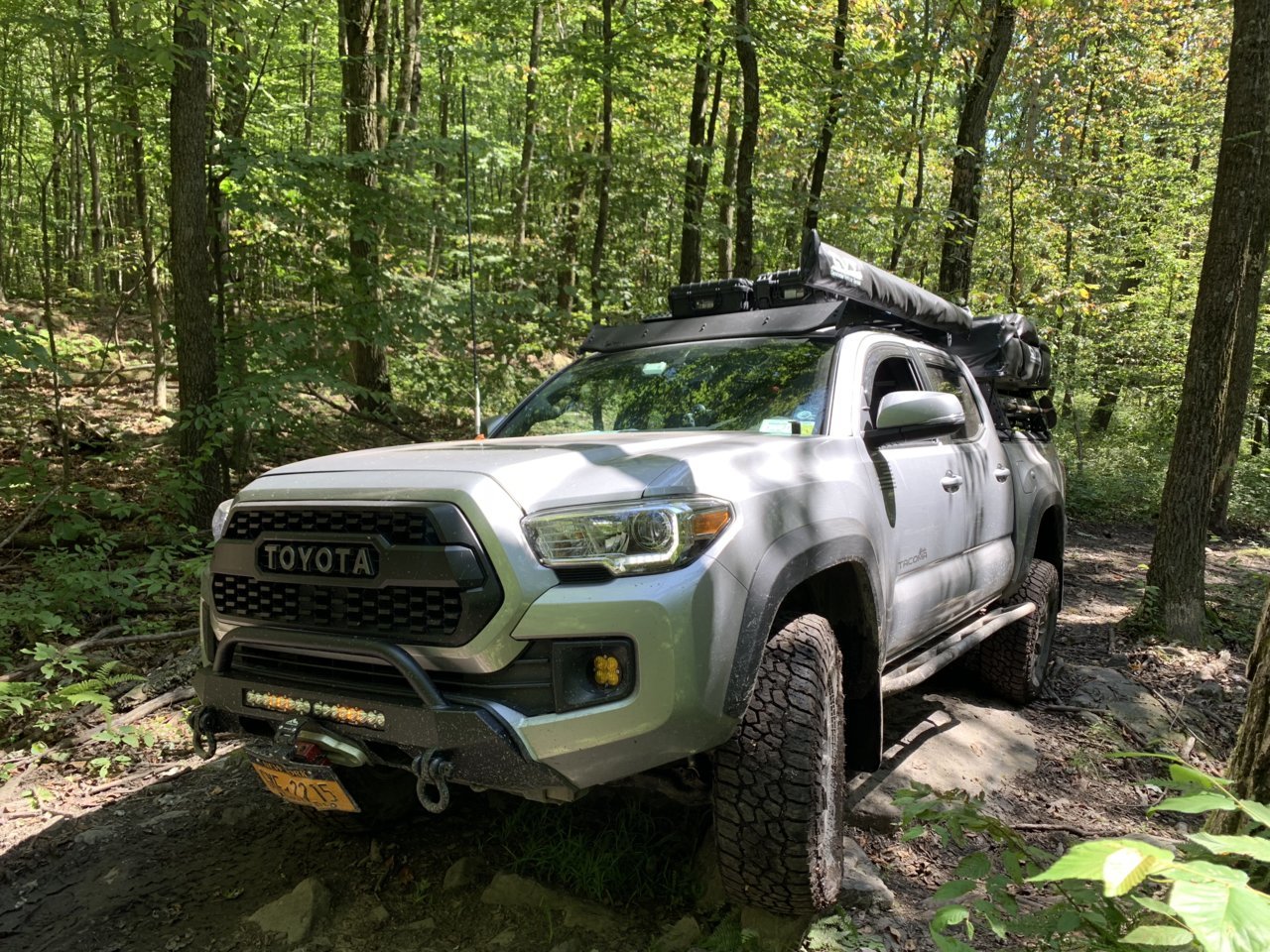

    Here is how my MD Dakars look with just the bed rack and RTT. Apparently this amount of flatness is acceptable for the Dakars, but certainly doesn't look great to me.
    Profile shot of the truck with the rack and tent, but no other weight.
