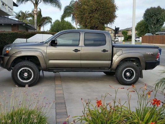

    First pic was after install and driving, but before the alignment. I have a 3/8" spacer so it's pretty much dead level from side to side.
    I was just kind of basing my surprise on most people saying #3 netted about 2" of lift on most rigs, whereas mine has netted closer to 1.5" after some road/trail time. Maybe it was because they were installing the 6112's on trucks that already had worn-out or saggy suspension. I added mine at <15,000miles so my OEM Bilsteins were barely even broken in yet. I'm not complaining, but just surprised. Like I said, I'll probably bump them up to #4 when I decide to do the 1.5" AAL to the rear, otherwise I'll be back at factory rake.
    In all honesty, it looks like Bilstein's chart is more accurate than it originally appeared:

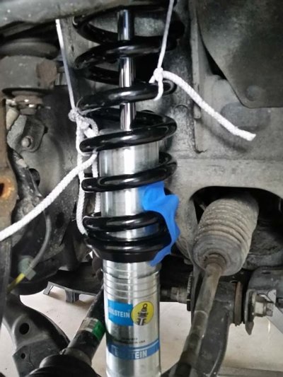

    @HB Taco did that with his:

    That looks sketchy as fuck. Don't think I would use rope to reset mine. :laugh:
    Was thinking rented spring compressor.

    ^ No not really. The rope is not holding the compression of the spring. No way it would hold. Its just holding the weight of the spring. But yea using the spring compressors (if you can do that) maybe you wouldn't have to go through all the steps of lowering the LCA. Give it a go and post. It would be nice if you could do that.

    Hmmm yea in theory you just need to get some "HD" clamps or compressors on the spring while the vehicle is sitting on the ground. Then when you raise the vehicle the spring stays compressed thereby exposing the clip as long as the spring is held up! Let us know how that goes :rolleyes: That would be scary working under the spring though :eek:
