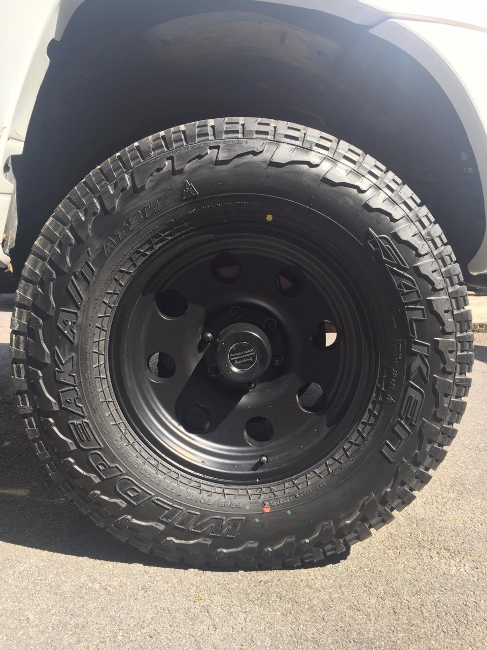

    6112s at top setting TC UCAs 285/70 17s no issues :fingerscrossed:
    51A3B6D7-5201-483E-AA1F-5F60CFD541CF.jpg 0E5539E7-8703-4617-B5AE-DB905EB13CCA.jpg

    Which wheels are those??
    lynyrd3[QUOTED] likes this.
