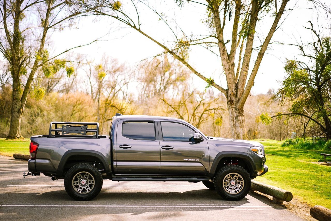

    Just reading through. Thought I'd share my results. I am driving in the 3/4 notch with no rear lift, 5160s and stock leaf pack. The front sits about 1/8 inch higher than the rear. To the eye, it's pretty level. I can only imagine that if you added an AAL, you will have to jump it up to the 4/5 or 5/6 settings to get your truck leveled. Here's a picture of my truck. I forget the exact measurements, but I gained about 1 inch in the front and the truck looks leveled with no weight.
    I do tow an aluminum bass boat and the front gets nose high when I do. I plan to either lift the rear soon or get some Sumos.

    Wonder if it would be safe to say that, setting the fronts to the 4/5 notches and adding a medium Dakar with the larger overload spring removed, the truck would sit relatively level without a loaded bed.

    It won’t be level, you’ll have rake. I have the dakar mediums with a hard shell topper (long bed) and have the 6/5 clips up front. With this I have 1” rake.

    You don't happen to have any measurements do u? How much rake do you have with this setup? Was there any weight other than the bed rack when you took this photo?
