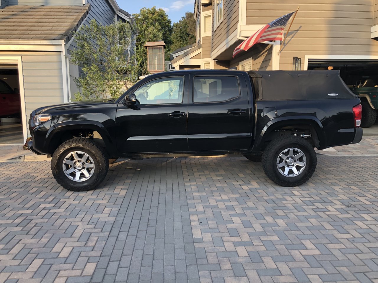

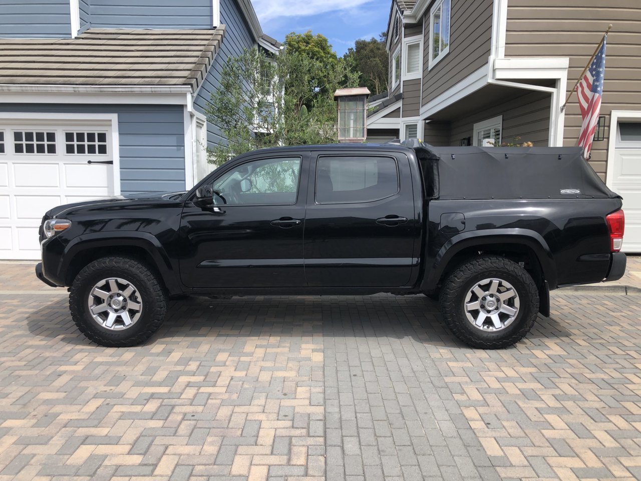

    So I read through this entire thread before purchasing, a ton of good information in here so thanks to all who posted about their set up! Having said that I decided against an aftermarket UCA and ECGS. I’ve only driven about 10 miles on this set up and so far it’s a dream. So glad I went the 6112/5160 route.
    Unfortunately I don’t have measurements but I went the 6/5 route for the max 2 inches of lift up front. And for the rear I chose the Toytec (Deaver) 3 leaf AAL WITH overload. The only time I ever wheel this thing is when it’s fully loaded with camping gear/coolers/etc so it seemed like a better choice

    Looking at the level of your truck I’m glad I ordered mine set at perch 5 as well. I’m hoping for just a slight rake like yours.
    Looks great!

    Thank you! I dig the rake as well, hoping for everything to settle a bit, I feel like my 285s look small now haha

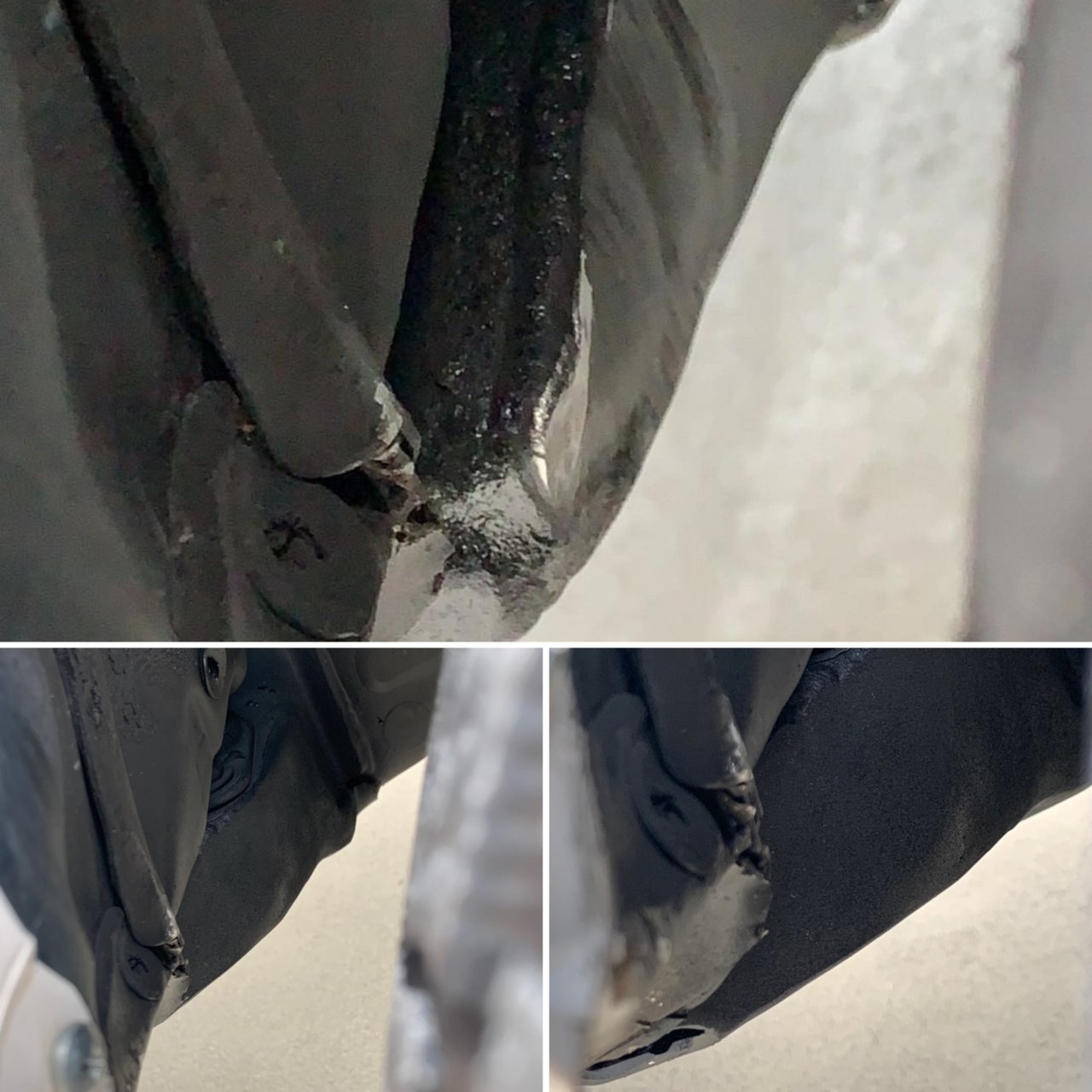

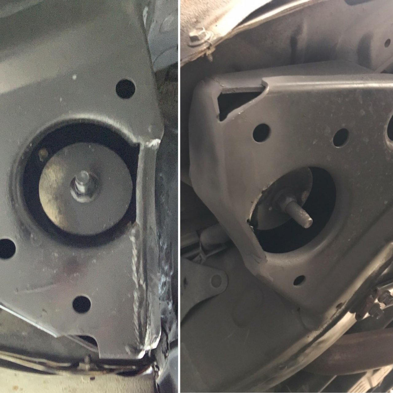

    FYI 2” lift 2.9 caster, 1.25 wheel spacers, 285/75/17 with -10os wheels, aggressive cmc and pinch weld. I slightly rub in reverse in my driveway and didn’t even notice. Some paint was gone on the mount. New alignment of 3.2+ should fix.

    I definitely need a CMC but the rub isn’t that bad for normal driving with me. I do not rub full lock either forward or reverse but if I’m turning into a driveway around near full lock (75%-80%) ((not even sure how to describe that honestly)) I will rub. Off road is manageable at slow speeds but if I’m going too fast around a corner while the wheels are articulating it’ll rub. For me though it’s really not that bad and I just drive accordingly. Hope this helps

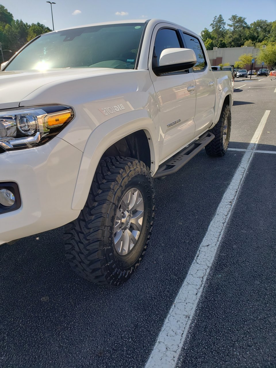

    6112 front 5100 rear Toyo MT 285/75/16 Tyger running board
    20190921_105519.jpg 2018 SR5 with 6112 ( 5th setting) on front with 5100 in the rear. Front height ground to fender 38.5. Rear 37.5
    I'm gonna add an OME AAL to get it closer.
    285/75/16 Toyo M/T will touch the BM at full lock with turning momentum. BMC coming soon also.

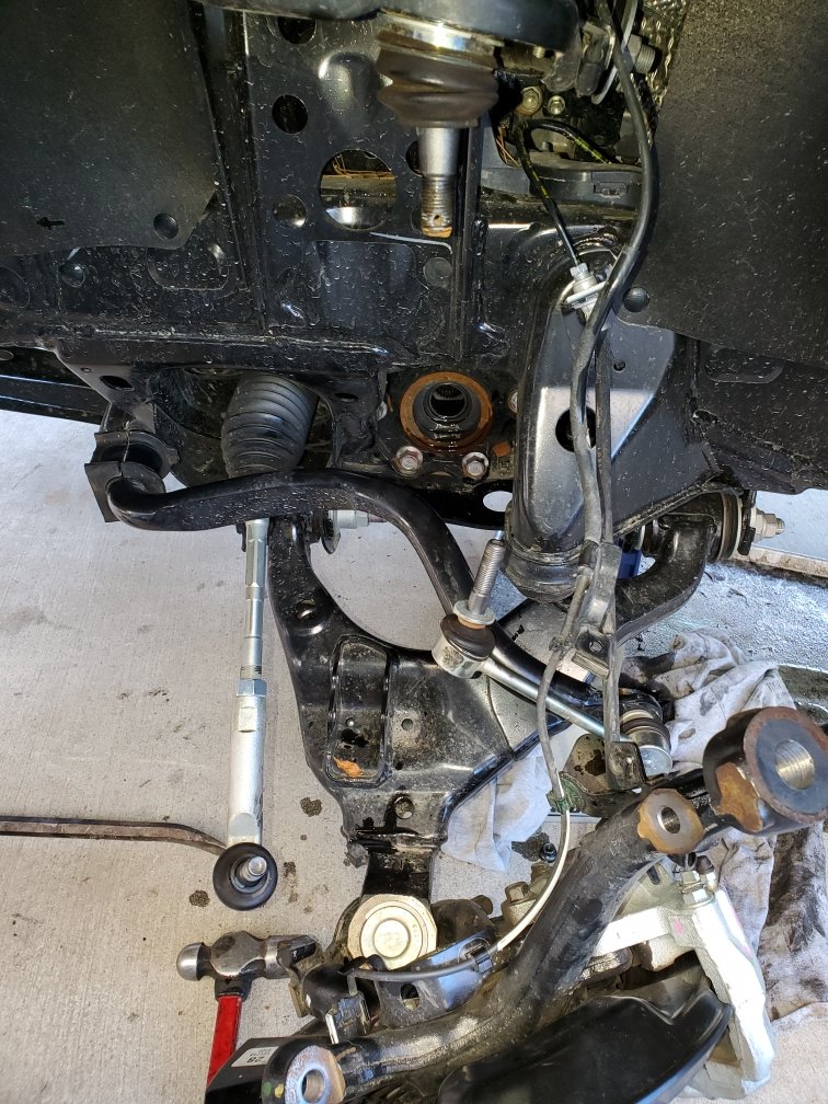

    Getting closer to being done here
    Superdave1.0, cubie and crashngiggles like this.
  19. Oct 4, 2019 at 2:16 PM
    #2679
    acupunk
    acupunk Well-Known Member
    Sep 1, 2019
    #303960
    142
    '19 4x4 TRD OR DCSB
    Wow, can you elaborate on how noticeable the vibe is? I get a slight drone 30 mph, thought it was wind a few times but more and more thinking not, and on accelerating I can often feel the slightest of vibes in the gas pedal (not the steering wheel though) that I thought was a bit unusual.
    Might take it in to have looked at before lifting- all I've done to it so far are 265/75's on SCS Stealth 6's (-25mm offset). Or maybe I'm just paranoid...
  20. Oct 4, 2019 at 7:50 PM
    #2680
    omegaman2
    omegaman2 Unknown Member
    Sep 25, 2016
    #198242
    666
    805
    2015 4WD DCSB
    Well I know I did not have the needle bearing vibe before installing the 6112’s, so my first spin after the install I was listening for it...it’s definitely noticeable but subtle. It a pulsing vibration that you hear and feel and is there every time while driving. Next time you hear it shift to 4hi, if it’s the needle bearing it will disappear.
