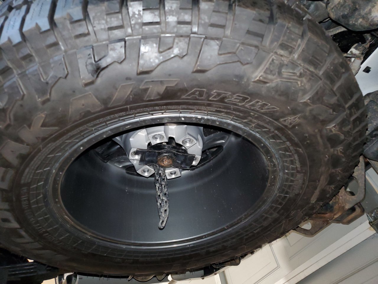

    Beautiful truck! You can fit the spare under the truck with some minor modifications. I have a 285/70/17 under mine.

    The 295/70/17 is 33.4” in diameter and the distance between the drivers side leaf spring hanger and the exhaust bracket is 32.8” wide. I guess I will do more research and maybe figure out a solution.
