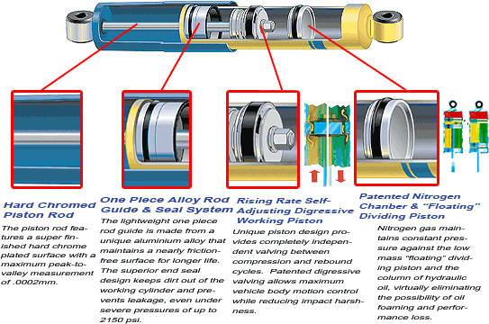

  11. Dec 12, 2016 at 9:00 AM
    #271
    DaVikes
    DaVikes Well-Known Member
    Feb 26, 2013
    #98580
    344
    Ross
    Denver
    Colorado Sports Car
    Arb front bumper, warn winch, All Pro rear bumper, OME up front, OME and All Pro Standard in Back, ARB locker, 34 x 10.5 KO2's, 17" Level 8 Trackers, and fancy single piece driveshaft.
    I've been wondering if there was any difference between the 5100's and the 6112 shock other than diameter. People say that the 6112 rides better, but it's hard to find someone that has actually had both. Someone in another forum somewhere had posted up that the compression and rebound forces for each shock are the same per Bilstein. That made me wonder how much "better" the ride could be with the 6112.
    So I did a bunch of googling, and I think there are other mechanical differences between the two. I found this diagram of a 5100 on a jeep website. The page called the shock part of the 5100 series, although it has a shield for the rod which is out in the open on a Tacoma.
    A vendor on Ihatemud posted up some pictures of the internals of the Toyota TRD Pro shock, which is either a 6112 or an 8112. https://forum.ih8mud.com/threads/trd-pro-bilstein-shocks.823503/page-2
    I also found this video that shows the insides of the 8112. (I thought it was a 6112, until someone gently pointed out that I had it wrong.) It has extra pistons that seem to add a second stage to compression and rebound. The video is pretty new (11/16), but it's not on Bilstein's website.
    So if the 6112 is built like the 8112, there is a substantial difference. Otherwise, it's just a bigger 5100. I wish Bilstein would just put this info on their website.

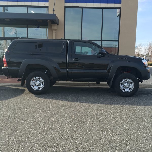

    I installed my 6112's Sunday. Had 1/2 and 3/8 top plate spacers installed with third notch. Front end was jacked. Removed top plate spacers and measured 22 1/2 drivers and 23 passenger side from fender today after some settling. Just a little front end high with my Alcan 2" springs. Hope to settle some more if not maybe add 1" block to rear. Going to get an alignment tomorrow with stock tires and wheels. In the spring I will make height adjustments when I mount tires to my F5's. I'll get some pics up.
  17. Dec 14, 2016 at 6:51 AM
    #277
    Kick
    Kick Well-Known Member
    Mar 7, 2016
    #180467
    102
    2013 base cab 4x4
    Jba uca's, bilstein's 6112 and 5125 Alcan 2" rear springs, wheeler's super bumpstops. Michelins defenders 265/75/16

  19. Dec 15, 2016 at 12:05 PM
    #279
    Fulton246
    Fulton246 Well-Known Member
    Feb 20, 2016
    #178841
    1,232
    NC
    2019 TRD Sport 4x4 DCLB
    ^ the stance looks good. Time for some new wheels and tires!

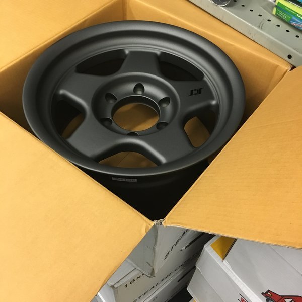

  20. Dec 16, 2016 at 12:23 PM
    #280
    Kick
    Mar 7, 2016
    #180467
    102
    2013 base cab 4x4
    You must mean these. My plan is to wait till spring but these wheels keep telling me to mount them.
