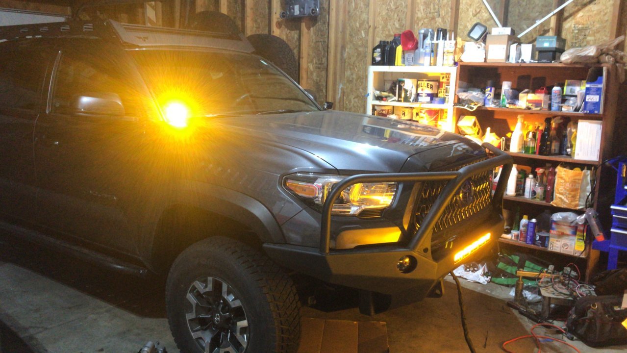

    Just as an FYI and to add my experience to the thread that has helped me so much.
    I gained approx 1 3/8 - 1 1/2 inches with my swap (although it probably hasn’t fully settled yet), using 650 lb coils on the 4/3 setting.
    That’s with full cbi aluminum bumper, 55lb smittybilt winch, ifs and mid aluminum skids and beefy steel sliders.
    It rides perfectly for what I was looking for - less dive on braking and minimal lean in corners compared with the stock OR suspension. Still very comfortable on road - I haven’t taken it off road yet.
    I did install icon sway bar spacers (and kept my sway bar attached obviously) although didn’t notice any rubbing prior to doing so. They may be optional or only needed with more articulation than I’ve put it through so far.
    Hope that helps those in a similar situation.
