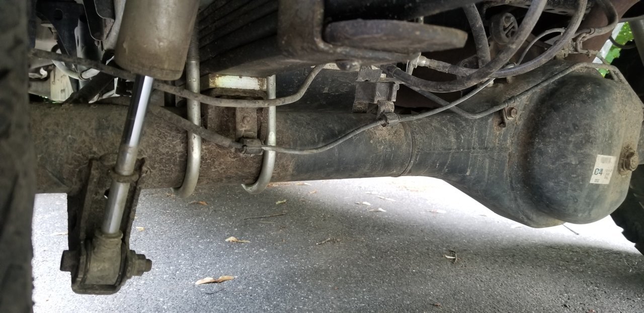

    @iK0NiK here is a quick pick of it installed on my rear drivers side leaf.

    Awesome, thanks. I'm not running a U bolt flip, but I've done 2 AAL's and Dakars on this truck so installing a shim should be a breeze. Didn't get a chance to measure last night but I will tonight.

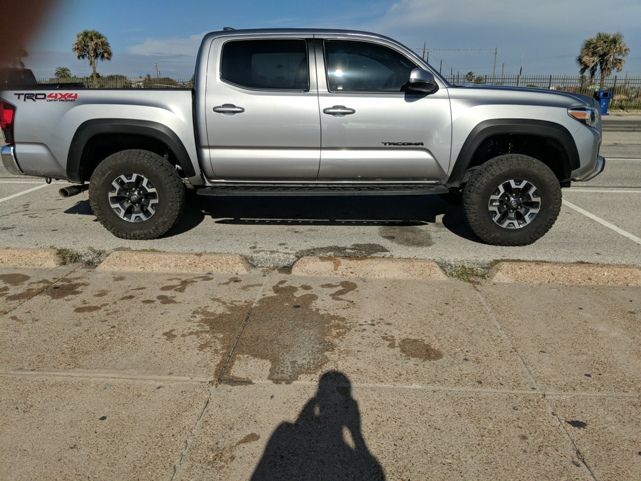

    6112 front 5160 rear. 3rd gen version of the shocks. No add a leaf yet. Fronts on 5/6 notch. got2" out of it (forgot to measure sorry). Has a little bro lean but not too bad. Rides like a dream! Will be doing an add a leaf in the next week or two to fix the bro lean and lift the rear.

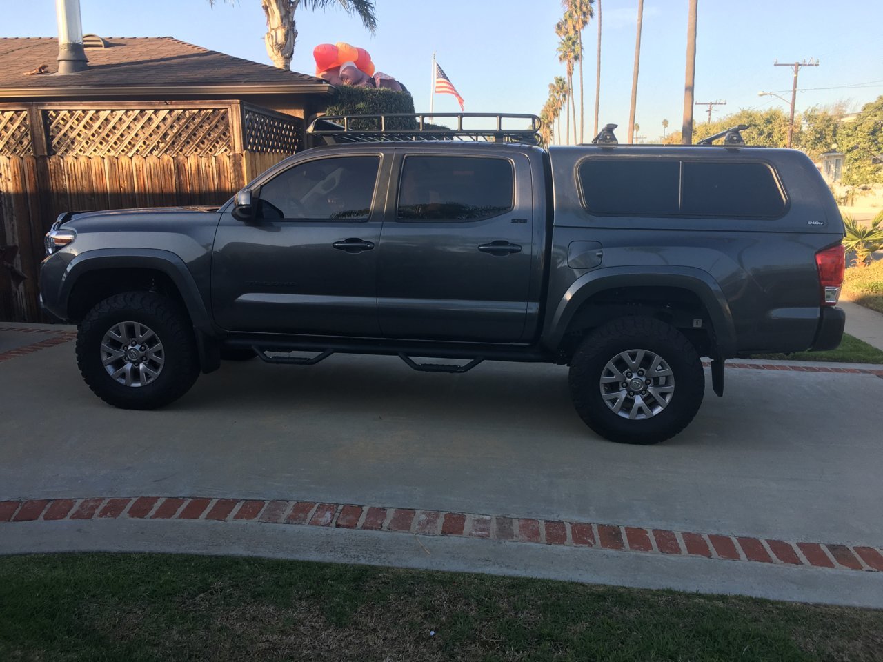

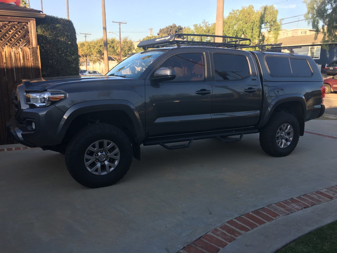

    Shout out to @Bot_Chu@HeadStrong Off-Road for the install and parts!!! Amazing customer service, professional, detail oriented, good prices, speedy service. First Tacoma and first lift, had me super anxious about the whole thing. Just picked up the rig and very very happy!! About the get the alignment andalready runs better than stock!!!
    6112 set at 6/5
    5100 extended w/OME HD leak pack
