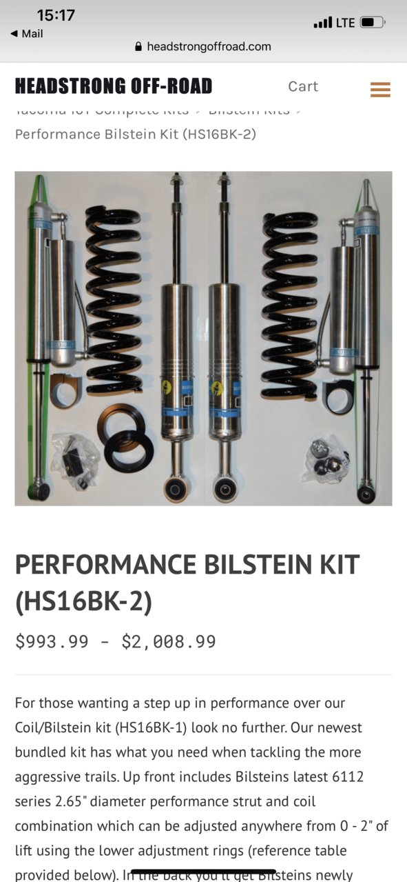

    Interested in getting Bilstein 6112 Strut and Coil Combination and Bilstein 5160 Remote Reservoir Rear Shocks but not sure what notch setting for the strut assembly, if I do or do not need UCA's and or AAL for them. Looking to run 285/70/R17 Toyo Open Country AT II's and have my truck level. Any and all experience in this would be greatly appreciated. TIA!!

    If you want to run the 285's, may I suggest an AAL in the rear, notch 5 on the 6112's, and JBA uca's. This should level you nicely, but with the 285's you may need a CMC. Not too sure with the 3rd gens.

    CMC? I was looking at HS for the complete kit. (Pic below) it has options for single and 3 AAL options. I’m just kinda stuck because I’m not too savvy considering I’ve never done a lift before.

    This would be perfect for the truck. It has the 1/4" spacer for the drivers side top hat 6112, and headstrong can assemble the 6112's and put them together for you on the notch you need. A CMC is a cab mount chop. When you upgrade to a 33" tire like a 285, it may rub against the frame when turning.
