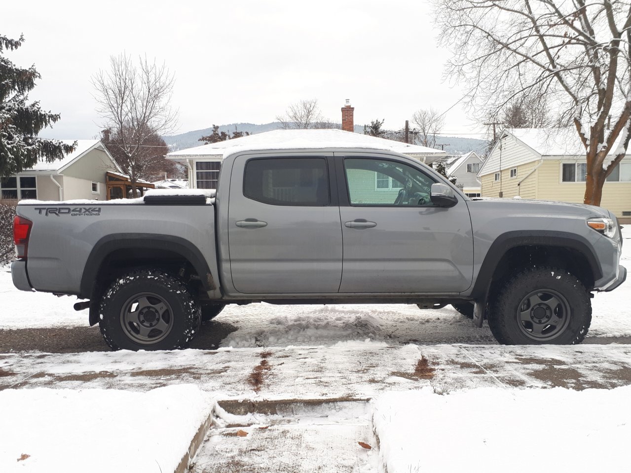

  11. Dec 3, 2019 at 11:18 AM
    #2871
    BRFab
    BRFab Well-Known Member
    Sep 24, 2018
    #267226
    257
    BC
    '19 Alien Grey TRD OR
    Not the blue bird day for 'the gram' level pics, but hopefully it will do for your need

    That looks good.I ran 5/6 up front on stock uca. Installing my aal this week. How did your alignment go?

    Yeah looks real good. I’m gonna put it all together and leave the leafs off and see what it looks like without em and then add em if I feel it needs it. Appreciate the pics!

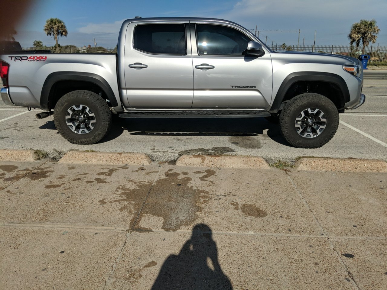

    This how I'm sitting at notch 6/5 without an add a leaf. Tire 265/75r16. Might be hard to tell but it's got some reverse rake. I have the aal just waiting for a day I can install. I figured after I install the leaf I can either remove it or add a 1/4" spacer if I don't like the rake after.
