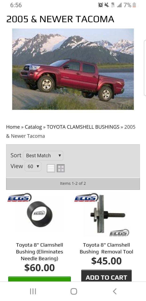

    It’s intermittent. Almost going away. Noticed it the most right after install yesterday.
    so far I love it. Just drove 100 miles on highway and was super smooth.

    Yup.....almost all dclb's don't have that problem due to the longer wheelbase and less aggressive angle.

    Even though it is intermittent, you want to take care of it or your U-joints will wear out quicker and have to replace them on your driveshaft. It can get a lot worse. Better to figure it out now or it can cost you in the future.

    First step is what I stated above. Put it in 4wd hi while at 40mph. If it goes away only need ECGS bushing.
    You don't want the needle bearing breaking apart shooting metal parts into your front diff.

    It's so so faint. So tonight when I was driving I turned off the HVAC and radio and could barely hear/feel it, like someone would say I was crazy for saying there was a vibration. But yes when I engage 4WD it stops. My lift was 1.5" and I'm wondering if when it settles in a bit more maybe it goes away completely? Looks like special tools are needed?

    It might settle. I replaced mine and it solved the vibration I had. ECGS also sells the tool to remove the old bearing.
    https://eastcoastgearsupply.com/

    Thanks its so faint that almost not noticeable. My new tires hum more than the vibration. I can feel it very very slightly though the gas pedal and seems to be a bit worse on left hand curves in the road. I'm looking for a loaner tool and I may just get it done to be safe.

    Since you are waiting for the alignment I would do it now as you have to align after pulling the axle out. There are YouTube videos showing how to replace the bushing. Also I have the removal tool somewhere in the garage. I'll send it to you free if you pay the shipping. That's pending I can find it ha.
