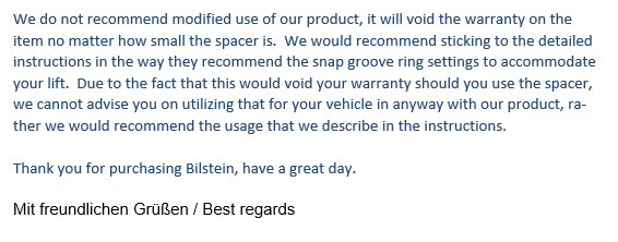

    So I decided to email Bilstein about installing a spacer as well. Here is their response:
    Superdave1.0 likes this.

    $568 is a killer price. That's what I paid for mine 3 years ago AFTER a $45 discount.

    Those are actually the same ones as the E4-FD1-Z562B00. The number that you gave is the purchase number to order through bilstein or a dealer. The E4-FD1-Z562B00 number is the number on the springs itself. They are made for the 6112 or 8112 when you have an extra 80-140 lbs up front.

    I'm not seeing g the data sheet unfortunately
    What does it say for not using the spacer?

    It's just the install sheet / instructions. But those roughly state to correct Taco lean, raise the clip on the driver side 1 clip position higher than the passenger side. So if you want max lift that would be 6/5 position. Less lift 4/3 position etc.

    Thanks - the image wasn't showing.
    Good lord alive, a full position difference? You gots the leans....that's a pretty large difference.

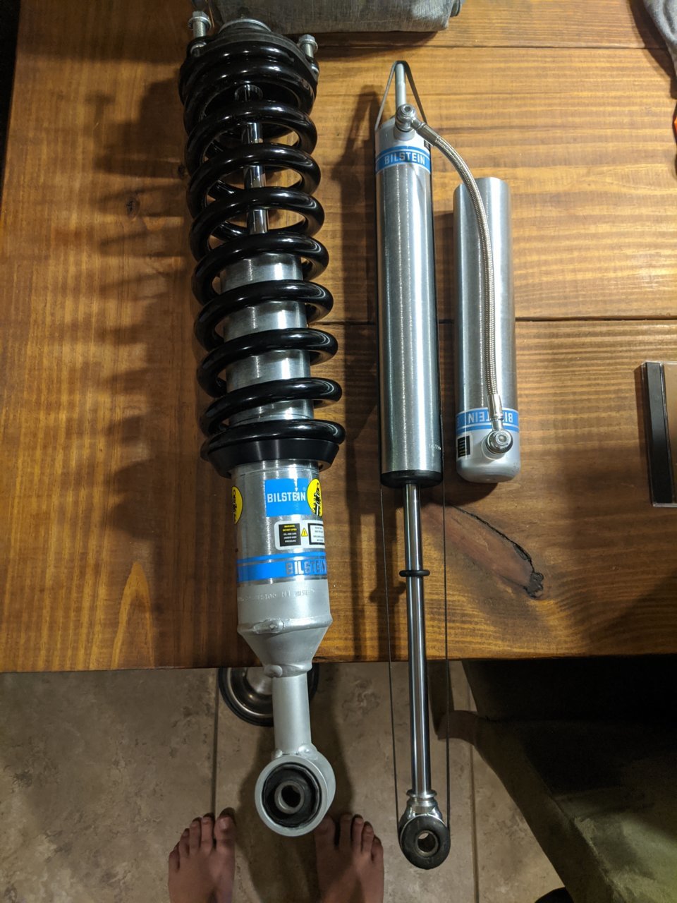

    MVIMG_20191213_170704.jpg My 6112/5160's came in today. Wow, maybe I'm just naive, but the 6112's are MUCH more stout than I thought they'd be. Very pleased.

    Girth baby. They are beefy.
