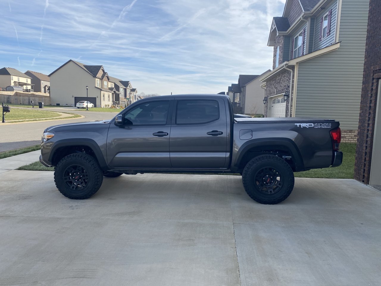

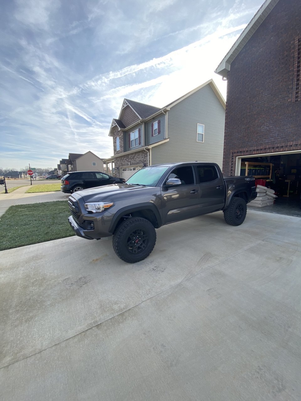

  5. Dec 20, 2019 at 1:49 PM
    #2965
    nate_scarbrough
    nate_scarbrough Well-Known Member
    Feb 5, 2017
    #209739
    71
    Nate
    2017 Mettalic Grey TRD Off-Road
    Let me know what you guys think!
    Bilstein 6112 (both on #4 notch and 1/4 spacer on driver side to adjust lean) and 5160s
    Total Chaos UCAs
    Bumped tire size up to 275/70/17
    primodude, 1cleanFG, cubie and 5 others like this.
  6. Dec 20, 2019 at 1:53 PM
    #2966
    WZ00R2
    WZ00R2 Well-Known Member
    May 18, 2018
    #253814
    980
    TN
    2020 Cement OR
    6112/5160, Deaver U402, 255/80r17, SCS BR6
    What is your rear suspension set up?
  7. Dec 20, 2019 at 1:55 PM
    #2967
    nate_scarbrough
    Feb 5, 2017
    #209739
    71
    Nate
    Bilstein 5160s with 1.5in toytec solid aluminum blocks.
    whatstcp and WZ00R2[QUOTED] like this.

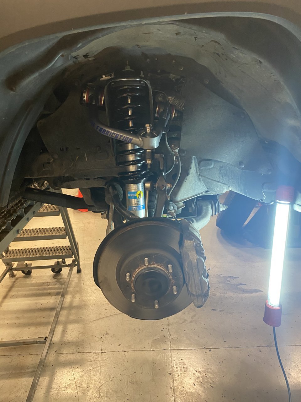

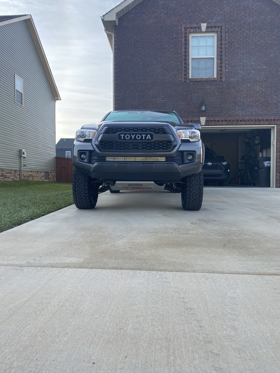

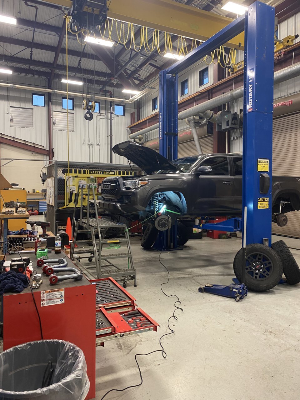

  8. Dec 21, 2019 at 6:37 AM
    #2968
    GreyBaldTaco
    GreyBaldTaco Well-Known Member
    Mar 10, 2019
    #286065
    4,144
    2019 F150 5.0
    I installed my 6112's last night to go with the 5160s in the rear. I'm very happy with how the truck drives and I think this suspension setup has a great value. Can't wait to test it further. Didn't do too terrible on my quick garage alignment just to get me to the shop this morning. MVIMG_20191220_160611.jpgIMG_20191220_170656.jpg IMG_20191221_081325.jpg IMG_20191221_081333.jpg
  9. Dec 21, 2019 at 12:49 PM
    #2969
    Superdave1.0
    Superdave1.0 Grandma Dave
    Dec 27, 2018
    #277158
    6,286
    SoCal
    LX470, 2025 Civic Si
    Awesome brotha. You may or may not need sway bar relocation brackets. $40 and super easy install. My 6112 were contacting the sway bar.
    https://www.4wheelparts.com/p/icon-...-bar-relocation-blocks-611030/_/R-FRDK-611030
  10. Dec 21, 2019 at 2:38 PM
    #2970
    TXpro4X4
    TXpro4X4 Fuck Cancer!
    Oct 29, 2011
    #66093
    29,537
    Bryan
    Costa Mesa, CA
    2011 TOY
    Is this why you went to 8112's?
  11. Dec 21, 2019 at 3:30 PM
    #2971
    oscolivar1
    oscolivar1 Well-Known Member
    Oct 30, 2013
    #115568
    2,267
    Oliver
    VA
    2017 Tacoma Limited
    Bilstein 8112/8100, JBA UCAs, Icon RXT leaf pack, work wheels 17x8.5;-10os, 285/75/17 cooper LTX AT3, Mobtown HC rear bumper and Sliders, SSO front bumper, BAMF greceased grill.
    8100s that replaced the 5160s in the rear yes, the fronts I did just to complete the set. Otherwise I was happy with the 6112/8100 combo.
    Rockefelluh and TXpro4X4[QUOTED] like this.
