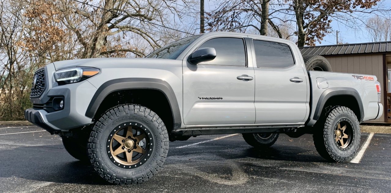

    I finally had time to install everything this past weekend. I set both front 6112s at the 5th level with a spacer on the drivers side. The rear setup is 5160s with Icon progressive AAL.
    I was a bit anxious that the ride would be too stiff with that much preload and an AAL. Now that I've put a few hundred miles on the truck since the install, I love it. I was very surprised at how much less the truck nose dives when on the brakes and how much more planted it is while cornering. I would describe the ride difference as comparing an old clapped out Cadillac to a new BMW as far as factory OR suspension vs my new setup. If anyone is on the fence about getting these, do it, you'll love them.
