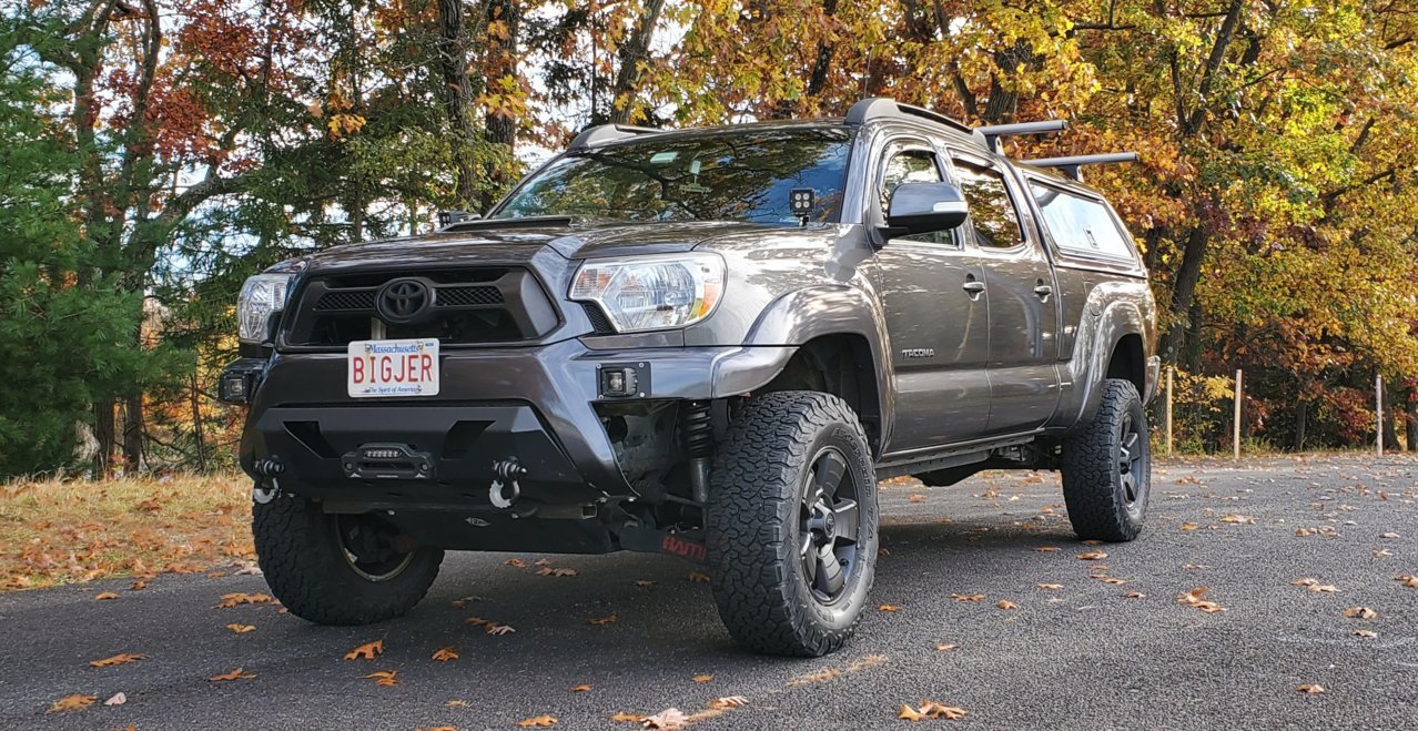

    I had the fourth setting at first with a 600lb spring and a dclb 2nd gen. I had about a 3/4" rake with medium dakars. What are you running in the rear for lift?
  17. Feb 14, 2020 at 7:11 PM
    #3037
    Sixthelement
    Sixthelement Ran over a Yeti once, Texas, never again
    Apr 1, 2017
    #215083
    2,804
    Flagstaff
    24 F150
    Fox 2.0
    C4 Hybrid, Warn 8s, Mobtown steel reinforced trio. 4xInnovations DOM sliders, SOS HC rear for armor.
