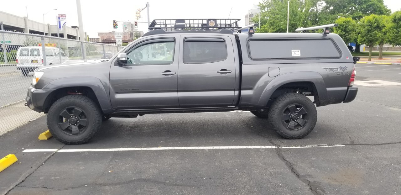

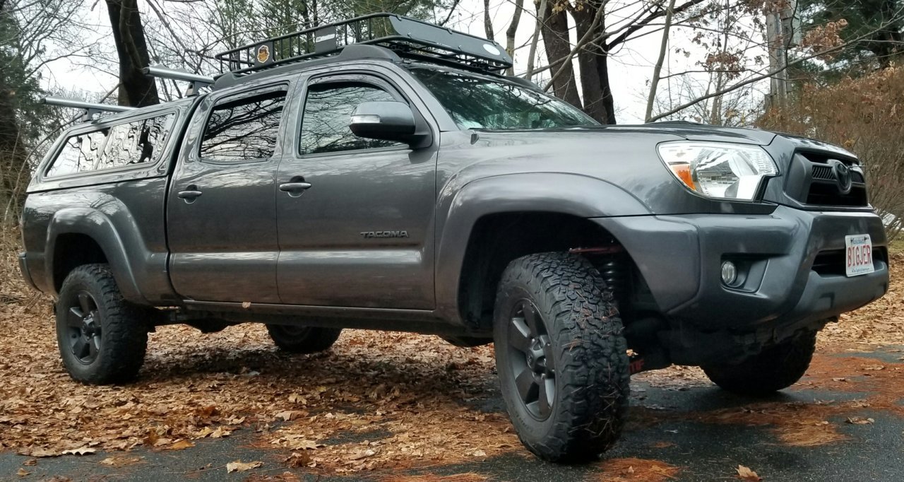

    I have 6112's on the 4th setting with bilstein 650 lb coils in front with 5160's and heavy dakars in the rear. I have about a 2.25 inch in the front with my armor and a 3 in the rear with my cap and some things in the bed but not 600lbs. I do have a dclb if that makes a difference.

    Actually....hold on. That was with my armor. This us before the armor was put on. Just the lift.IMG_20181125_162225.jpg

    Not much. I have taken it off and on at the rear drops 1/4" when I put it on and goes up about 1/4" when I took it off.
