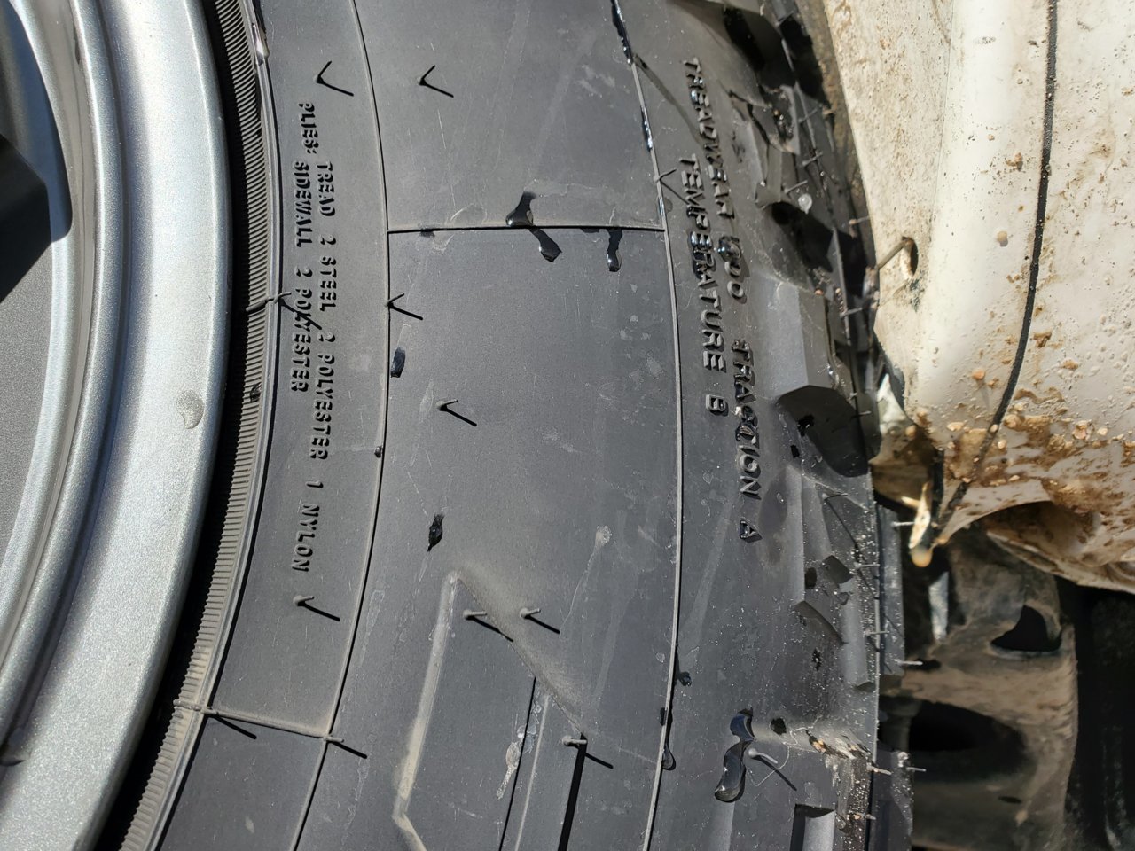

  15. Feb 17, 2020 at 2:22 PM
    #3075
    crashngiggles
    crashngiggles Tacomaworld's Resident Psych Dr.
    May 17, 2015
    #155446
    7,458
    Jared
    Wilbraham, Massachusetts
    2013 MGM TRD 4x4 DCLB Trail Limo
    You have a couple of different options. You can go with some spidertrax wheel spacers to bring your offset out, you can raise it up a notch to give yourself some more lift (if you want to add armor in the future it will bring it back down), you can add in the 650lb springs and keep it at the same notch's (your ride might be a little stiff) or you can get it re-aligned and have them adjust your caster to move your tire forward more.
  16. Feb 17, 2020 at 2:29 PM
    #3076
    arrakis429
    arrakis429 Waiting for the Mets to repeat 1986
    Jun 16, 2012
    #80785
    426
    Ben
    Springfield, OR
    2016 Quicksand TRD Sport ACLB 3.5L 6MT (OVTuned)
    Fuel Mavericks w/ Falken Wildpeak AT3W 285/70/17 (Soon to be SCS Ray 10 w/ Falken Wildpeark AT4W 255/80/17) Leer 100 Topper + Prinsu Cabrack Cali raised Bed stiffeners RCI Sliders RCI skids Bilstein 6112 Front 5/4 w/ Eibach 700lb Coils SPC LR UCA's Bilstein 5160 Rear OME Dakar HD Leafs Wheeler's UBolt Flip w/ Bumpstops N2 Designs MT remote starter OVTuned ARB Awning w/ Windbreak and Deluxe 'Room' SpartanXCustoms Amber Scoop light Pelfreybilt Aluminum Front Plate Bumper w/ CaliRaised 32” light bar and Baja Designs Amber Squadrons Wide Cornering Warn Zeon 10s Platinum Winch 2Lo Mod URD Stage 3 Clutch with Heavy flywheel Accumulator delete mod TacoGarage Dash Multimount Warfab Phantom Rear Bumper OVTune Dump tubes
    Sorry, I may have mis-spoken about the wheels/tires. They poke out. From my research (I bought the truck with them on) they have a -12mm offset. I'm also rubbing the cab mount at full crank on reverse, and the front fender lip at partial turn on the fronts. rubbing all over...

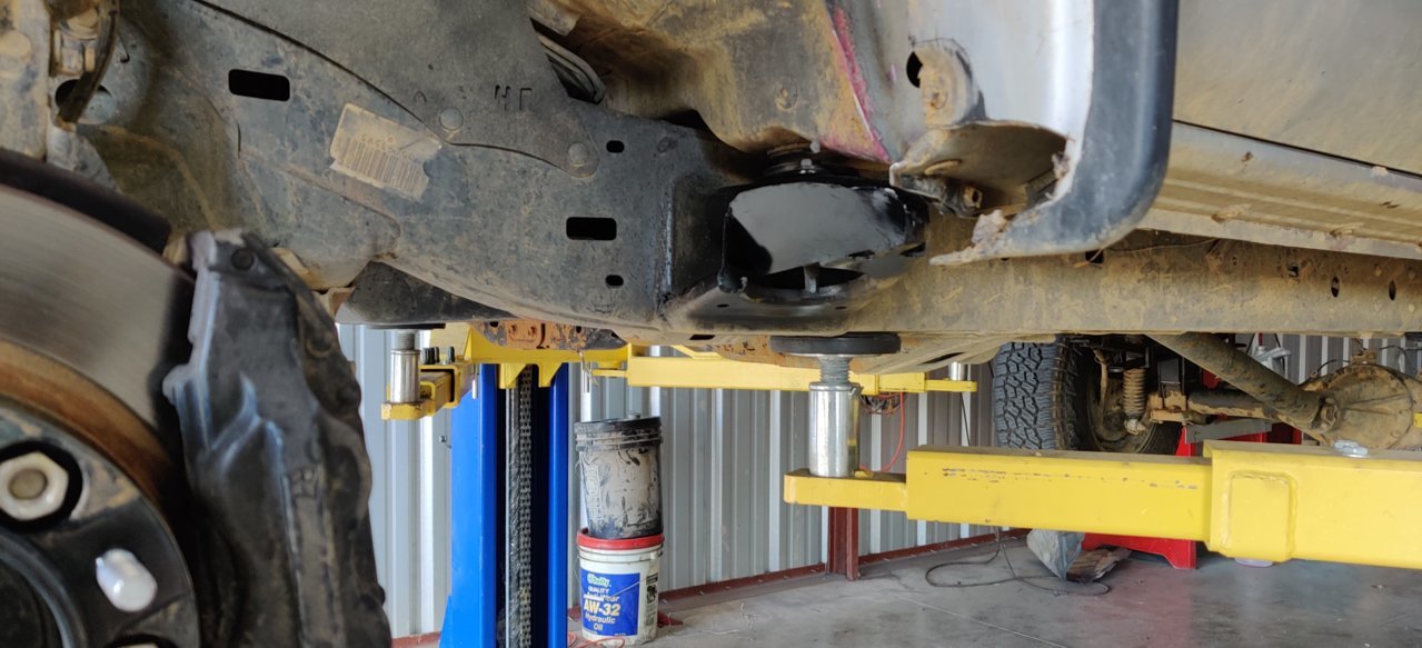

  17. Feb 17, 2020 at 3:04 PM
    #3077
    will.i.was
    will.i.was Well-Known Member
    May 6, 2018
    #252688
    1,705
    Will
    Houston, Texas
    SC 2.5
    Pinch welds and ultra cut cmc. No rubbing at full lock or aired down. Also ensure you bend back the fender mounting holes at the bottom as that stuck out further on my vehicle than any other part. Old pic before the pinch welds but they are stupid flat! Solved all my issues
    Cash13 likes this.
