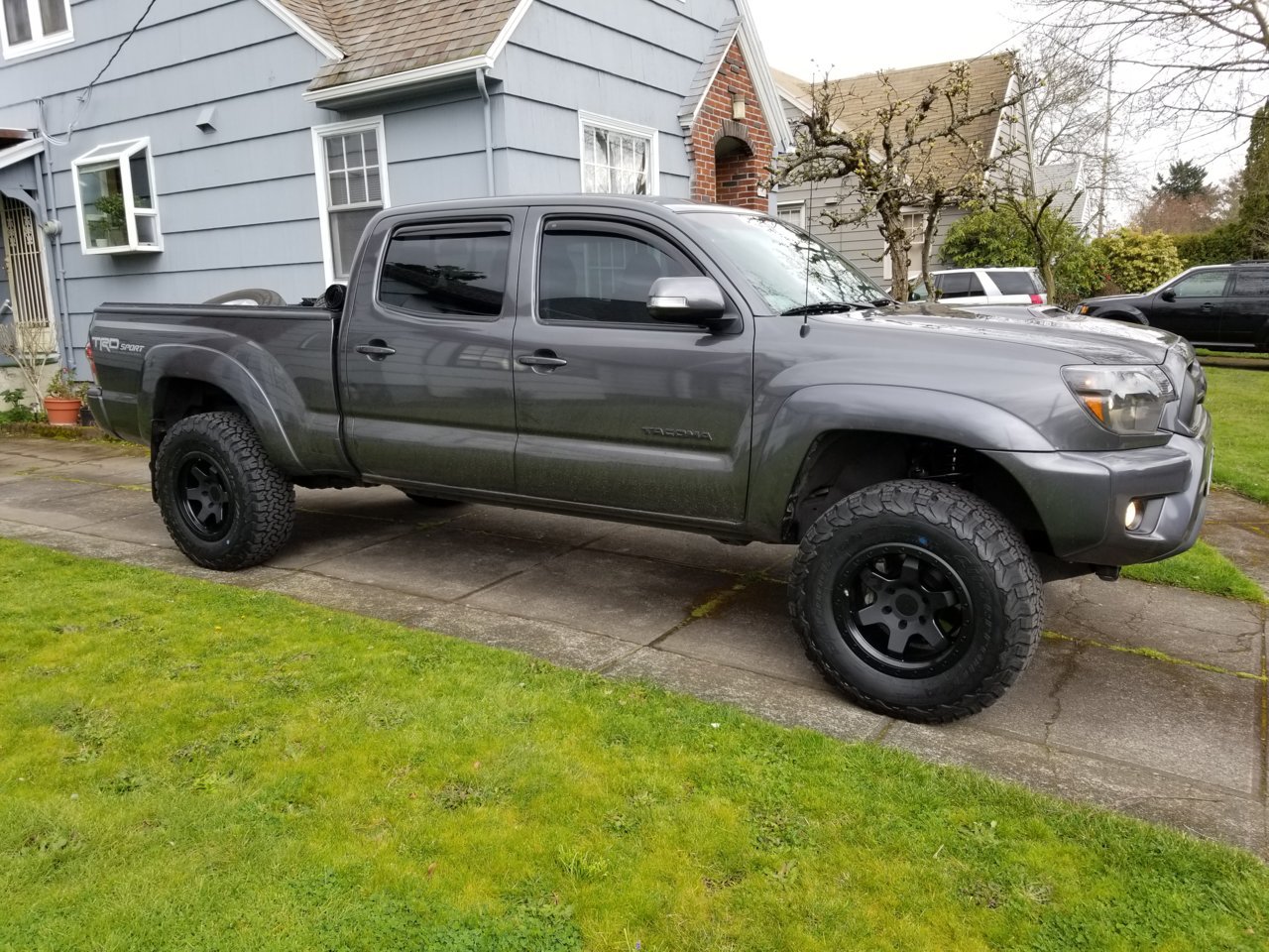

    2015 TRD DCLB
    It depends on what you think is harsh. It was comfortable enough for me, I came from lowered cars. I switched to fox 2.5 up front and the ride is way more plush. I also had to sacrifice ride height.

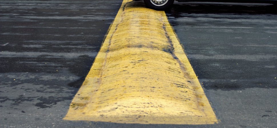

    HERE'S MY QUESTION/CONCERN: It drives great in every scenario except when I hit a speed bump. I have a couple speed bumps to drive over every day, and if I hit them at anything faster than 5mph the front suspension slams hard. It's like the shocks are maxing out. I took it back to 4WP and they said yep, that's exactly what it's doing. I also took it to a do-it-yourself shop this weekend and noticed the front has hardly any droop when it was up on the lift.
    Is it worth having them lower it? It's a couple hours of work and an alignment. Overall I love the result, though I do think it's kinda BS having to remember to slow down to nothing for speedbumps on expensive performance coils...

    When you say speed bump you mean these speed bumps? Any suspension is not going to like going over speed bumps at speed. It's either slow down, or go much faster.
