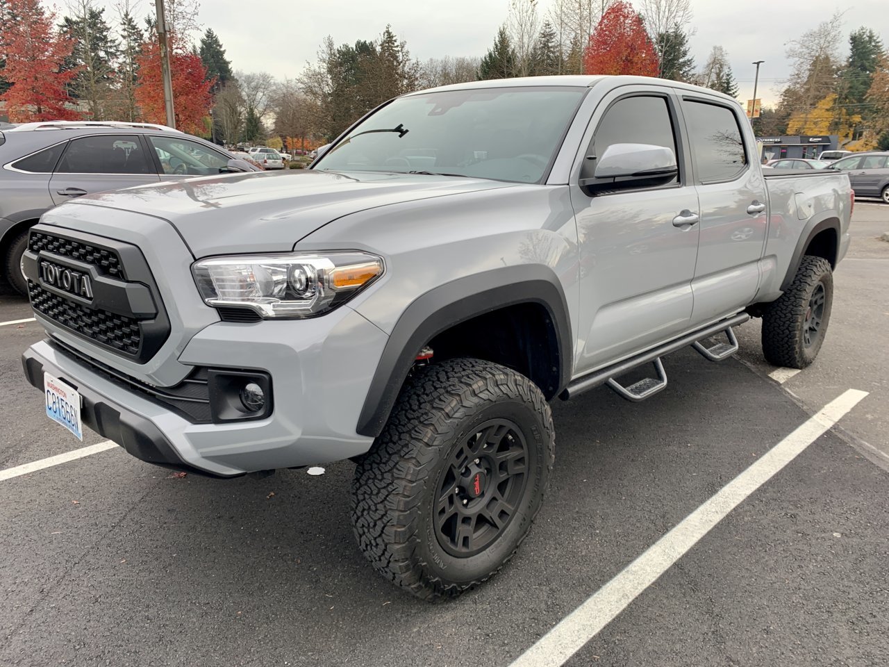

    So, I have my 6112's up front both set at the top notch each side, plus a 1/4'' spacer on the drivers side. This was so I'd be allllmost level with my HD Dakars in the back (tow trailers often, and fill that LB with heavy things). Total lift of about 2.25'' after settling and no bro lean from what I can tell..
    I did do the needle bearing swap when I had everything apart... too much trouble to do later on. Aside from the front/rear suspension overhaul and ECGS bushing swap, I also did do a carrier bearing drop to get my driveline angles back in check. Also added JBA UCAs, and 5160's + extended brake lines in back.

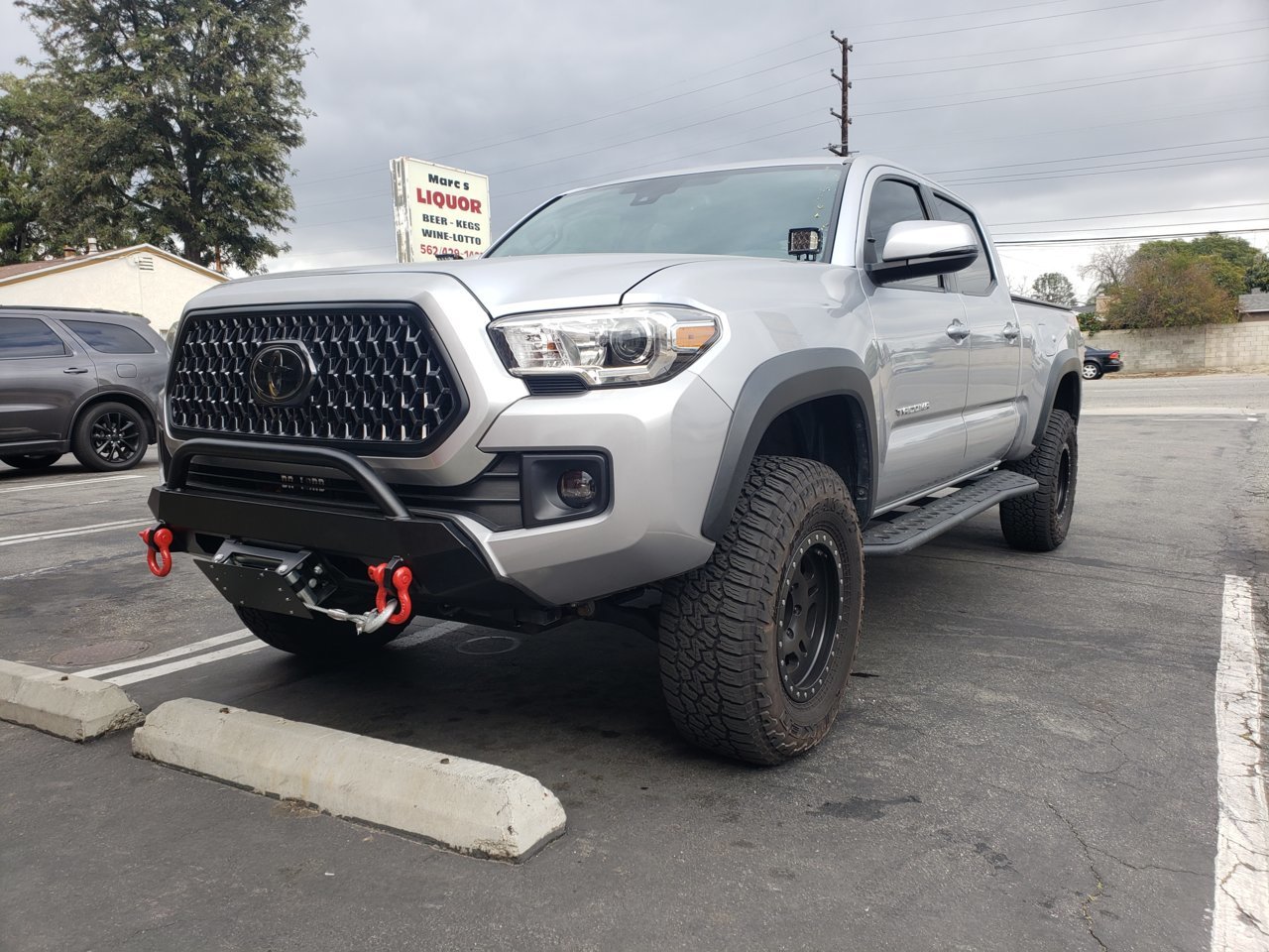

    I went with wider offset wheels to gain track width. Wheel spacers are terrible.

    I completely agree with you that wheel spacers are terrible. I would never run them myself, but I keep seeing pics and I wondered if they were narrower as a result of the lift, and if so how much. Your wheels look good, but I am not interested in buying wheels so I am adding yet another consideration to this expensive possibility of suspension modification.

    Also, what bumper are you running? That thing looks good!

    SSO @SouthernStyleOffRoad
