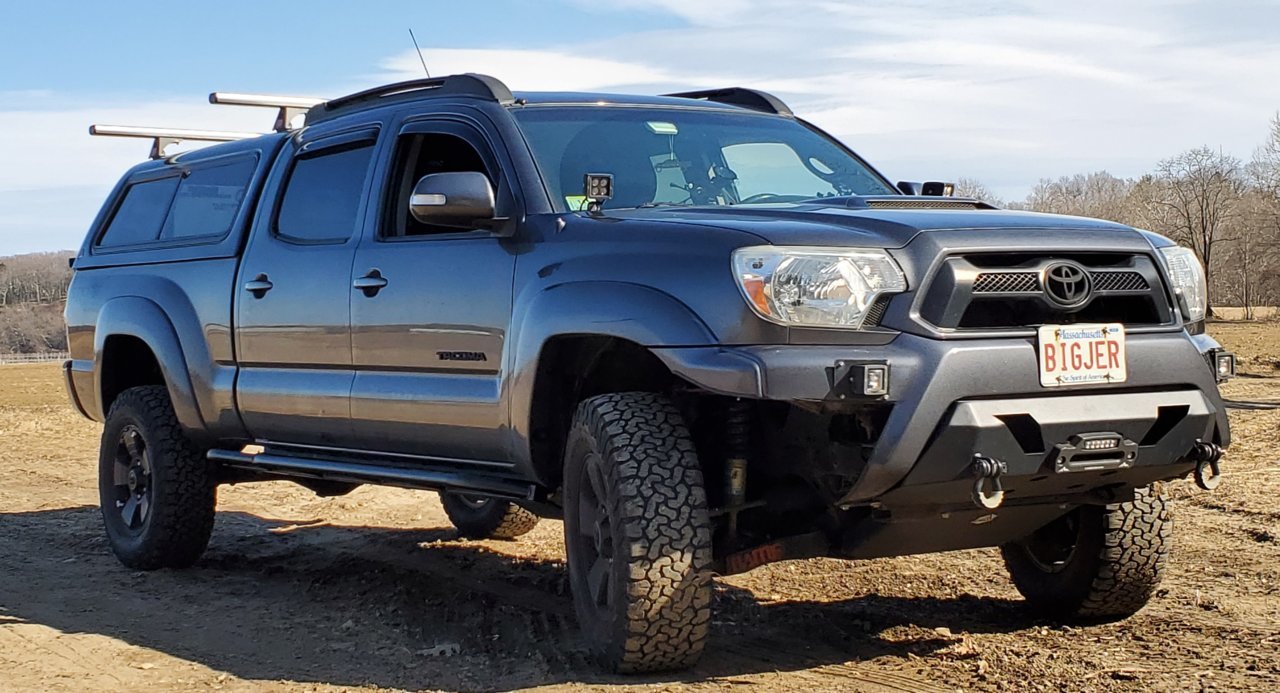

    I have almost the exact same truck. 2013 dclb, sos skid trio, sos sliders, camper shell, wilco tire carrier, but with a sos front bumper. I also plan for a rear bumper. I have the 6112's with the bilstein 650lb springs for the 2nd gen on the fourth setting with the heavy dakar leaf pack and 5160's. I dont have a decked, but I always have about 300-400 lbs of stuff in the bed at all times. This is how my truck stands on 265/70 17's.
    For a 2 inch lift on the front, I if were you, I would go with the 2nd gen 6112's with 650lb bilstein springs on the 3rd notch. When you get the front bumper, maybe move up to the 4th notch.20200317_090154.jpg

    Thanks :thumbsup:. It's nice to see a pic of pretty much the same setup.

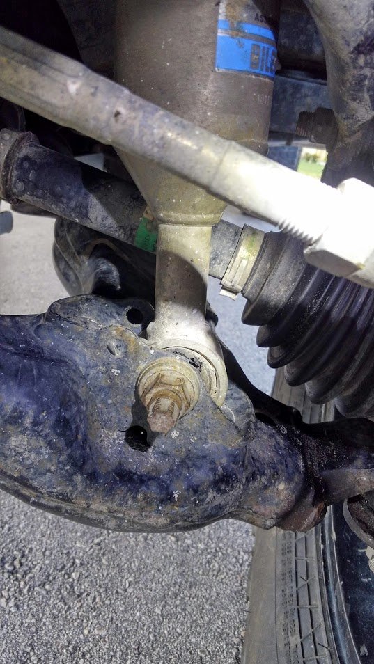

    Has anyone found replacements for the lower shock mount eyelet? Mine are shot. Cant seem to find a replacement.
