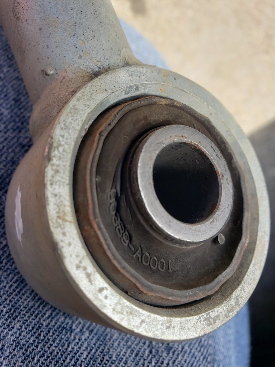

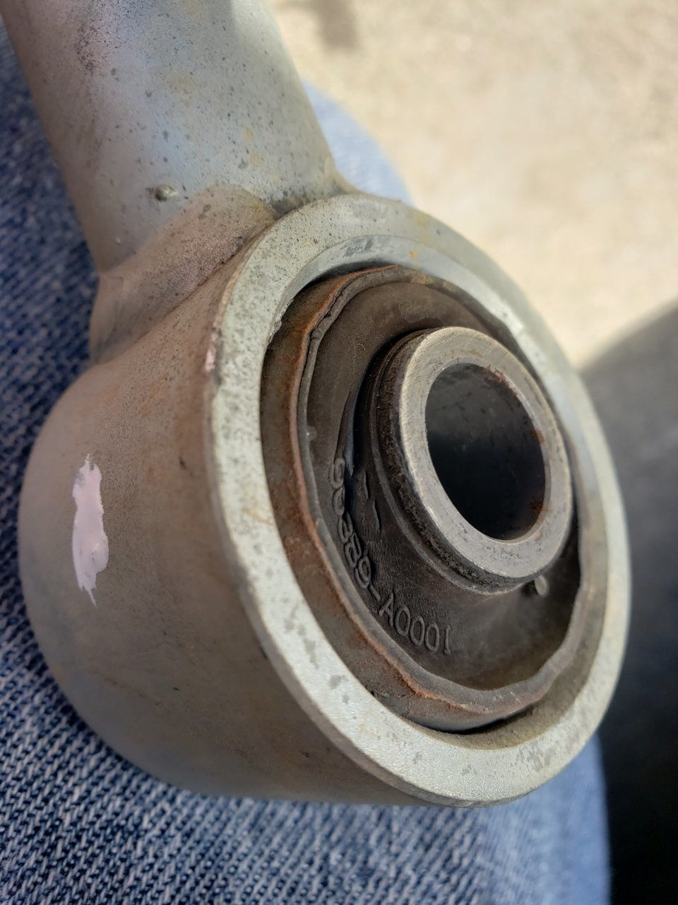

    I might. Didn't want to make this public, but mine look like they are on the way out. Have only had 6112s for 1 year. 10k miles. I drive 95% pavement. Best shocks I've ever had though.

    That's weird. I have had mine on for 30000 miles without any issues. What setting and spring did you have on there? What type of front weight do you have? Could the bolts have been over torqued?

    I torque to spec with my Snap on torque wrench. I also wait to torque them down once the tires are on and vehicle lowered down. The springs they came with and set at 6/5.

    Does the front end make a click or clink sound when you hit a dip hard? Mine does, wondering if thats whats causing it? I can see mines a bit crushed but maybe not that bad, but mine have been on for 4 years and 40k mi. Have you done some hard offroading? I've punished them a few times over the last few years. Have to go all the way back to page 5 on this thread when I did mine. Replaced 5100's with the same clink sound and the shocks fixed it???? The noise has been back for a year or so just ignore it now but would love to know what it is. I've checked and rechecked the LCA bushings, removed the sway bar and put it back, Torqued everything to spec and a bit beyond. :confused: Just dont really want to F*^k with it anymore. Too many other things to deal with.

    Quoting myself. I entered the part number you see on my 6112 lower bushing.
    90389-A0001. It is an OEM Toyota lower strut bushing. That's the replacement.

    Thats what it is? I couldnt read it completely myself. If that is so, I'll see about ordering a set.
