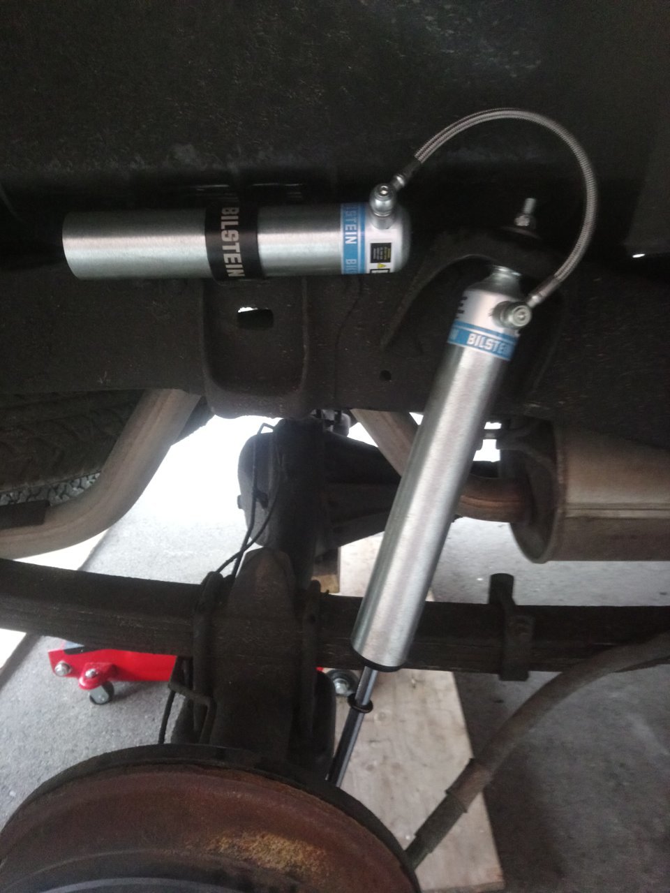

    Did anyone install their 5160 RRs like this? I was wondering why bilstein specifically wants a 115mm gap between the mounting bracket and the hose fitting on the resevoir.

  16. Apr 13, 2020 at 4:01 PM

    I’m curious about this as well. I’ll be installing 5160’s soon and would like to mount them the way you have yours

    I am just throwing out a huge guess here.....but I'm wondering if it has anything to do with heat and fluid expansion due to the movement of the oil back and forth. Running them hard might expand the housing minutely and you maybe don't want the bracket near the expansion?.....just spitballing....:notsure:

    It's probably just to hold the reservoir in the middle, for balance and grip.

    If you have it to close and dont route the hose correctly I'm sure there's been a few that have kinked the hose. Plus, its bilstein, engineers, have a reason.
