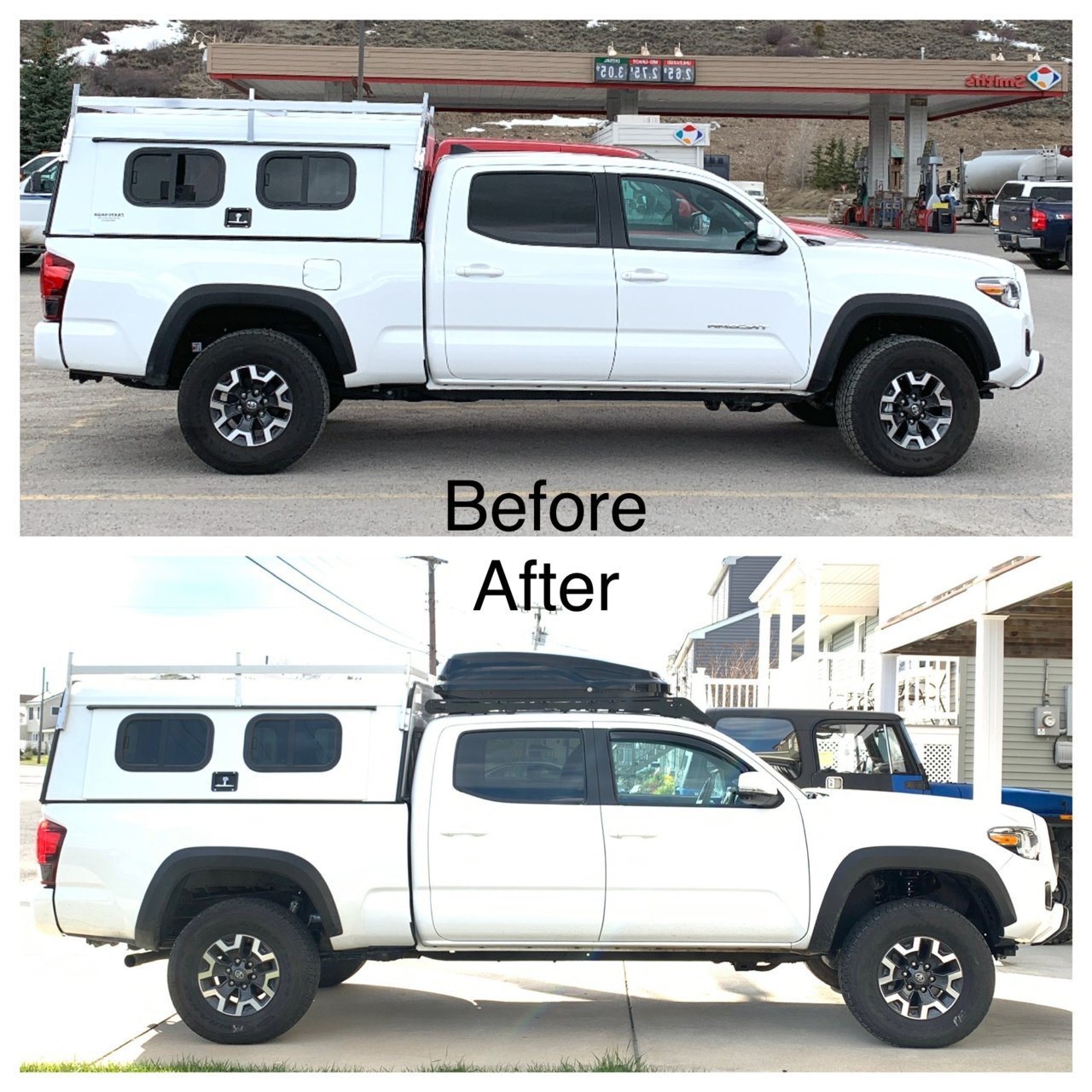

    Just adding to the pile on this thread after just installing:
    6112 front (6/5 clip setting) and 5160 rears with Icon AAL 1.5 kit (left overload leaf out per Icon recc.)
    Added the Front Diff drop kit and the OME carrier bearing drop kit
    After driving all settled into within 1/4" or so of each other on height (shell installed so that likely drops the rear down a little) but at moment it's just about completely level.
    During first test drive, I have the talked about vibration and just ordered the ECGS bushing/needle replacement to hopefully remedy this issue. Otherwise the ride feels decent and it soaks up large bumps better than the stock OR Billsteins for sure.

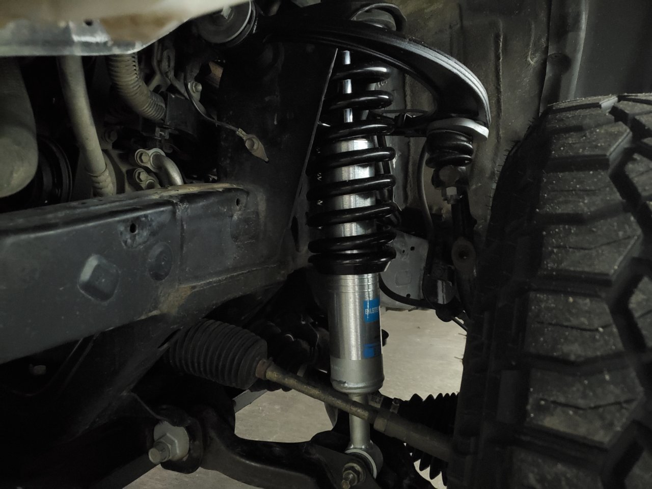

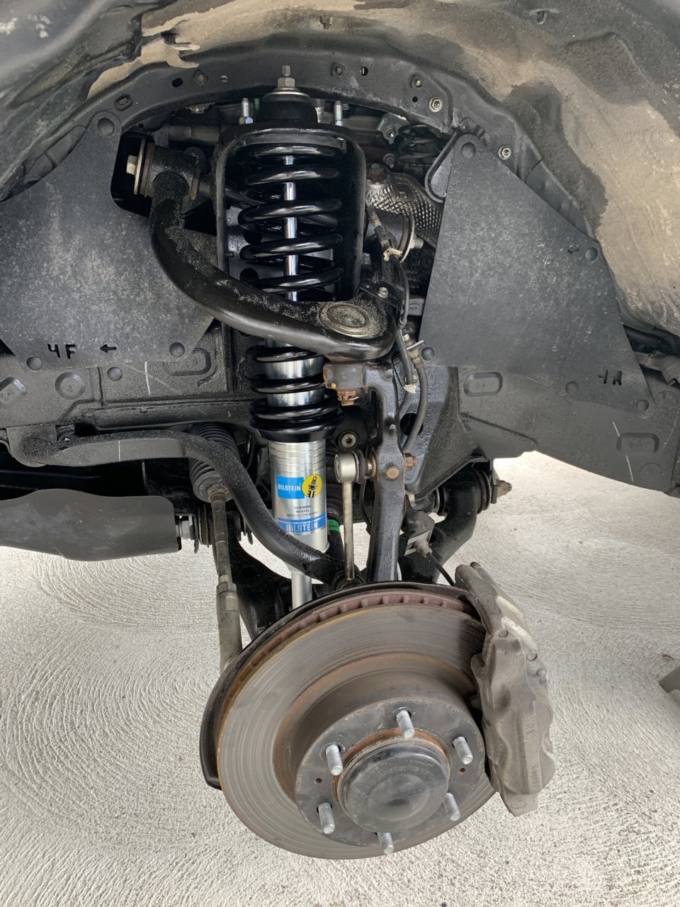

    Got the 6112s installed with new SPCs uppers and front super bumps. Ended up going with the bilstein B110 for the rear for some extra down travel instead of the 5160s. So far I am happy with the ride with the 650lb springs on the 4th notch. I will get some more pictures and measurements once it settles some. Thanks to @crashngiggles for helping me out and answering all my questions.:thumbsup:

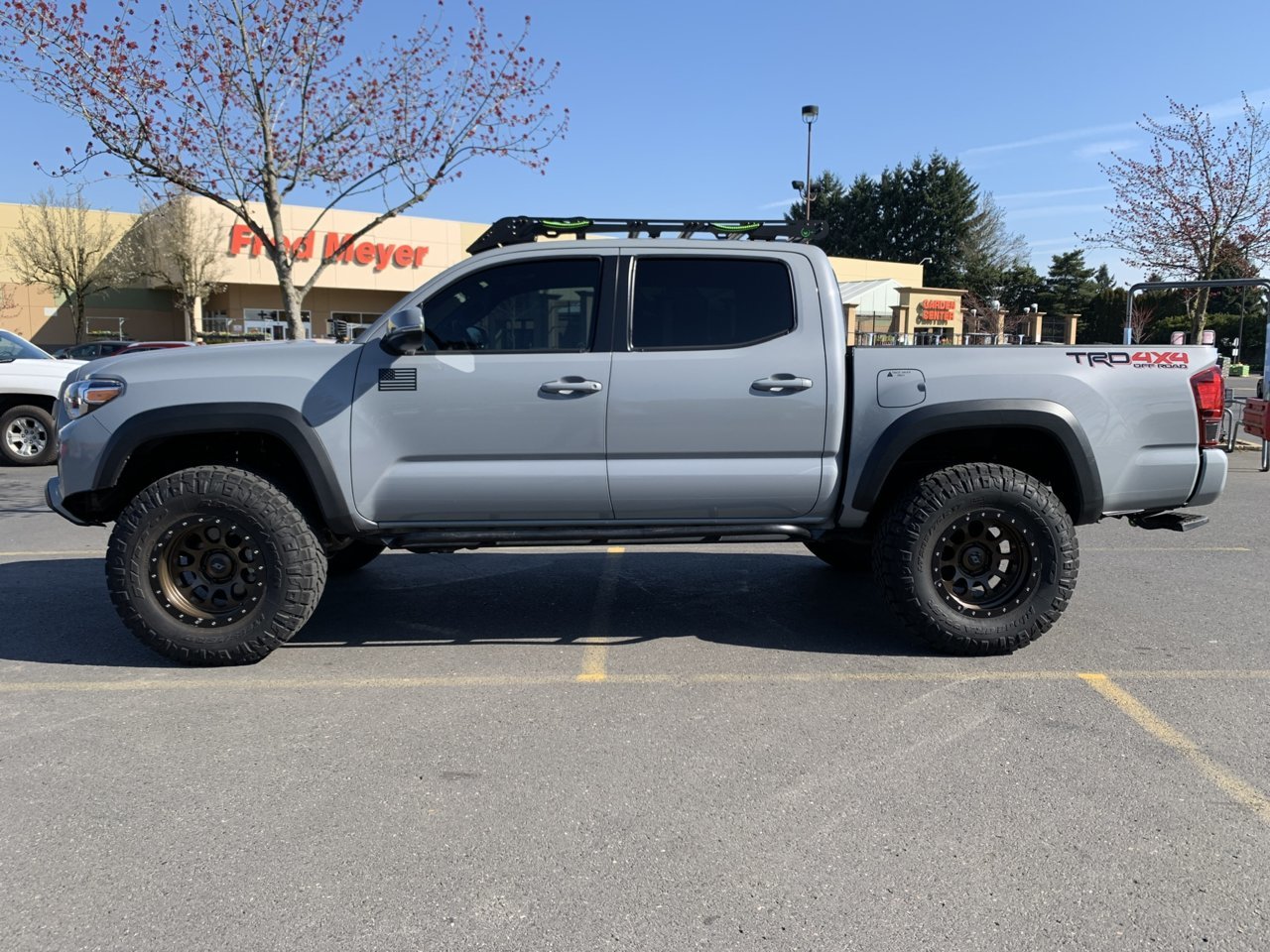

    I’m on notch 6 driver and 5 passenger. With 1/4” top plate driver side from headstrong, didn’t do much gain nearly 1/8” lift prob I need to notch up 6 on passenger
    ground to fender about 38.5” fronts and 39” rears

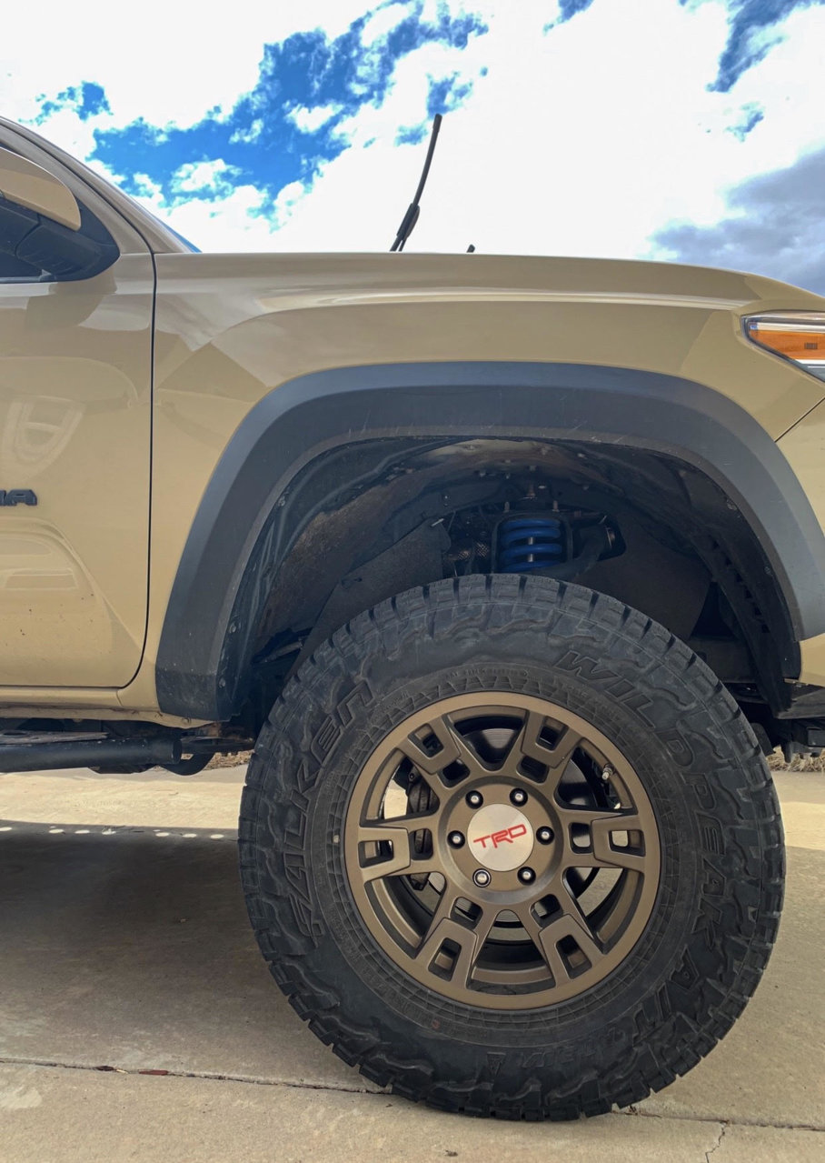

    *** Update: I have now installed Bilstein 650lb springs and love it!
    Below are some measurement notes I emailed to myself.
    August 2017
    Bilstein 6112 & 5160 + AAL & Overload leaf.
    Front driver side: 21" initial > 24" right after > 23.25" after about 2 weeks
    Front passenger: ..?.. initial > ..?..right after > 23.5" after about 2 weeks
    Rear driver: 22" initial > 25" right after > 24.5" after about 2 weeks
    Rear passenger: ..?.. initial > ..?.. right after > 24.75" after about 2 weeks
    June 2018
    After two weeks with King 700lb springs, 6112 on notch #4, HD Dakar full leaf pack + Overload leaf
    Front driver/Middle of hub to fender: 24” on driver side and 24.5” on front passenger)
    Rear driver side & passenger side/Middle of hub to fender: 26” on both
    Few months after July 2018: I revisited the shop again to increase the notch from 4 > max 6th because the 33s tire was rubbing a tiny bit when going over a dip and the rake as little too much with the HD Dakar + Overload leaf. Kept the 700# coil (700lb spring) and kept the 1/4” spacer on the driver side.
    Today April 20, 2020 - it’s been about/over 1.5 years later on this setup (6112 at max 6th height + 700lb coils).
    Measurements as of today 4/20/20:
    Front driver side/passenger side, hub to fender: about 25” for both, maybe give or take 1-2cm.
    Rear passenger side/hub to fender: little over 26”
    Rear driver side/hub to fender around: 25.5” (not sure why this is sitting about 1" less than the rear passenger side).
    The ride is not ideal because i don’t have the proper after market weights (armors) in the front. I have added a slider few months ago and it seems to have helped a very tiny bit or maybe it's just all in mind :crazy: . I keep wanting to replace the 700# with a 650# but then i think about adding armors instead. Lately just don't wanna spend any more money (than I’ve already spent on suspension, wheels, tires, ReGear 5.29 & more) and just trade-in for Tundra TRD Pro in few years for the roomy interior for the fam and V8!
    With all that said, the ride is definitely & noticeably better when theres someone riding next to me in the front passenger seat!
    Alright that's all the ramblings for today. :hattip:
    Some pictures I took just now:
