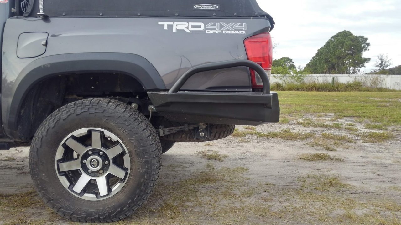

    I will never run without a spare personally, but I also like to go to out of the way places. I have lost heavy ply tires on rocks and stumps, once on a 2x4 that was kicked up by a car in front of me on the hwy. I run 255/85s right now and fit the spare below the bed without doing anything. 255s are slightly taller by math than a 285, so a 285 should be fine there. What I don't know is if a 285 a) will fit the spare rim, and b) will clear the UCA while on a spare rim. The 255s look pretty damn close on the spare rim. You could always also get a used 255 series tire that you know will fit the spare and clear the UCA. Would be pretty close in rolling circumference to the rest of your set and is lighter.

    What rear bumper is this?
  10. Apr 30, 2020 at 7:39 AM
    #3330
    Rockefelluh
    Rockefelluh Well-Known Member
    Aug 18, 2018
    #263236
    2,051
    Rocky
    Orange County, CA
    2018 DCLB TRDOR 4x4
    SOS concepts :headbang:
