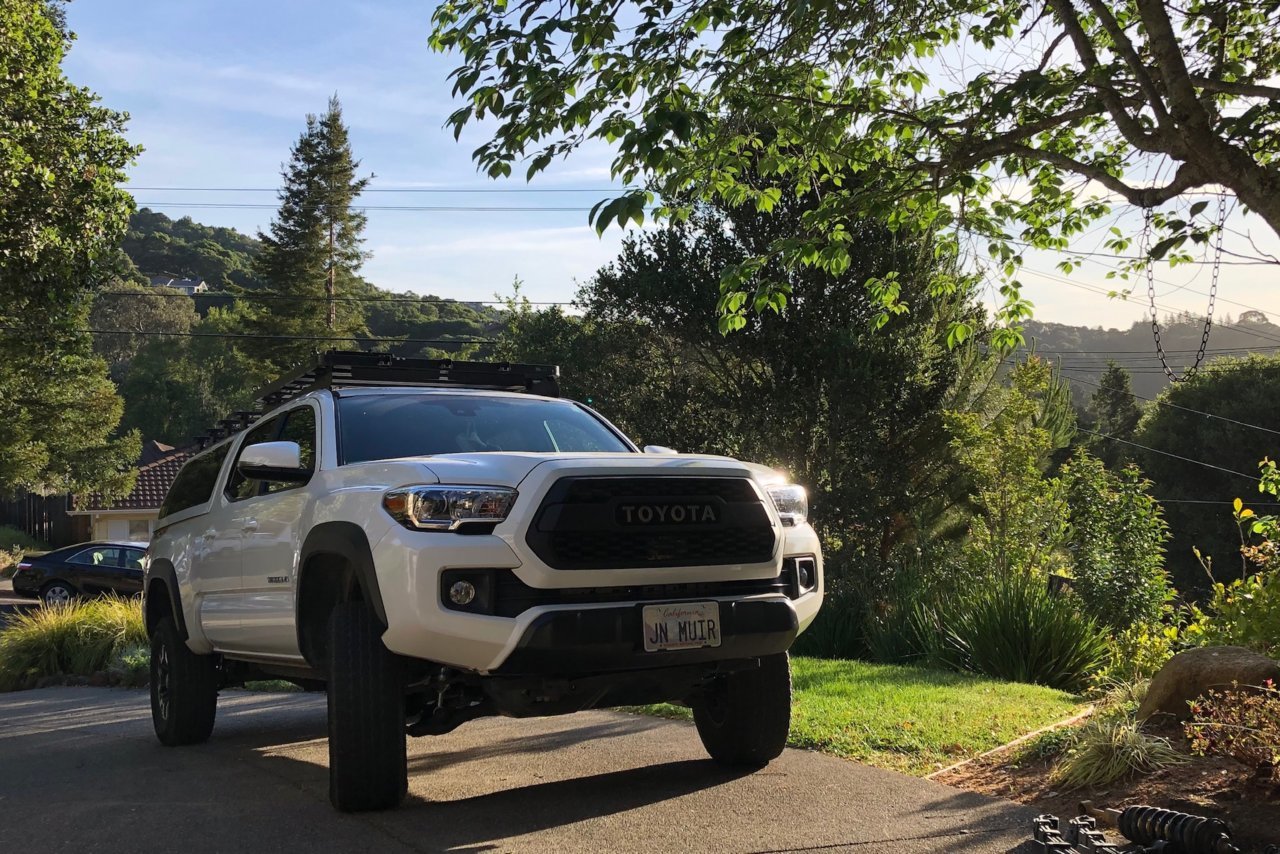

    Counting was never my strength

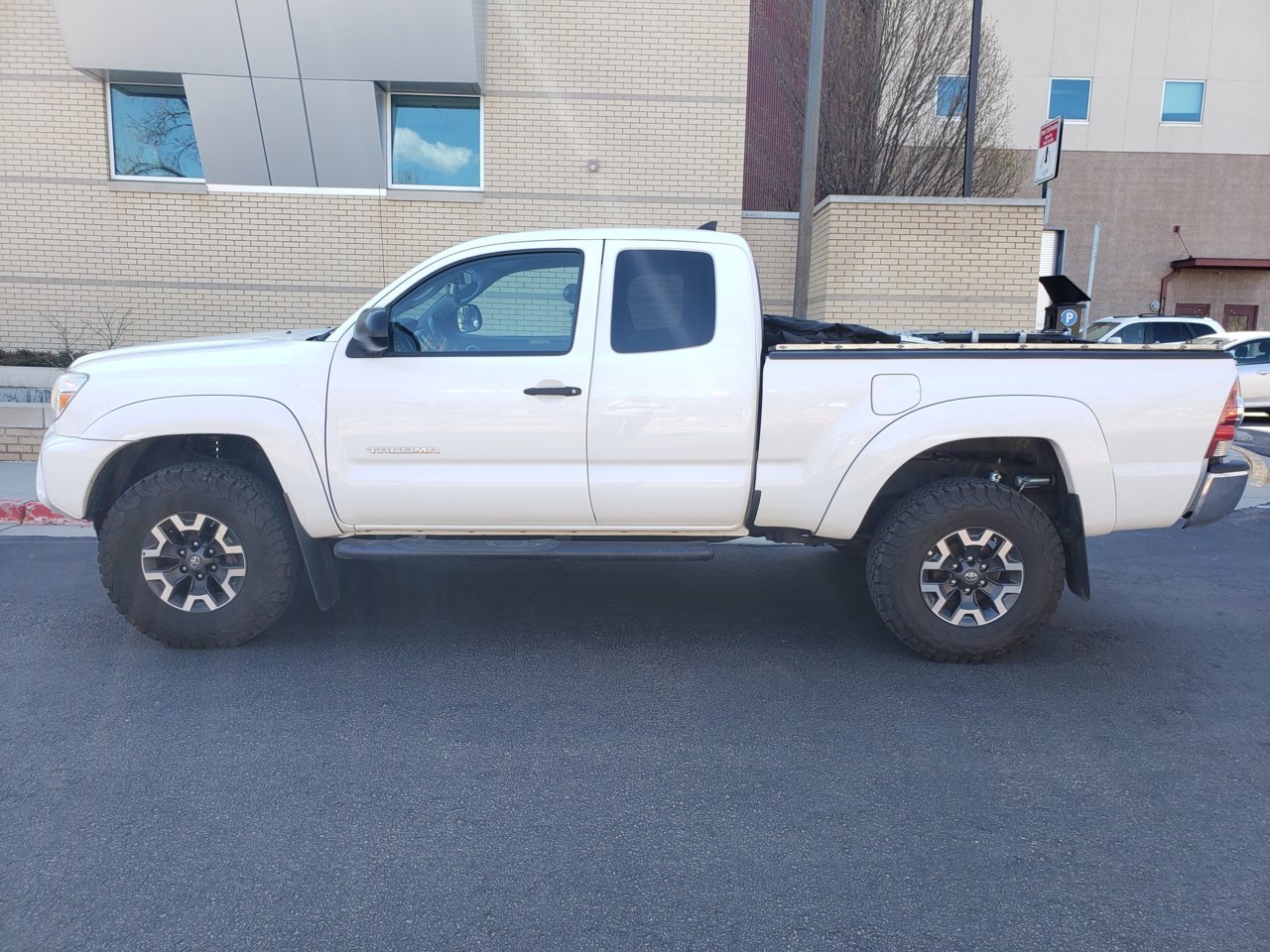

    Bilstein 6112's on 3/2 Icon Progressive AAL Bilstein 5160's 265/75/16 ko2

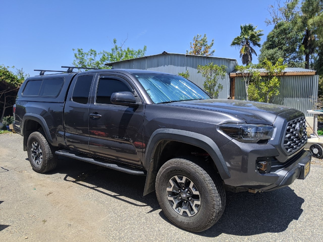

    Thought I'd post up my numbers after a few days of settling and a 3 mile trip with 600# of material in the back. 6112's are on 3/2 and I put in newish leaf packs from a 2019 trdor with an Icon progressive aal in the back, 5160's, and no overload. Truck is a 2014 v6 ACLB
    Before:
    19 3/4 20 1/4
    21 3/4 21 1/2
    After:
    21 3/4 21 3/4
    23 1/2 23 1/2
    Difference:
    +2 +1.5
    +1 3/4 +2
    Really happy with how things turned out. The ride is amazing on 3/2, well exceeded expectations. Bumps that used to scare me feel like they aren't even there. That feeling of my rear end flying off the road is gone. I seriously had no idea the improvement would be this dramatic. I cant wait to take these off road.
    I wanted to keep the factory rake and I am pretty close. I expect some settling still and with the gear or sand bags it gets in the back for 11 months of the year it should be perfect.
    Overall A+ rating on this mod. Everything went in pretty easy in the driveway, took about 12 hours taking my time with hand tools. Build quality looks top notch and the ride is superb. Price was nice too, got 4wp to price match some online deals so got a great deal.

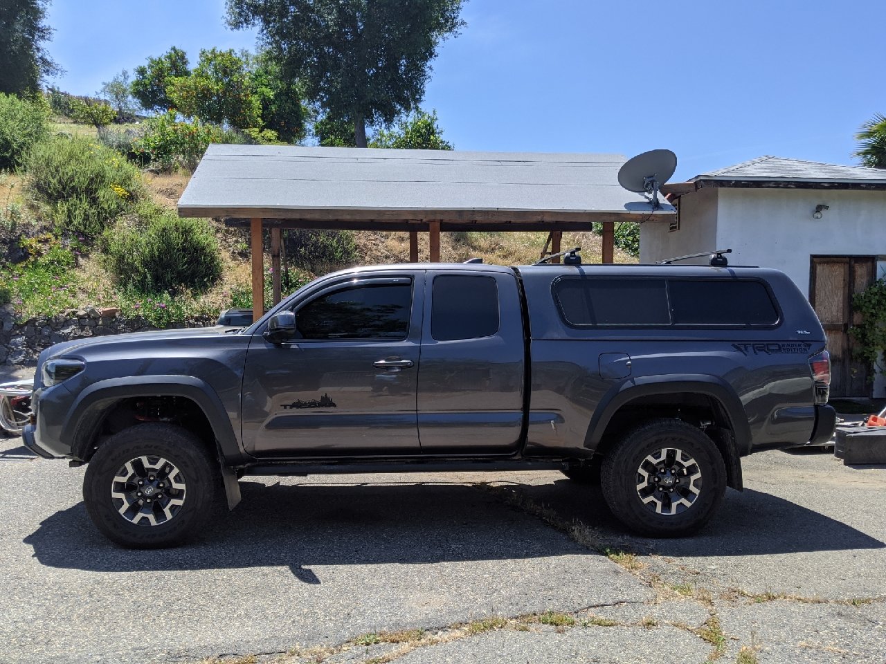

    So I had my .25" spacers swapped out with .5" spacers and now I'm 22" up front on the 3rd and 4th notch. Still have about a 1.5" rake in the rear but hoping that settles some over time. If it doesn't I may have to change the RXT springs from option 2 to 1. But I'd worry that would make the rear too low with the added weight. Either way, I'm happier with the stance now. The 6112/5160 combo is so nice and the ride is so much better.

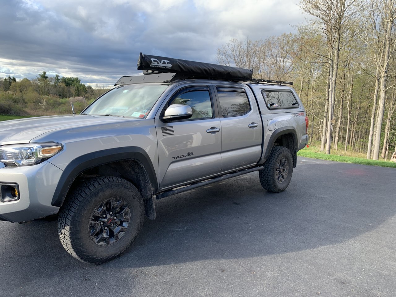

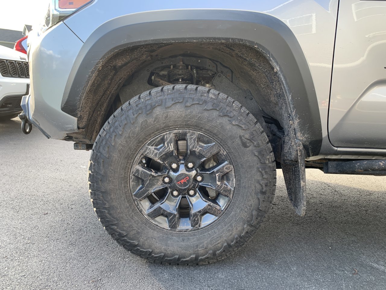

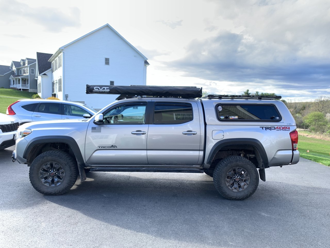

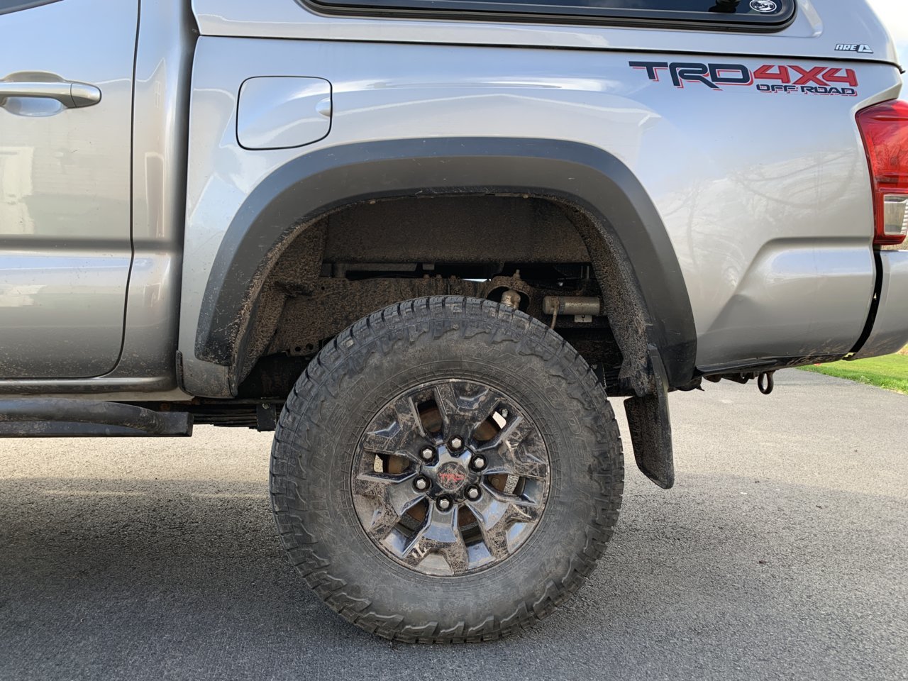

    Finally got around to installing a leaf to convert my MD Dakar pack to the HD pack. With the MD pack it sagged way too much when I was loaded up with my full loud out for camping.
    I was afraid I'd need shims, so I bought a few different degree but thankfully I don't need them. Had the truck up to 80 MPH and never felt any vibes. I tested for vibes with the truck in it's lightest configuration.
    I'm actually a half inch higher on the driver's side, but I do have a .5" shim from Wheeler's installed that I needed previously to correct the taco lean. If the half inch persists when I add more weight I'll remove the spacer to level the rear. This is how the truck sits in it's lightest configuration; shell and rack, bed mat, and hi-lift are the constant weight. I'll see how it lowers when loaded up. I'm at 5/4 in the front. It's possible I'll move up to 6/5 if I will still have some rake to spare when loaded up. Previously with the MD pack I was actually .5" higher in the front when fully loaded.
    Front: Driver side 21 7/8" / Passenger side 22” (1/8” lean)
    Rear: Driver side 24.5" / Passenger side 24” (.5” opposite lean)
    Rake: 2 5/8” / 2”
    crashngiggles and irayfz6 like this.

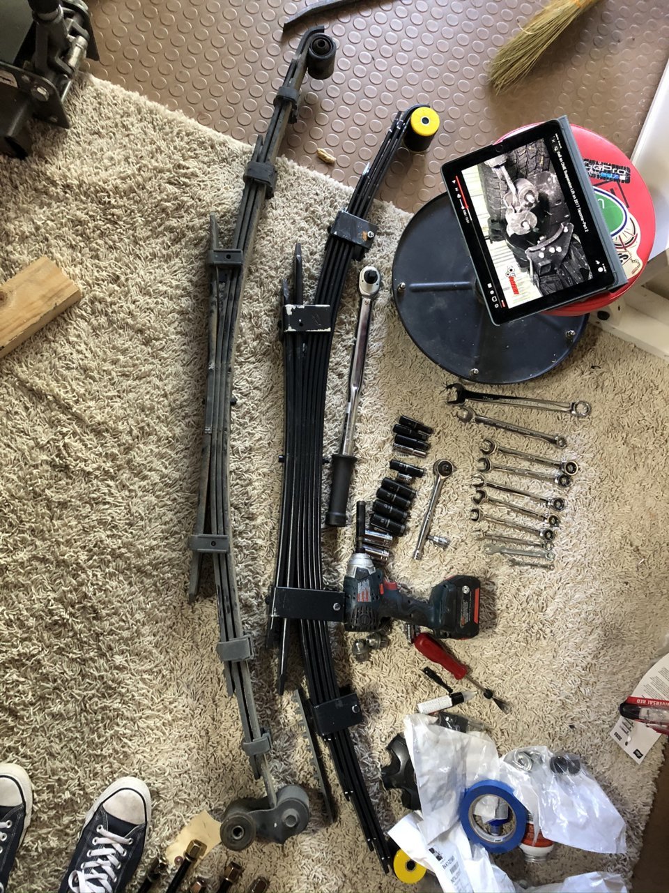

    DIY in the garage. Jack stands to elevate the truck and let rearend hang. Yes remove the wheel but the first wheel I did with the wheel on the other side touching the ground which made aligning the pin in the perch a nightmare! So my recommendation is to get both sides off the ground to allow for a wee bit of side to side movement that you’ll need. Did that on the 2nd wheel and it went much smoother.
