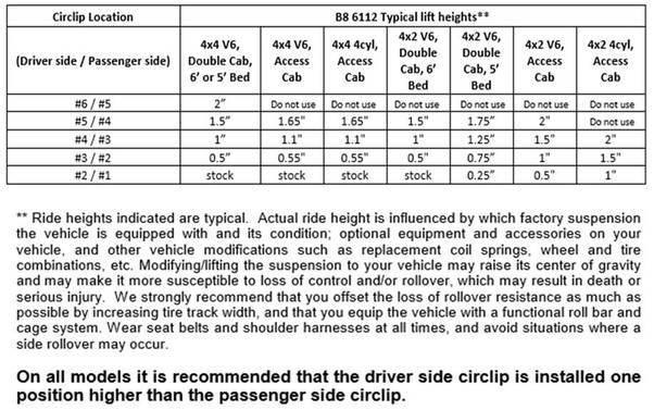

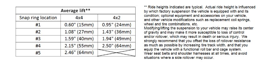

  10. May 6, 2020 at 9:58 AM
    #3370
    crashngiggles
    crashngiggles Tacomaworld's Resident Psych Dr.
    May 17, 2015
    #155446
    7,503
    Jared
    Wilbraham, Massachusetts
    2013 MGM TRD 4x4 DCLB Trail Limo
    This might answer your question a little more. Keep in mind that these charts are for the 600lb spring.
    2nd gen chart for notches:
    3rd gen chart for notches
    These charts take into account the height of the 3rd gen that is stock compared to a stock 2nd gen. It will show the different heights on different notches between the different gens for the 6112
  11. May 6, 2020 at 9:59 AM
    #3371
    crashngiggles
    May 17, 2015
    #155446
    7,503
    Jared
    See above

    Most certainly. The 650lb bilstein spring is going to be stiffer and with an extra 120-200+ lbs in front, it will be around this height with the same type of ride. Without the weight, it will give about 1/2"-3/4" more height (depending on a dcsb or dclb) and will give a stiffer ride. Not to mention that the higher you go up to and over 2.5" in a 2nd gen and up to and over 1.5" in a 3rd gen, you are also looking at aftermarket uca's (which honestly should be done anyway IMHO) to focus on ride and caster correction.

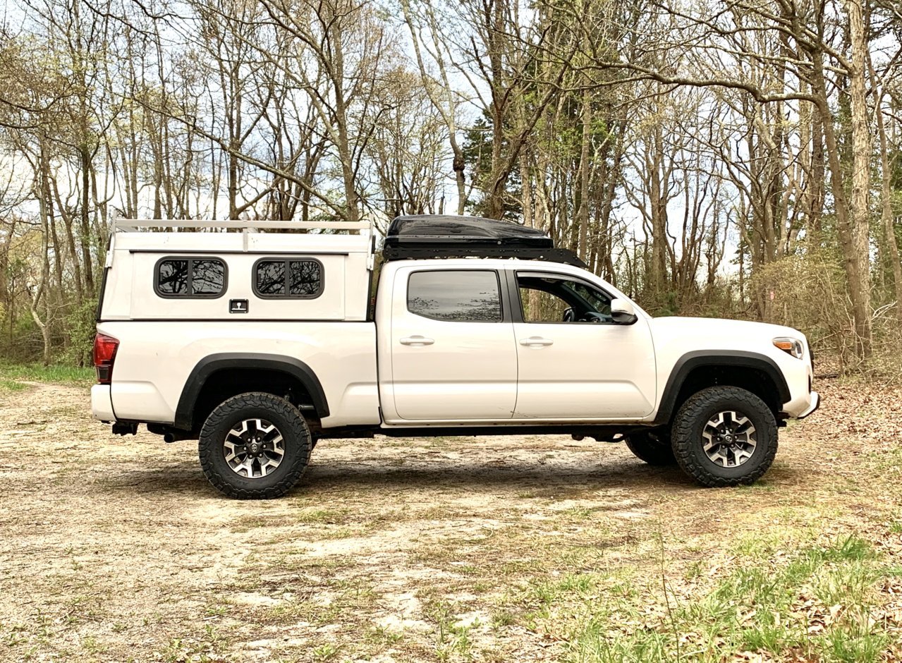

    Follow up image post install for those wondering on appearances.
    6112 5/6 clip fronts
    5160 rear with 1.5" Icon AAL
    Rear carrier bearing drop kit
    Front Diff drop kit from
    ECGS Bushing swap in
    On new BF K02 tires 265/75r16
    Cap on back but not a ton of added weight during photo
    Notes: Would say ride is much smoother when hitting larger bumps, brakes better without dipping as aggressive as stock suspension. I would reccomend going full height on the rings, it settles a lot more than you assume and I felt it was ebtter to know and want to lower once settles then never know. Even after install prior to the settling it didn't feel aggressively high at all and glad I went 5/6 full height.
    jeremy5000, maransin and FW_Taco like this.
