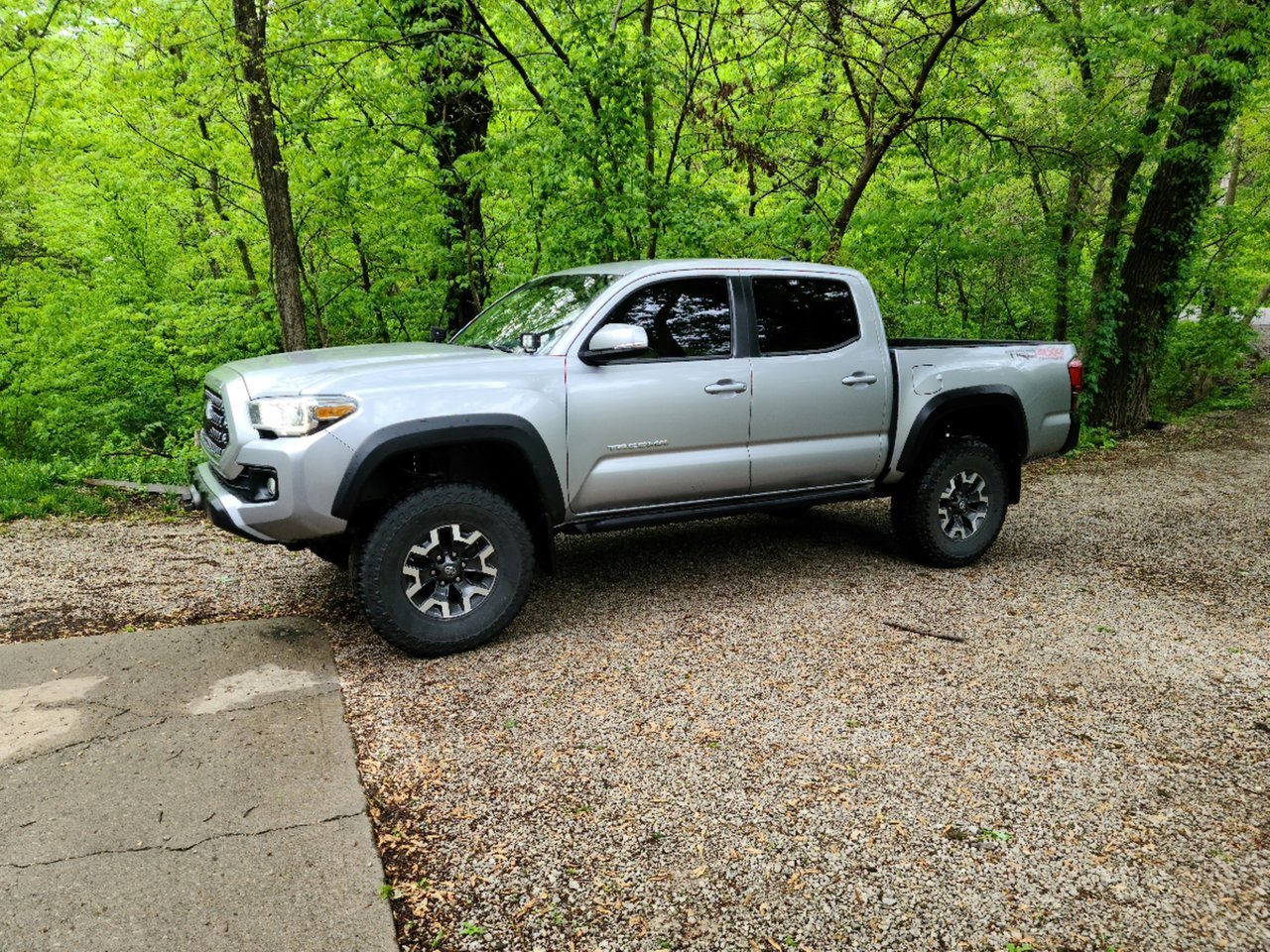

    Hey man sounds like you’re in the same setting as me for the 6112s and also got more lift than advertised. Not 3.5” tho! I’m at about 2.25” passenger and 2” driver currently with a full tank. Originally was 2.5 and 2.35 and they settled after 2 years.
    edit: you said 23” hub center to bottom of fender on drivers? That’s where I am at. That should be close to 2” of lift on a stock OR. Not sure where you’re getting the 3”

  15. May 9, 2020 at 9:25 AM
    #3395

  16. May 9, 2020 at 9:26 AM
    #3396
    Pilsner

    255/85r16 ST Maxx 6112/5160 w/ Dakar RCI armor, sliders, and rear bumper CBI hidden winch mount w/ Smity 20k
    Do you have spacers or is that your wheel offset. Those look good.

    6112/5160/Dakars/Pro Tacoma Wheels
    That’s the normal taco pro offset at +13. I’m gonna sell them as I just ordered F5s and 285s. Only about 25-30k on mine currently. 265/75r16.
