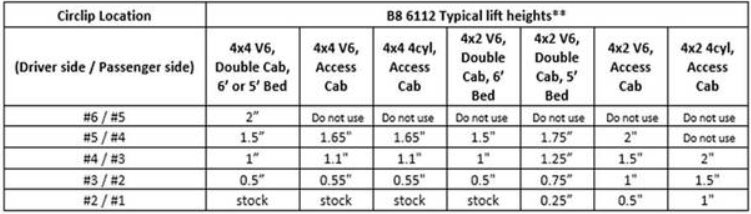

    I am sold on the 6112s/5160s and I already have the 5160s sitting in the garage waiting and now I am looking to purchase the 6112s and I thought I was set on the 5/6 setup but now may be considering the 5/4 only because I am not wanting to go more than a 2 inch lift. Was also thinking of the getting the KING 700lb spring but I am understanding that this will make the ride stiffer? I don't plan on putting a winch on or loading weight on the front. Some advice will be appreciated. In regards to the rear with the 5160s, I will be going with AAL but not sure with what brand.

    A 700lb spring will ride much stiffer if you are not planning to add additional weight.
    Your third gen truck, if a double cab, will be raised the 2" you want at the 5/6 setting.

    Or 2.25-2.5" like I got initially :)... mine is settled at 2" DS, 2.25" PS after almost 2 years.
