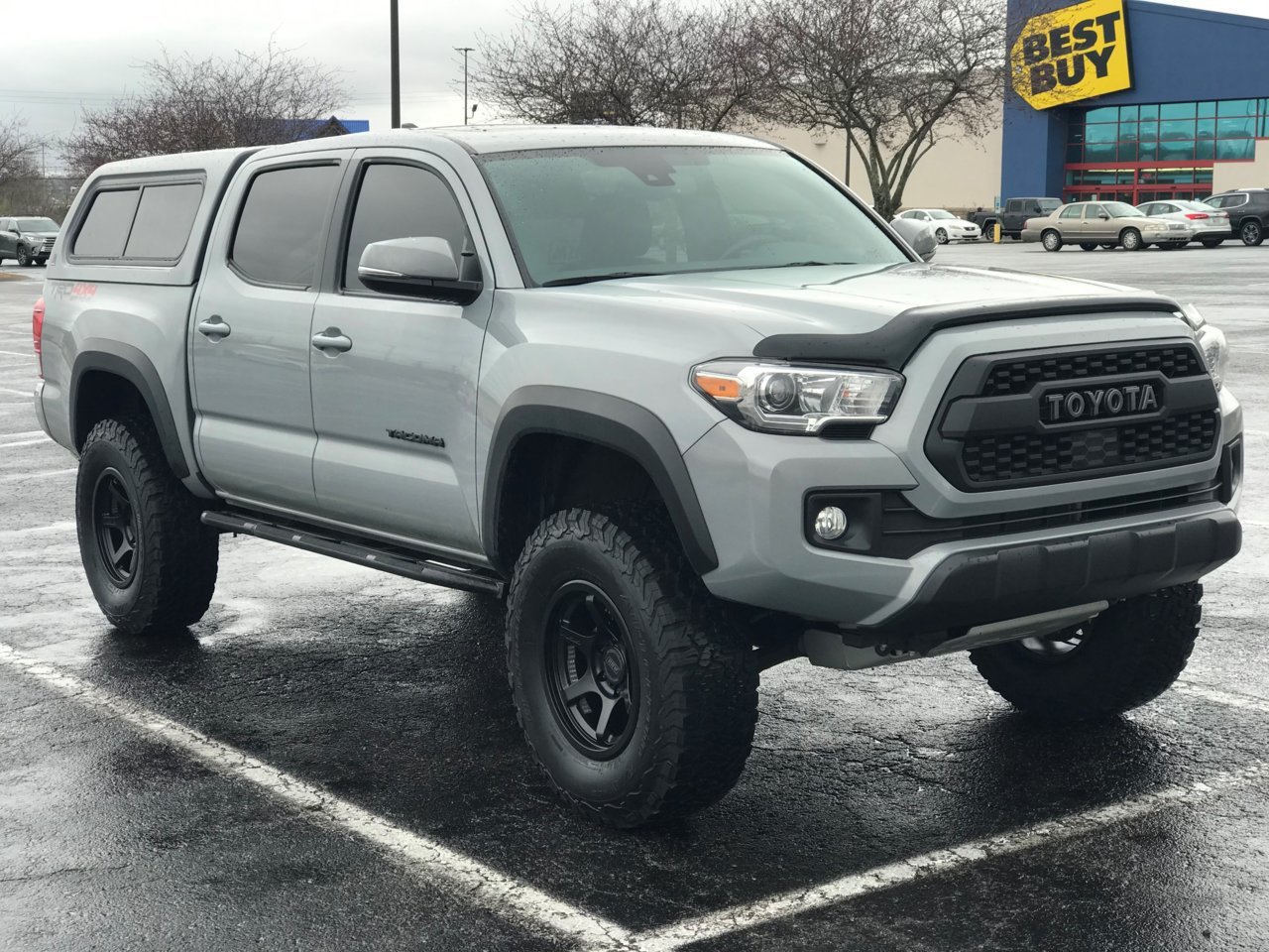

    I have 285/75/17 -12 offset with the 650s on 6/5. All clear other than CMC and minor Fender liner trimming
