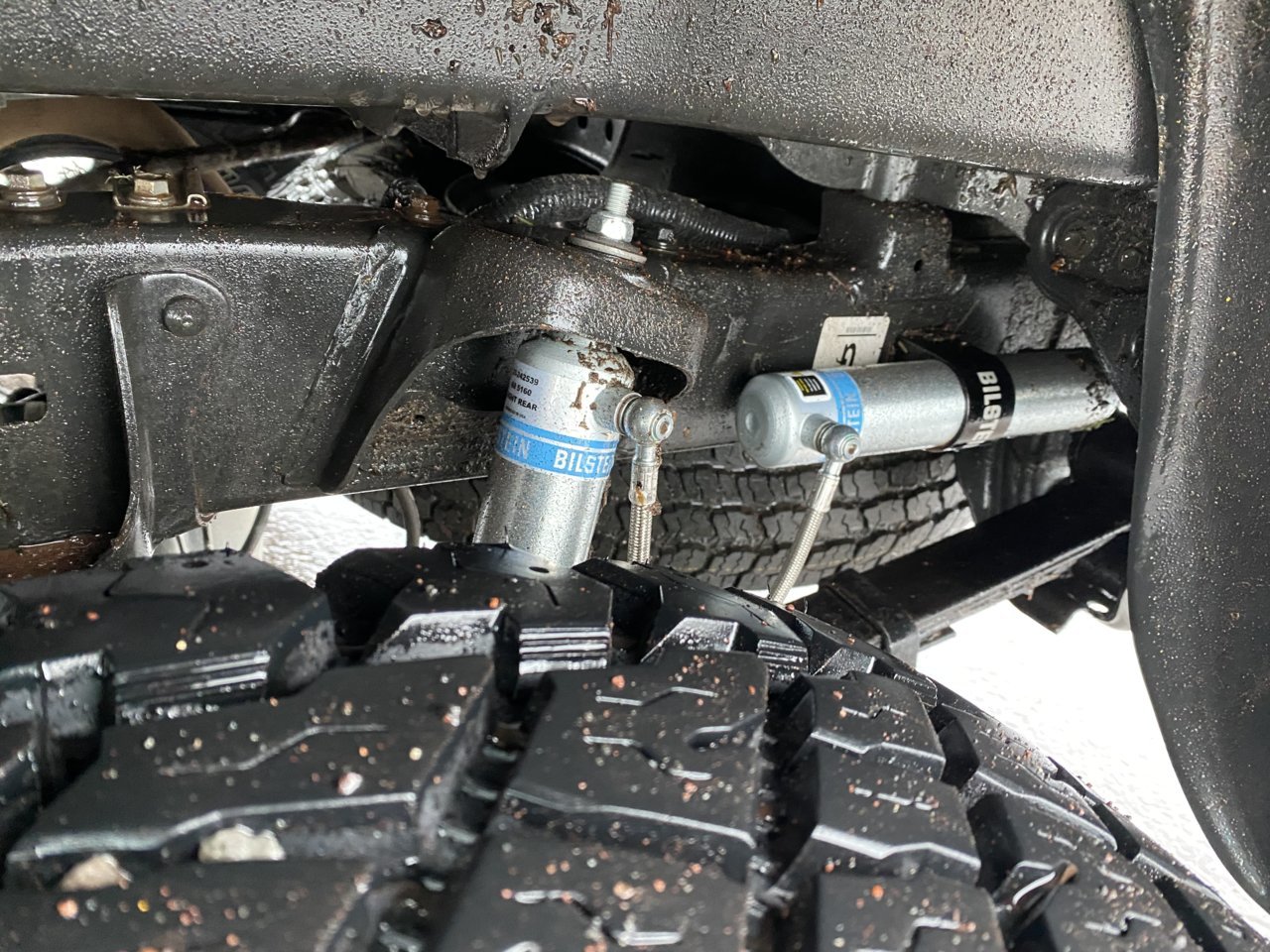

    How are you guys cleaning caked up dirt and grime on the stainless steel looking parts (shock bodies)? Only thing I find to work is a steel brush and wd40 but worried I may be scratching the finish? Degreaser? Trying to get them looking new again. I also live in the northeast

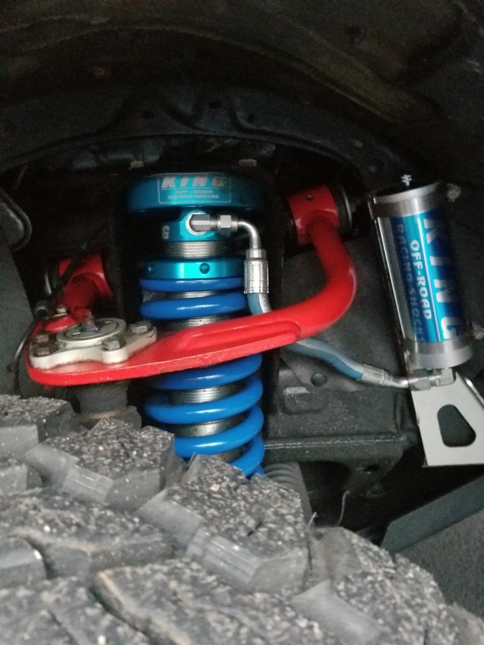

    I haven't done anything with mine but mine are still looking ok. I know that @Unchained 5150 has kings and protects and cleans his consistently. He may be able to give you a better direction to go.

    Fluid Film before Winter, then every other month I hose them off. Clean them up, then more Fluid Film. This is how they look after this Winter.

    Thanks. I have the billies tho. The wire brush seems to work but not sure if it’s safe for the finish... anyone know?

    There is no difference in cleaning/preserving a Bilstein vs King. Bilstein has a zinc or nickel coating so NO wire brush IMO.

    Maybe there is a brush that is still strong but plastic. I mostly need some kind of degreaser as the muck just doesn’t wanna come off.

    I wouldn't be afraid to hit it with some sort of soft brush. Try flitz and a rag. Maybe rubbing compound.

    WD40 and a rag or paper towels.
    Works great on the frame as well.

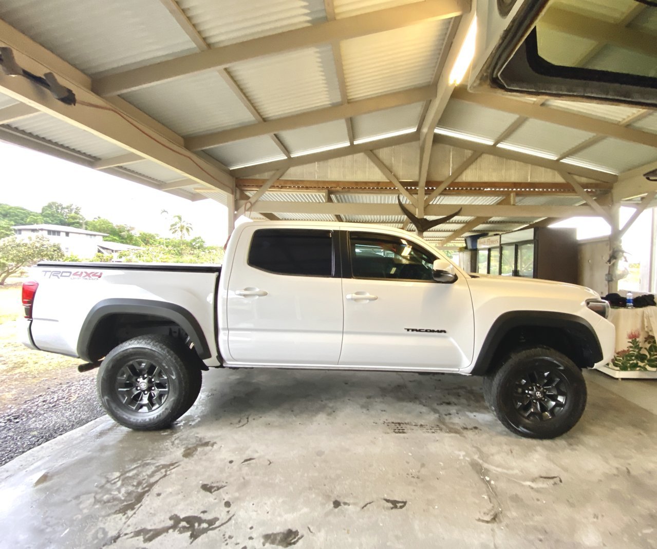

  19. May 17, 2020 at 12:06 AM
    #3479
    nai_hiro
    nai_hiro Instagram: _whitetac0
    Jun 25, 2019
    #297470
    76
    2019 Super White Toyota Tacoma Off-Road
    installed today-
    it’s the runnin4tacos
    (Stage 4 package with SPCs UPCs)
    6112 (5/6)
    5160
    Deaver AAL
    Toytec 2” bump stop extension
    — more information can be found on their site about their particular package.
    *had to take it to my cousins auto shop to install the springs on the struts so keep that in mind.
    I’m stoked on the outcome. All 4 measurements were around 38.5” so leveled the truck especially with the 5/6 notch recommendation. Taking it in for an alignment in a couple of days. Excited to see how much better it’ll be than the stock shocks.
    keeping the rims and tires stock for now. will shop for wheels and tires once the funds are built up again.
    https://www.runnin4tacos.com/produc...spension-kit-2005-2020-toyota-tacoma-lift-kit
    Superdave1.0 and Cash13 like this.
