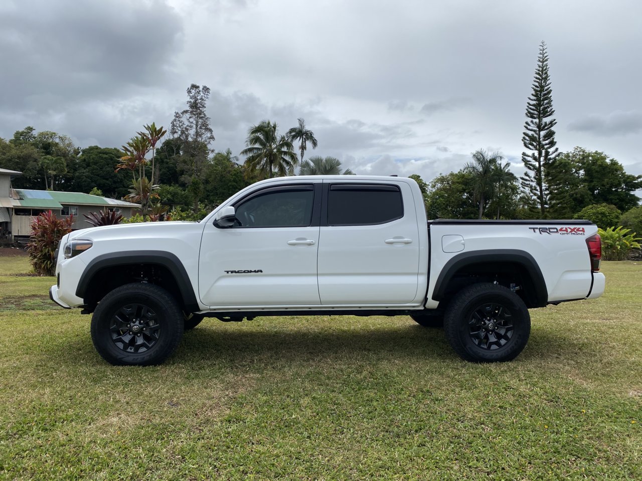

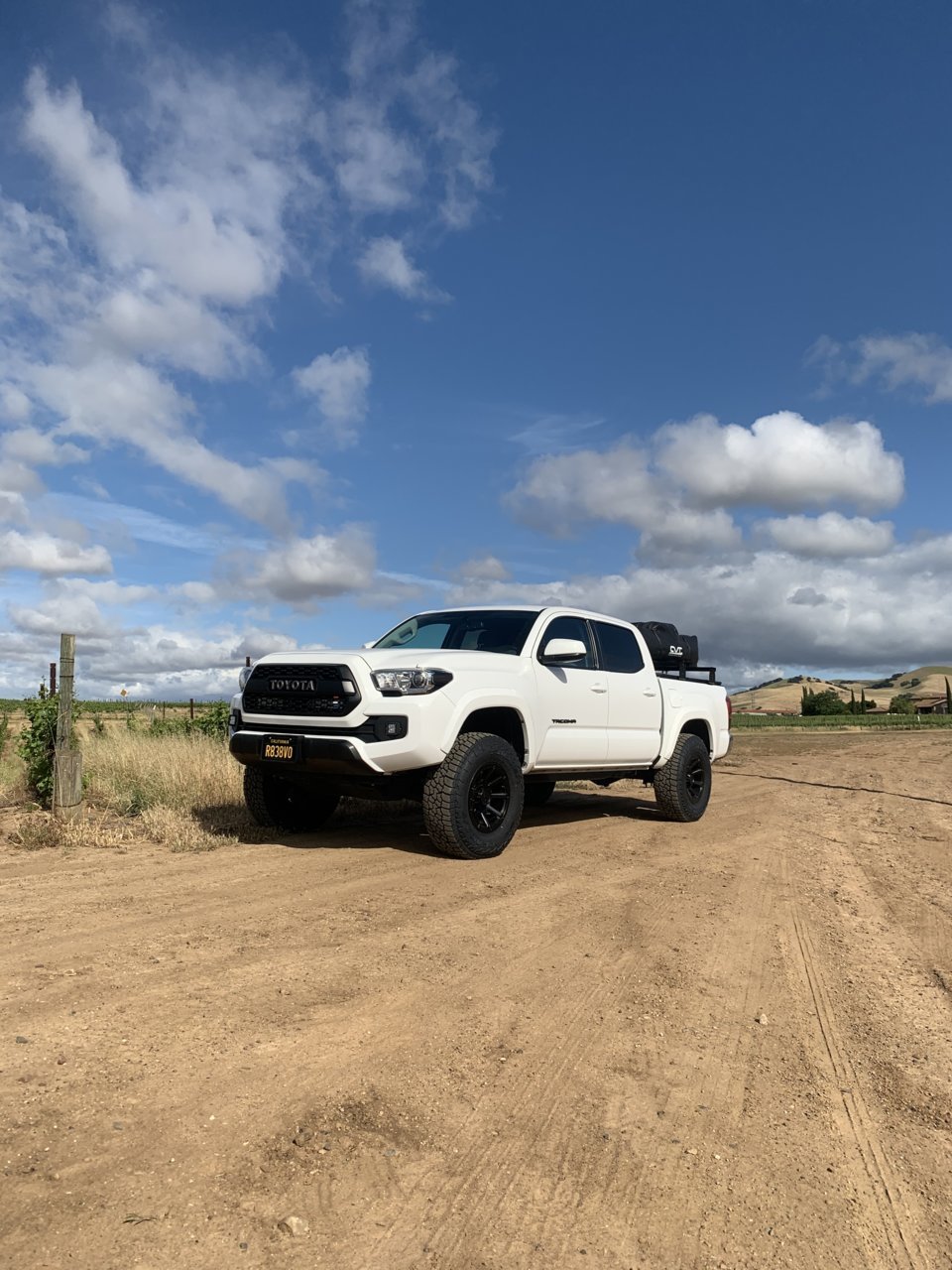

    Installed just last week:
    6112 (4/5)
    5160 W/Resi
    Icon AAL
    Spc UCA'S
    Ecgs Bushing
    265/75/16 Falken Wildpeak A/T3W
    Was on a slope and only picture currently. Truck sits damn near perfectly level.

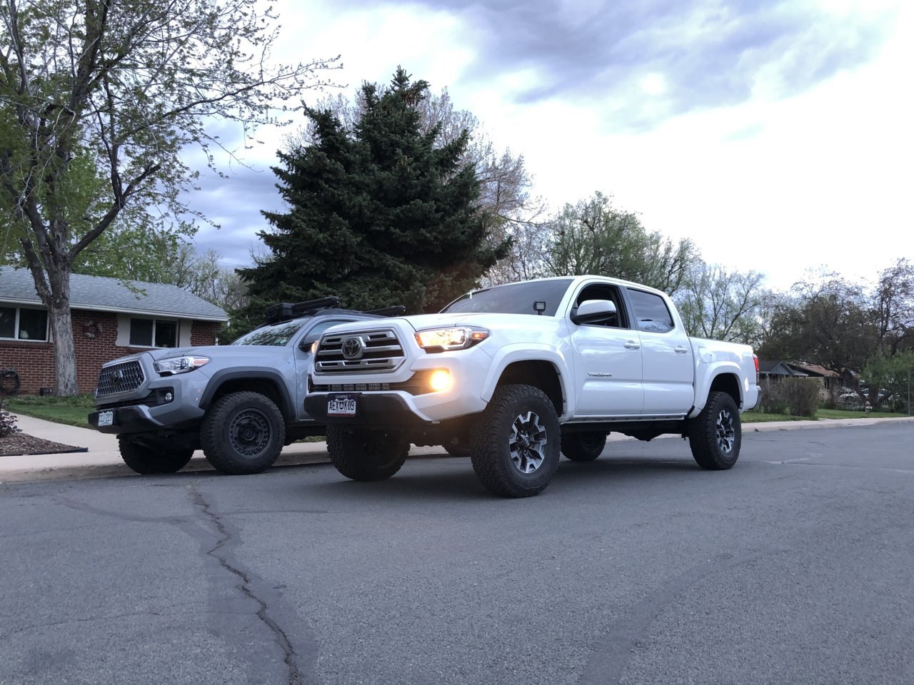

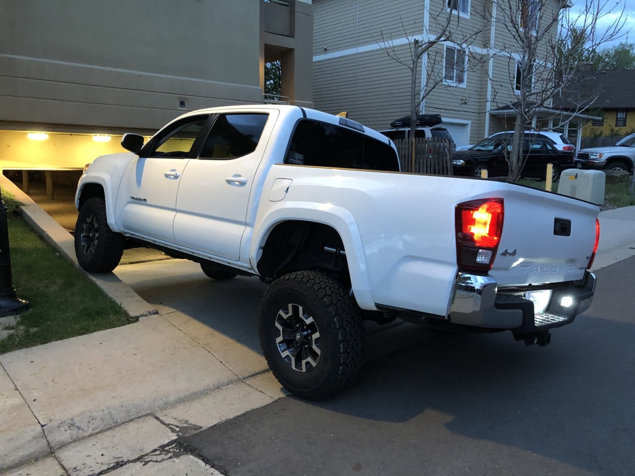

    a few days later with alignment done. still really impressed with this budget lift.
    when and if the time comes, looking to get some new wheels and tires. wanting a little wider wheel to fill the space of the fender. so maybe 8 or 8.5.
    if anything, just looking to upgrade the tires for sure to a 265/75/16 if I end up keeping the stock wheels. Not looking to make any trimming or CMC anytime soon.

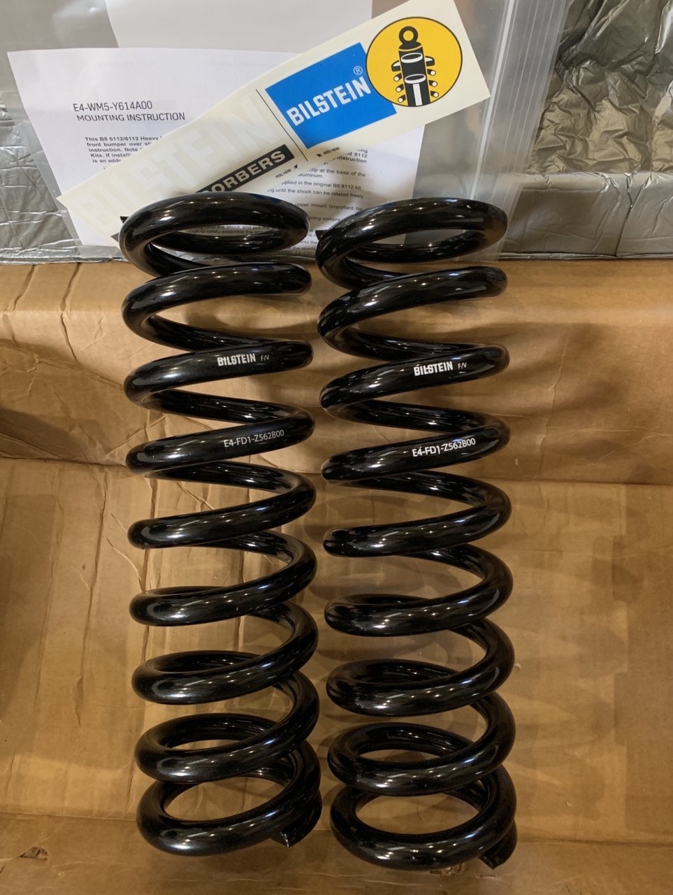

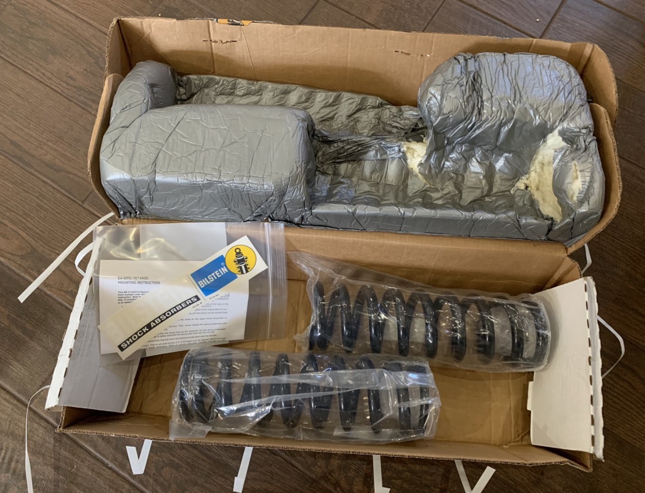

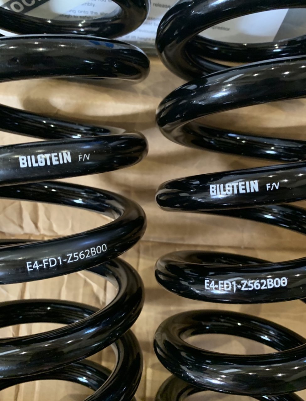

    Got the Bilstein 650 lb coils delivered today.
  14. May 19, 2020 at 6:36 PM
    #3494
    Island Cruiser
    Island Cruiser TVita
    May 20, 2012
    #79166
    3,937
    Kauai
    Baja
    Wow they really packaged those coils well!
    Tibetan Nomad[QUOTED] likes this.

    03 +300k Still Truckin, 2012 4Runner
    #650 is the magic number with 6112, very nice

    Yes sir!
