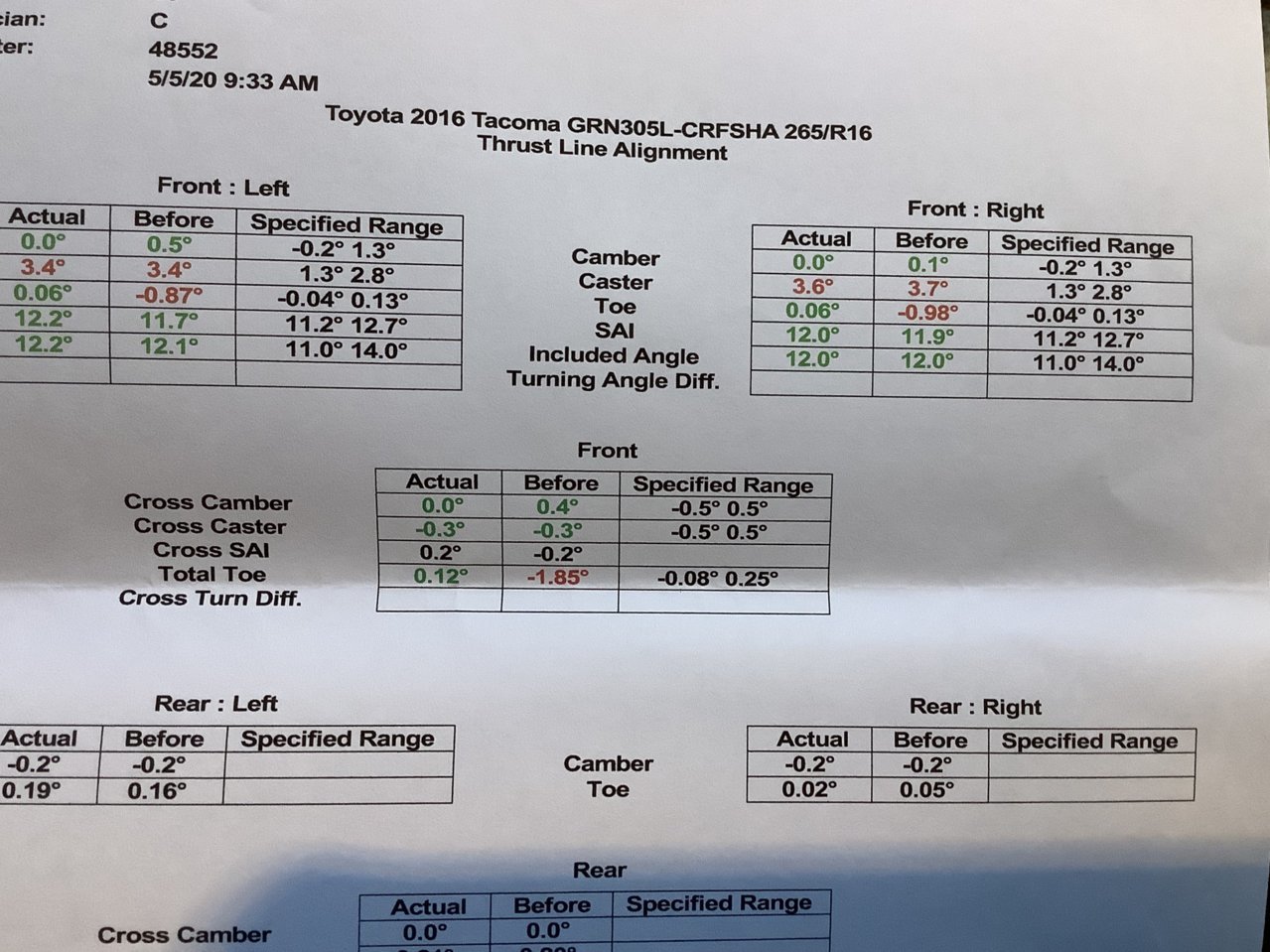

  3. May 21, 2020 at 6:49 PM
    #3503
    Nomad26
    Nomad26 Well-Known Member
    Sep 3, 2019
    #304117
    834
    Escondido, CA
    '16 MGM OR Access Cab, ‘16 MGM RAV4 Hybrid

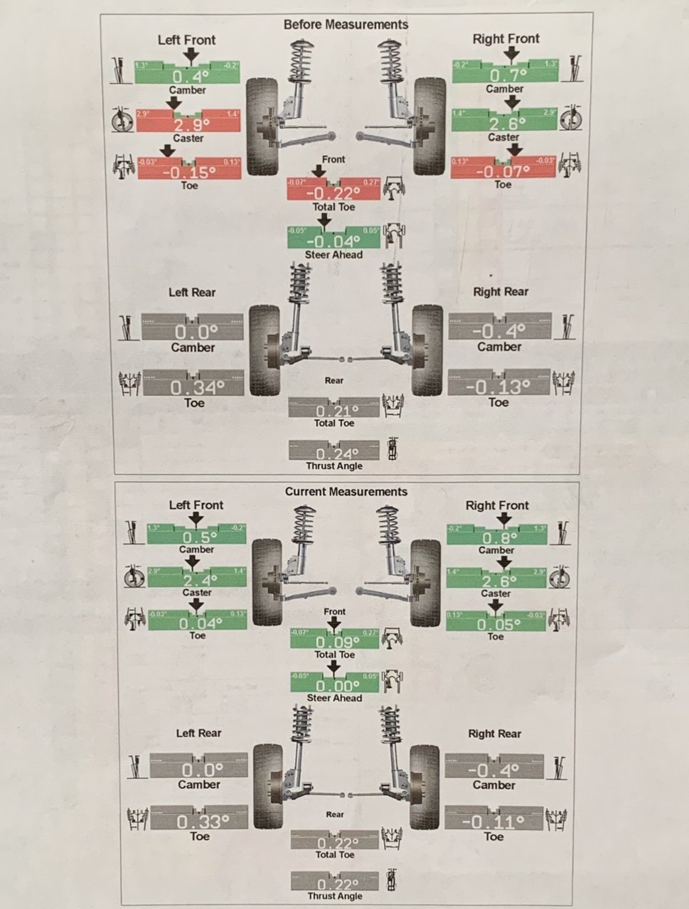

    After looking at that alignment, I’m not so sure about mine... thoughts?

  4. May 21, 2020 at 7:59 PM
    #3504
    ejewels
    ejewels Well-Known Member
    Dec 13, 2017
    #238387
    1,669
    CT
    2018 MGM TRD OR 4x4 DCSB
    6112/5160/Dakars/Pro Tacoma Wheels
    Caster looks good

  5. May 21, 2020 at 8:34 PM
    #3505
    Nomad26
    Sep 3, 2019
    #304117
    834
    Escondido, CA
    Thanks for that, I was mostly wondering about caster since I am really not familiar with alignment specs.
  6. May 21, 2020 at 9:14 PM
    #3506
    ejewels
    Dec 13, 2017
    #238387
    1,669
    CT
    From what I understand, if you’re lifted... you usually want caster 3 degrees plus.
  7. May 22, 2020 at 3:33 AM
    #3507
    crashngiggles
    crashngiggles Tacomaworld's Resident Psych Dr.
    May 17, 2015
    #155446
    7,509
    Jared
    Wilbraham, Massachusetts
    2013 MGM TRD 4x4 DCLB Trail Limo
    Regarding the alignment specs, a high degree of caster is not necessary because if the lift, but because of the bigger tire you will put on the truck due to having the lift. "Toe" is going the measure how your tires are facing in, out , or straight so your car won't drift left or right. Camber is how your tires are straight up and down. Caster is how your tire is moved front to back. The more degree of caster, the more forward or centered your tire will be so when your suspension is articulating or turning, it will decrease the likelihood of rubbing the cab mount or inner fender.
