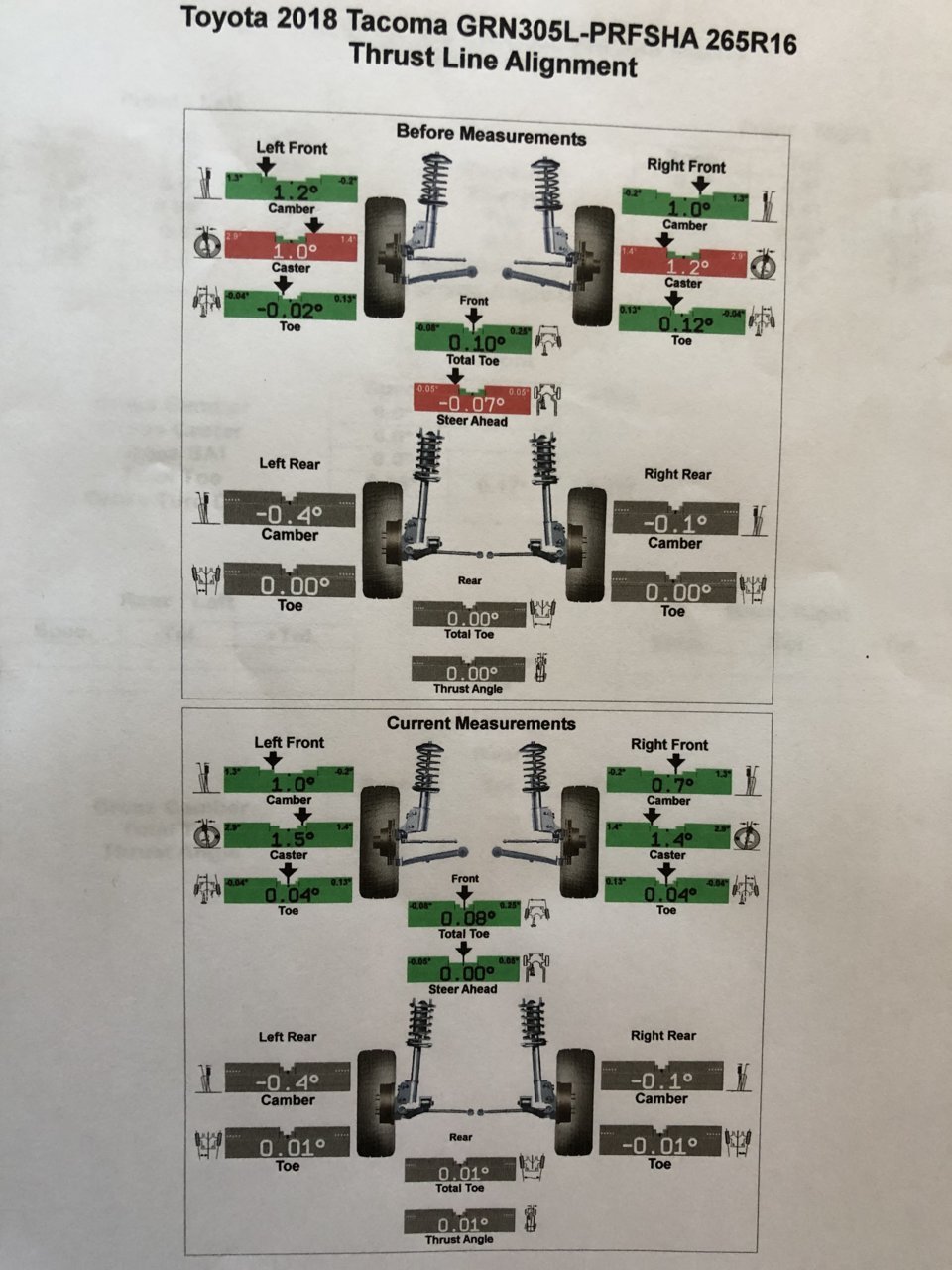

    Make sure you check with a couple of guys in your area of a place that knows how to do an alignment with the SPC uppers. It is not rocket science but tire and alignment shops like to play stupid.

    Yeah when I bought these I dedicated myself to understanding the ins and outs of these so I could know what I'm talking about and asking when it comes to alignment. Great advice though. Alllllmost bailed on SPC due to the adjustability, but decided knowledge is power. These things are extremely well built and will serve me well regardless of the future of my tire and suspension choices.

    6112(5th notch)/5160, JBA UCA’s, HS 3leaf add a leaf. Never measured but it rides great.

    a competent shop shouldn't have an issue knocking this out in 4 hours, more than likely they will quote you higher.
