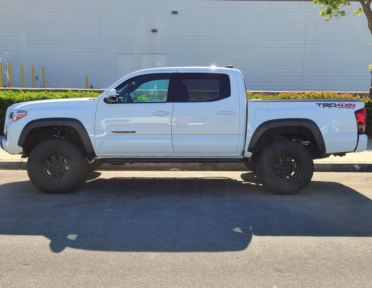

    Finally got the 6112s, 5160s, SPC UCAs, and Headstrong AAL installed. 6112s on the 5/4 notch. Noticed the difference within moments of driving it home. She rides smooth as butter now. It's a completely different truck. So happy with the results.
    Took some crude before and after measurements from the same spot. 2019 Off Road Double Cab Long Boi. Stock wheels and tires. No carrier bearing drop and no ECGS. Those are on standby just in case. Lift cost $800 to install from a local guy who did a phenomenal and quick job. My pics suck so don't ask.
    Before:
    FL 34 FR 34 7/8
    RL 35 1/2. RR 36
    After:
    FL 36 FR 36 1/2
    RL 37 1/2. RR 37 1/2
    Lift Results
    FL 2". FR ~1.5"
    RL 1.5". RR 1"
    Overall I'm fairly happy with the lift, although there is still an 1-1.5" of dip in the front which I don't like. I thought I was going to have trouble with the front being too high but there's only a slight improvement in forward lean. The back looks much higher than before, but the front doesn't look too different despite what my measurements tell me. Shrug.
    I did countless hours of research on this. Glad I did, but glad I finally pulled the trigger on this setup. The ride is a frickin' dream.

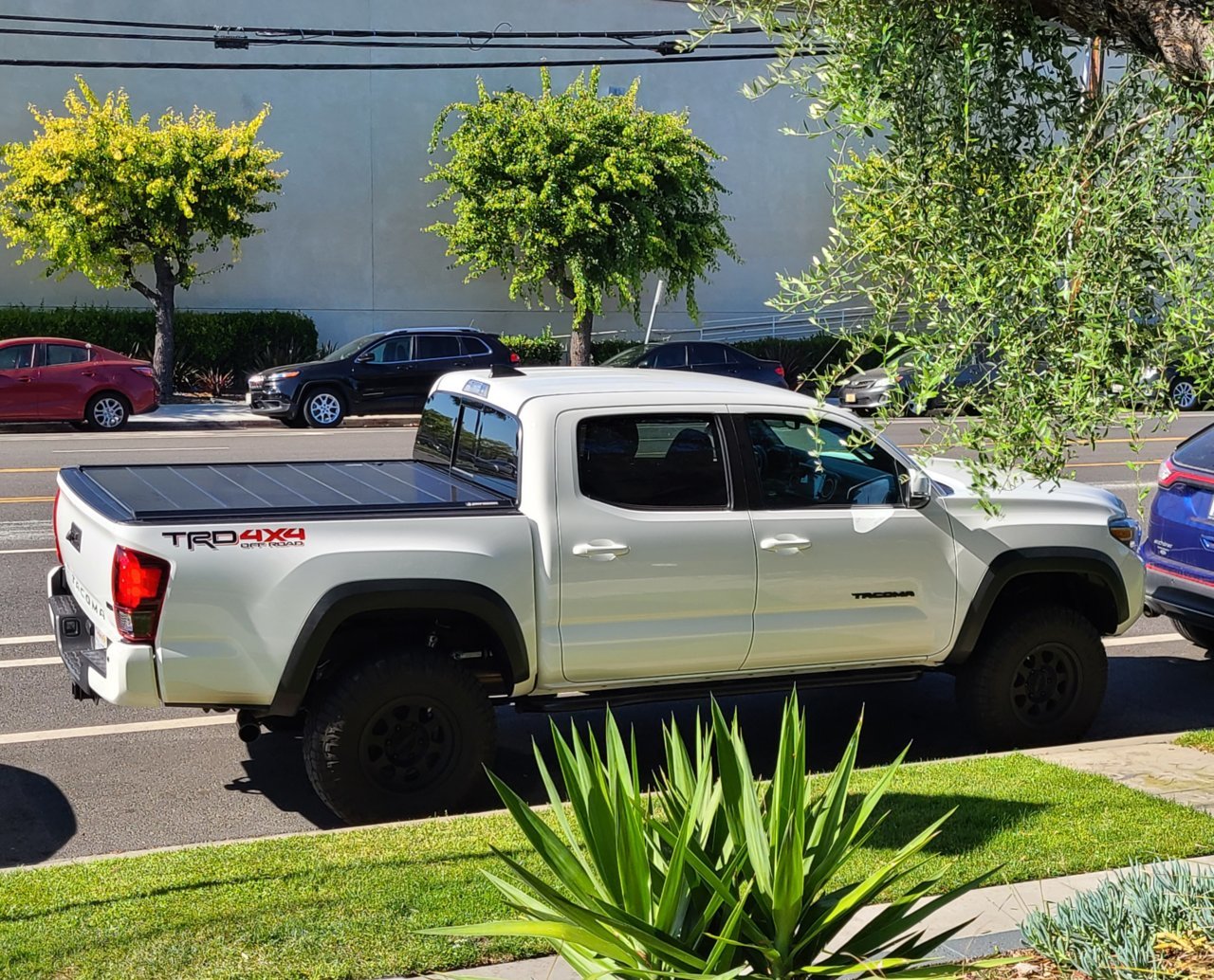

    Finally got the kit installed and couldn't be happier!!
    6112/5160 (front shocks set at 5/6)
    265/75r16 tires
    OME Dakar leaf springs (medium duty)
    Camburg UCA's

    Are you able to offroad with that setup? Or is there a bunch of rubbing
  20. Jun 11, 2020 at 4:26 PM
    #3580
    MemphisTaco
    MemphisTaco Well-Known Member
    Feb 15, 2012
    #72858
    278
    Cody
    Nashville TN
    2018 TRD offroad Tacoma
    Kings 2.5 front/rear, ICON RXT, RR2-s, 285/75/17 KO2
    Rubbed pretty bad at first, got rid of the mud flaps, and trimmed quite a bit of plastic from the inner fenders. Now on road I don’t get any rub at all. Occasionally while off-roading I’ll get minor rubbing at full flex
