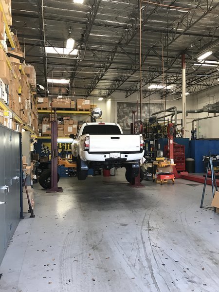

    She's currently up on the lift. They said they might finish today but tomorrow at the latest.

    They let me back to snap shots of the 8112s
