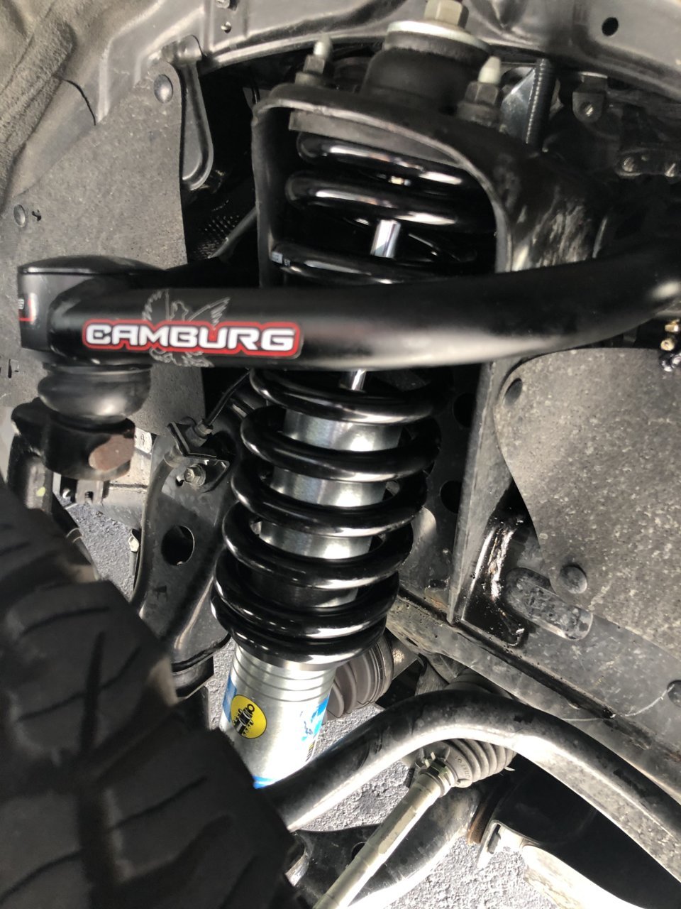

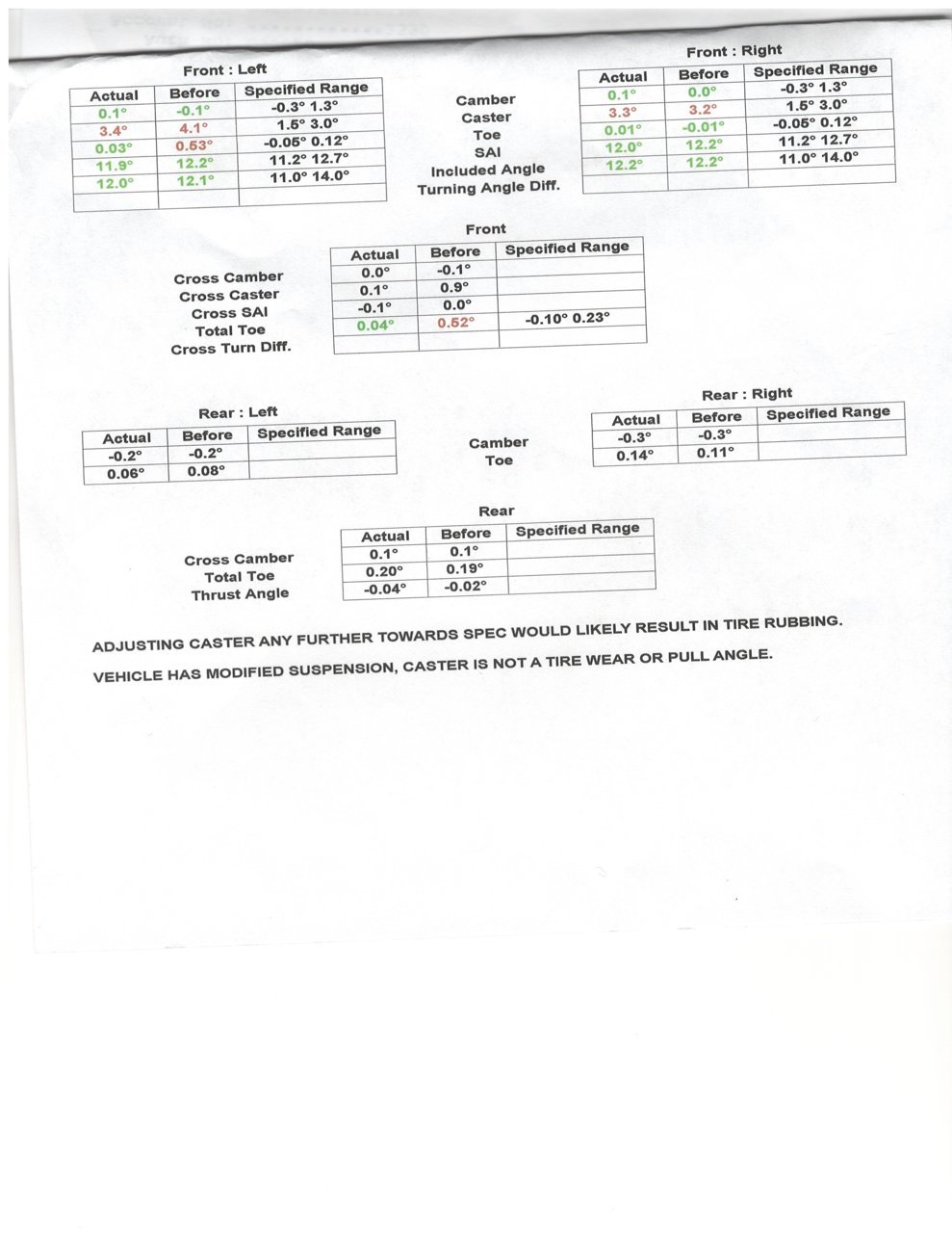

    Got my 6112s and UCAs installed yesterday. Can anyone comment on how they did with the alignment?

    I am running much lower caster - pretty near stock.
    With that much caster, does your wheel return to center on its own when you come out of a turn?

    Alignment looks good. 3-4 caster is what most shoot for so they don’t rub

    Yeah it till comes back to center. My commute is only about two miles but this weekend I'll take it out and get a better feel for the improvements.
