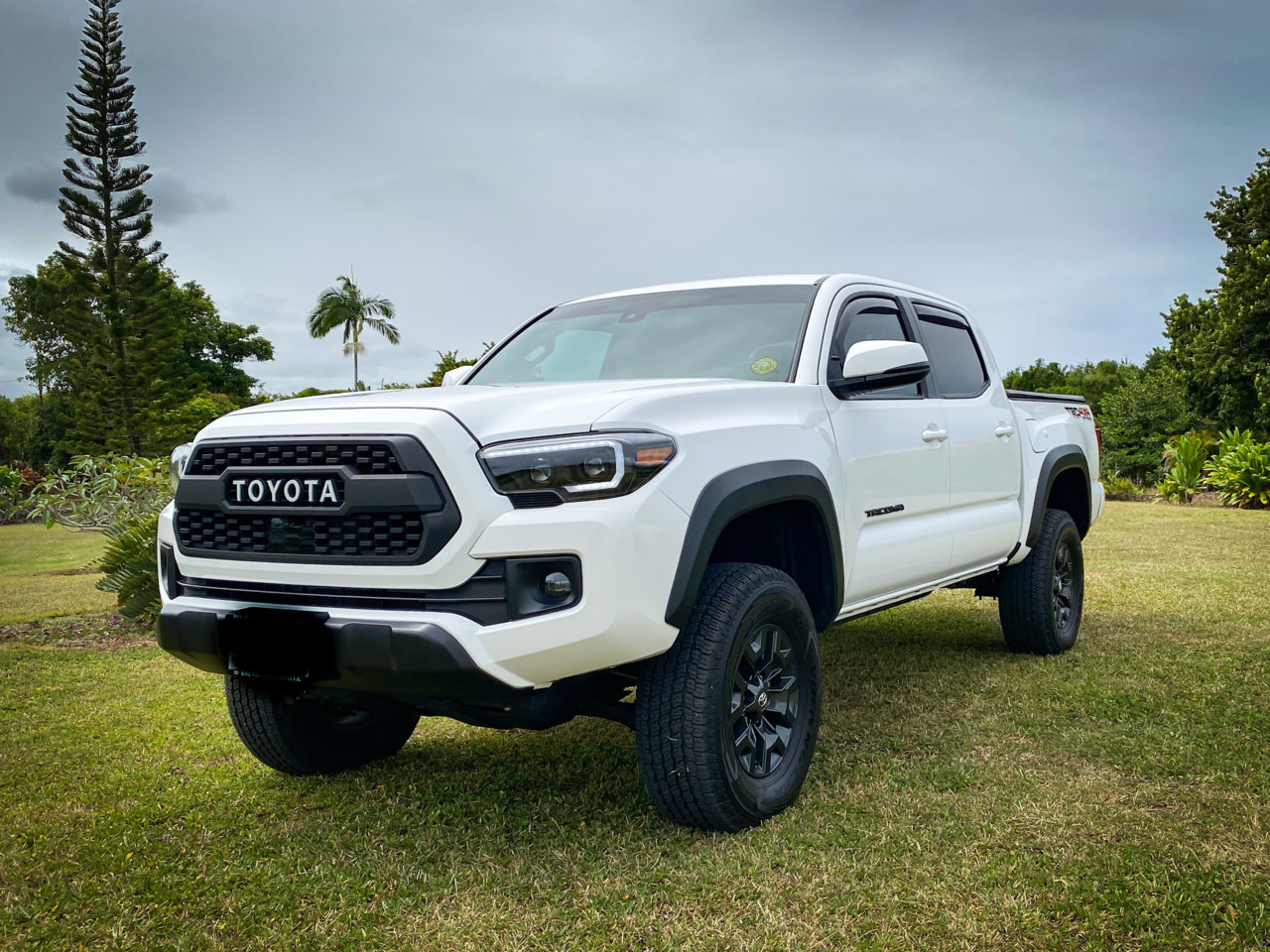

    Man this setup looks good, i'm thinking of going this route as well.

    thanks man! stage 4 kit from runnin4tacos if and when you do.
    the hardest part right now is finding out what size wheel (size, offset, backspacing) and tire that will fit without cutting and trimming. I know 265 and 275 will clear from what I know but curious to see if 285s will fit too.
