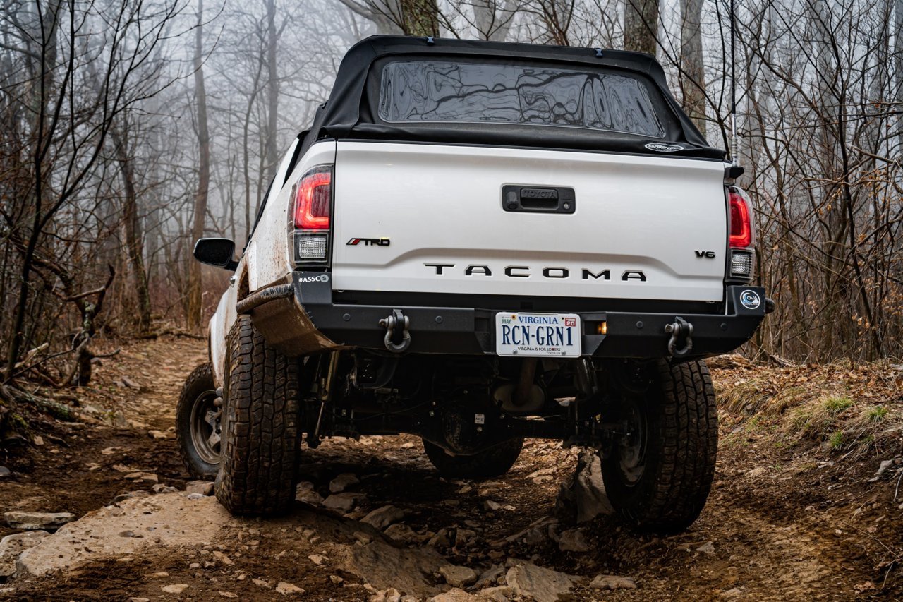

    Yeah just too pricey. I can do custom valved Fox shocks from Accutune for less but I guess you get what you pay for.
    what rear pack do you run and do you have pictures of your rear setup?
