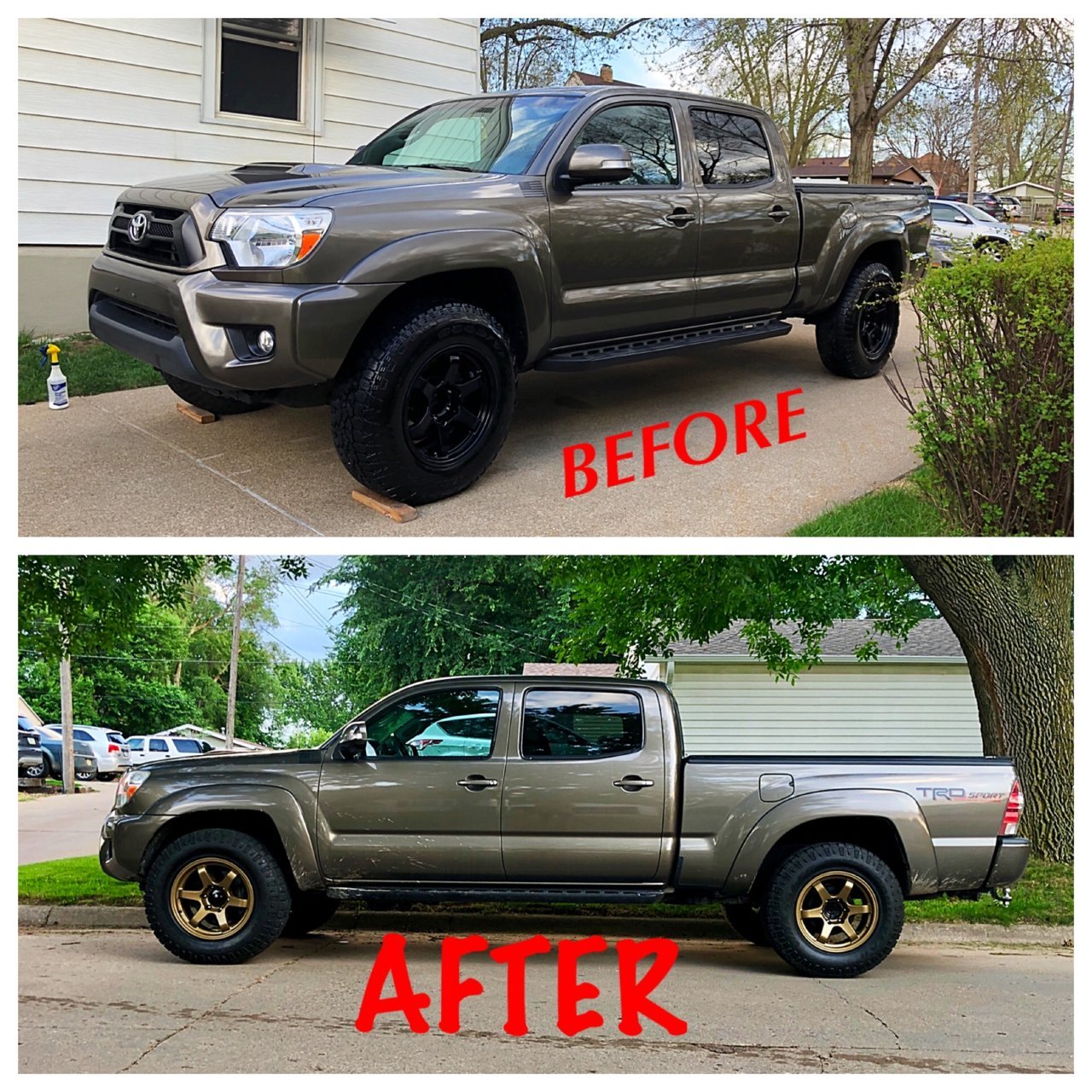

    TacoFergie Well-Known Member
    Dec 21, 2015
    #172832
    1,302
    Iowa
    WOOOOO! Looks like you got the last ones! Congrats! FWIW, this is with 4/3 and no rear lift for now. I just wanted to get them installed!! I'm not really driving around like this as I am not getting an alignment till I settle on front height after the rear suspension is installed. So it has a bit of cali-lean/saggy ass/carolina squat/doody in the pants look right now which I don't care for. haha

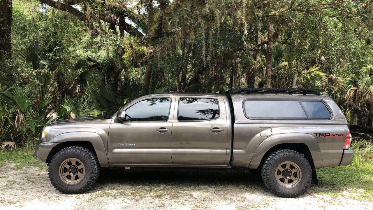

    VTacoma6
    VTacoma6 Well-Known Member
    Mar 1, 2016
    #179939
    205
    Vince
    Florida
    2015 Toyota Tacoma Trd Sport 4x4
    16 inch Matte Bronze FN Countersteer Type X wheels 0 offset With Goodyear Duratracs 265/75R16
    Nice color of wheels, goes perfectly with pyrite mica!!
    TacoFergie[QUOTED] likes this.

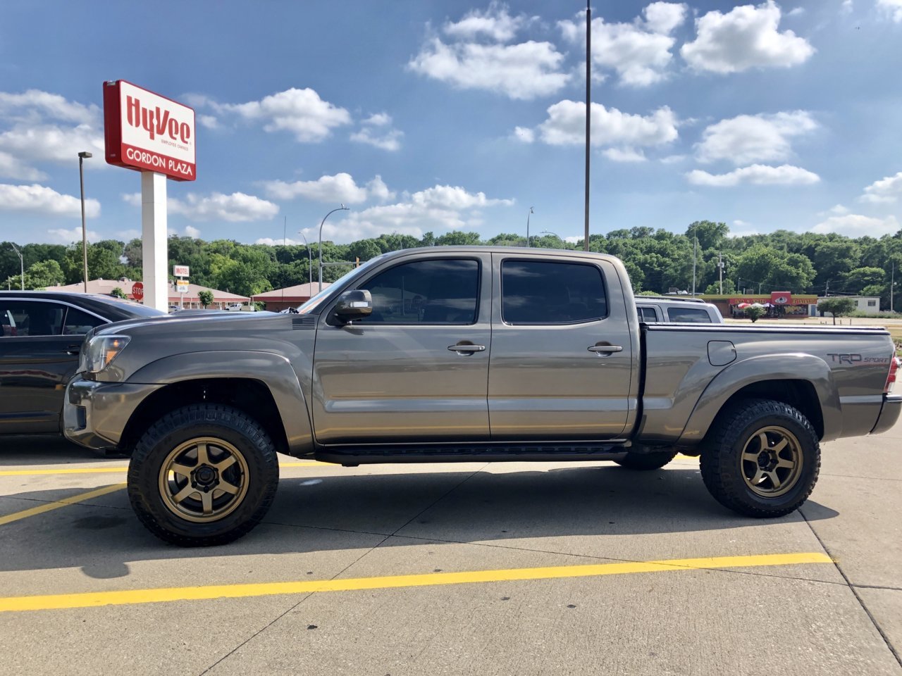

  6. Jul 5, 2020 at 10:20 AM
    #3766
    TacoFergie
    Dec 21, 2015
    #172832
    1,302
    Iowa
    Thank you! They are FN Wheels Six Shooter (discontinued 17x9 size, now 17x8) I got used locally, got a set of 5 for $550 with new goodyear kevlar tires that I sold since I swapped my Duratracs on these so a set of 5 ended up costing $150!! haha They were black when I got them, but I don't care for black wheels....not enough "pop" for me, kinda blah and all the bro-dozers around me have black wheels. I saw a thread for Pyrite Mica color and there were a couple with Gold/bronze wheels and knew I had to have it! So this is actually plasti-dip Bronze-Gold from Dip Your Car. First time I have actually done dip the right way and prepped correctly, the finish turned out great and haven't had any issues for about a year now.
    I'll be starting a build thread in a couple weeks to show some of this stuff. Name is going to be TightWad-Taco. lol

  12. Jul 5, 2020 at 10:42 AM
    #3772
    VTacoma6
    Mar 1, 2016
    #179939
    205
    Vince
    Florida
    Dustin at FN wheels has been awesome to work with. I personally think your wheel color looks good, it’s close enough. The truck would look good with a topper for sure! Took me a year and a half to find this one used, they are so expensive new.

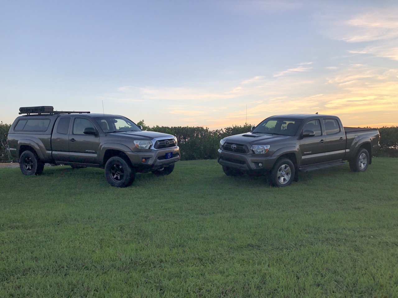

    VTacoma6
    Mar 1, 2016
    #179939
    205
    Vince
    Florida
    That’s funny man, when I had my access cab prerunner I had the FN 6 shooters and I contacted them about different options for center caps, but just ended up rocking the ones that came with them. This was my switch from prerunner to 4wd photo. Just had the Bilstein 5100 on it to level the front
