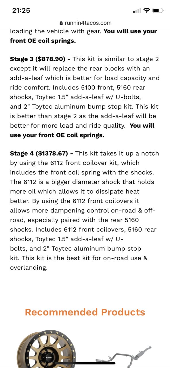

    I have the stage 4 kit from runnin4tacos installed and also have SPC UPCs installed.
    Stock Off road rims 16”....
    Spidertrax 1.25” wheel spacers were also bought but not installed just yet..

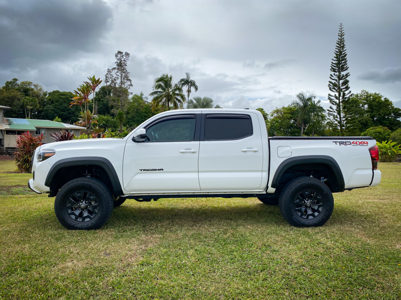

    Would anyone know if 285/75/16 would fit?? I wouldn’t want to trim or CMC but I have a feeling it might need to be done. Originally was going to get and still may get 265/75/16 but would hate to get that and regret not going bigger.

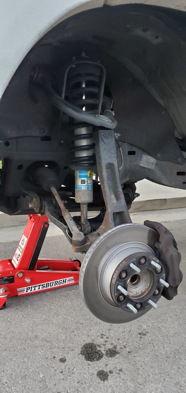

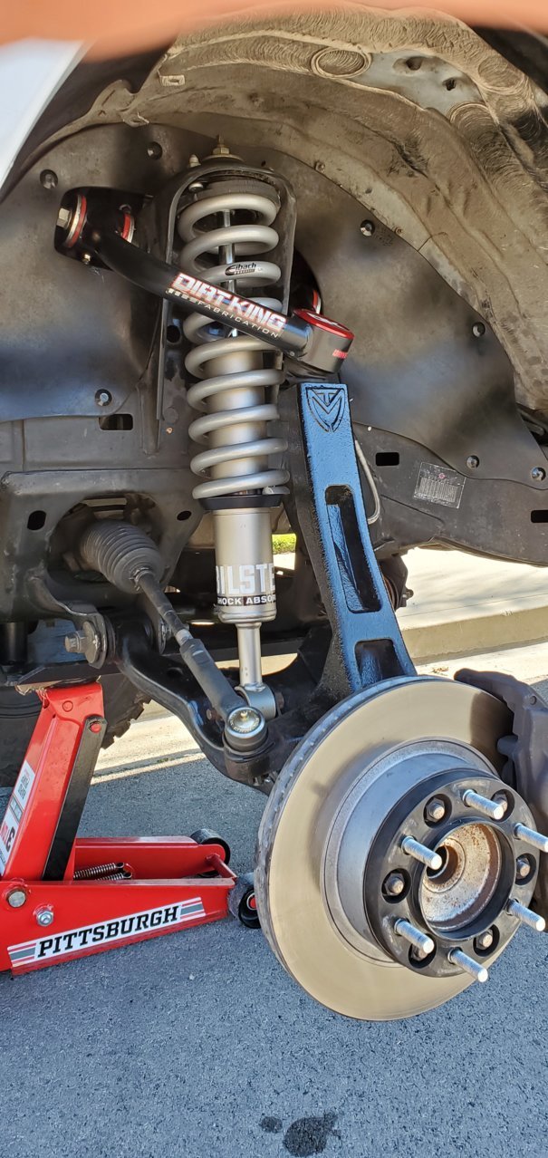

    Before...
    After...
    Steel-It Coated Shock Bodies, Eibach 650lb Coils on 2nd Notch, Dirt King Ball Joint UCAs, Maxtrac Spindles, Custom 6" Alcan Leaf Pack

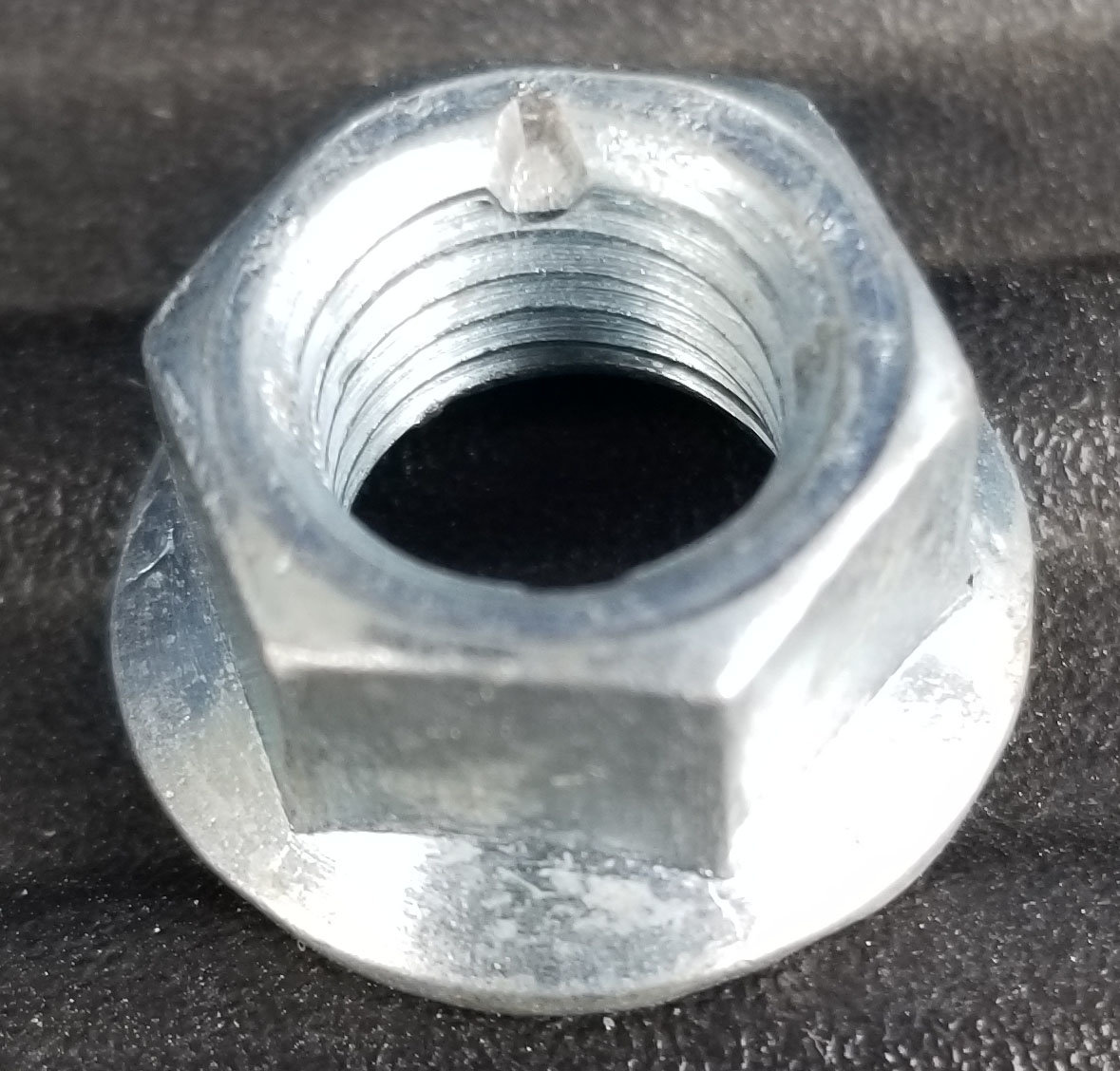

    Okay, I got most of my parts in...question on these though.
    The three top nuts on the front shocks all look like this...every one of them. This seems wrong to me, but should the thread be punched down on these like this?? I can't hand tighten them down at all.

    I have never seen them like this. Those didn't come with mine. I would replace them with the grade 8 equivalent at HD. Just my 2 cents.

    Those are self-locking nuts. Once you get a few threads on it is engaged and from there you will have to use a wrench or socket....unless you're the hulk. haha

    I've never seen a locking nut like that - it's a flange nut with the serrations on the bottom. The only locking nuts I've ever worked with are the ones that have a nylon insert. These look like they would mess up the thread on the bolt =/

    This is quite common in suspension areas as nylon may be affected by heat, UV and other debris/oil. Also nylon wears out quickly with just a few uses, where as a mechanical locking nut such as these can be used several time. The rule of thumb on a nut like this is - if you can thread it on fully by hand it requires replacement. No damage will be done to the threads as long as it threads on smooth the first couple threads.
