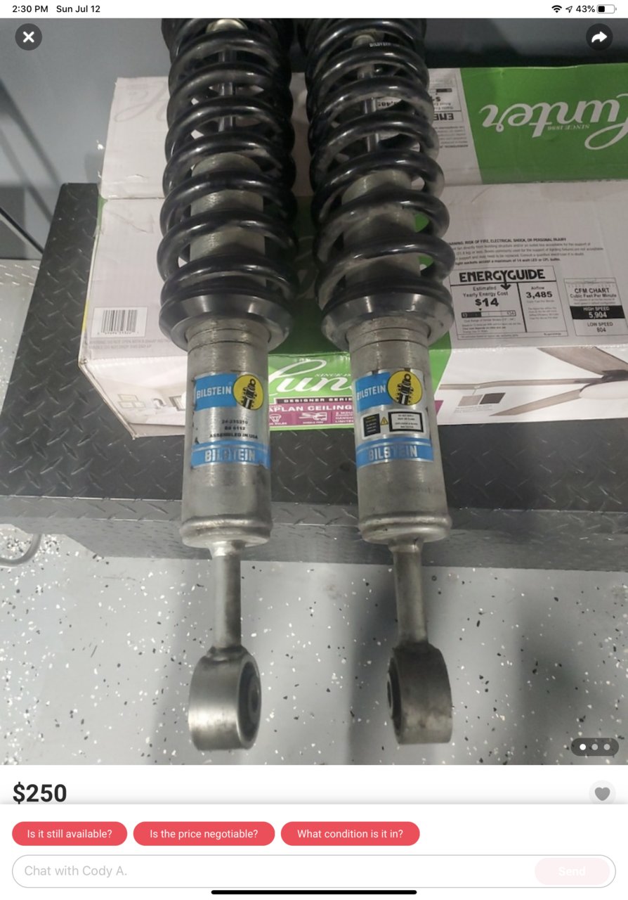

    #3824
    RubenZ
    RubenZ Well-Known Member
    Feb 16, 2020
    #319467
    452
    South Texas
    2020 Cement Tacoma TRD Off-Road DCSB
    Will these work on a Tacoma? Guy says they were for his Tundra.

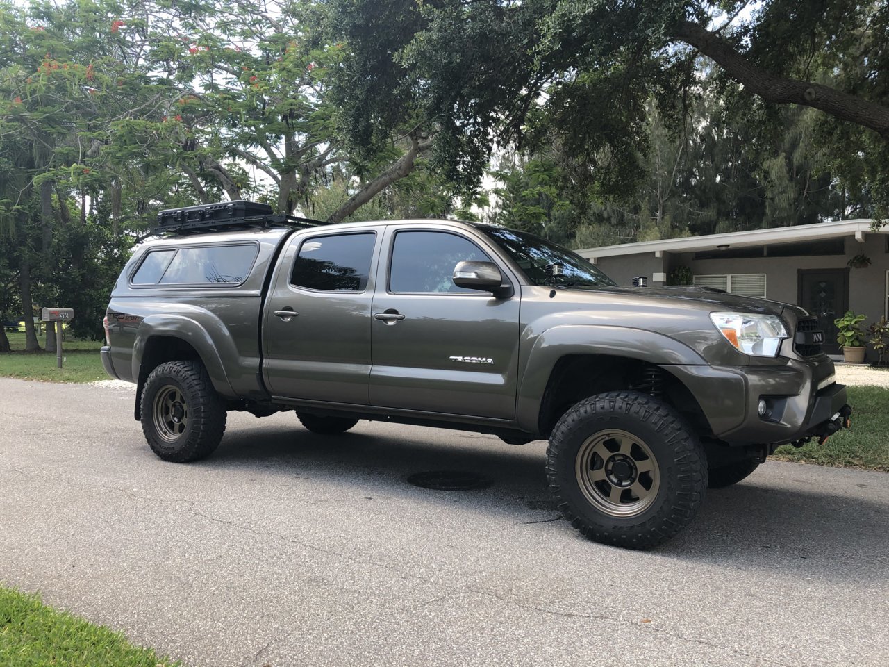

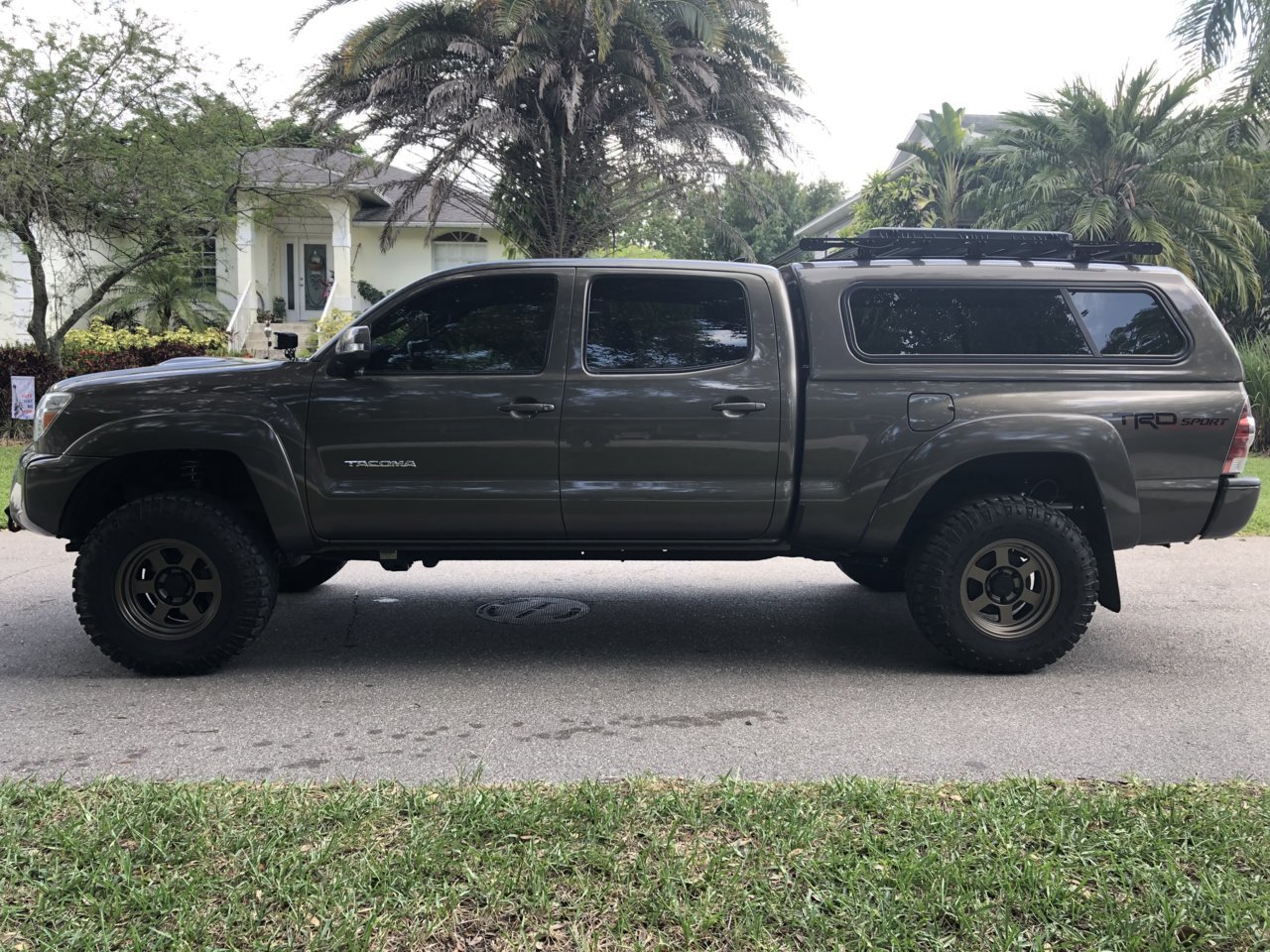

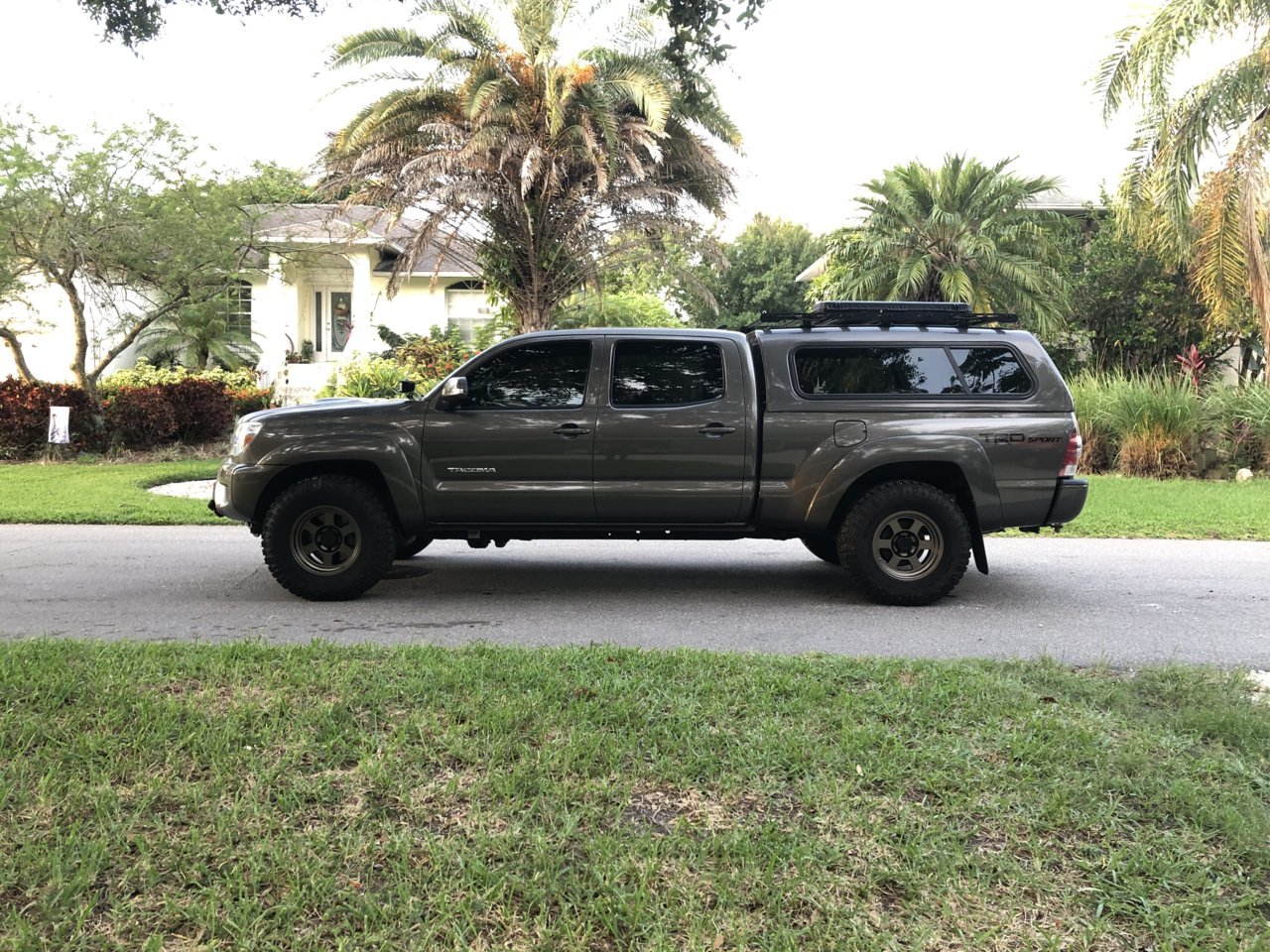

    VTacoma6
    VTacoma6 Well-Known Member
    Mar 1, 2016
    #179939
    205
    Vince
    Florida
    2015 Toyota Tacoma Trd Sport 4x4
    16 inch Matte Bronze FN Countersteer Type X wheels 0 offset With Goodyear Duratracs 265/75R16
    Eibach 650lbs coils
    Bilstein 6112 @ 4th setting front
    Bilstein 5160s rear
    SPC upper control arms
    OME Dakar medium leaf pack
    FCF47478-8117-456F-8335-1AC38C9C5A29.jpg E0A56A28-2EB1-4299-BF03-B5C131BA778F.jpg A029F3A6-22E2-4C82-9AF4-9562C5599CAD.jpg
    JRYTacoma, GMAN62465 and crackils like this.
