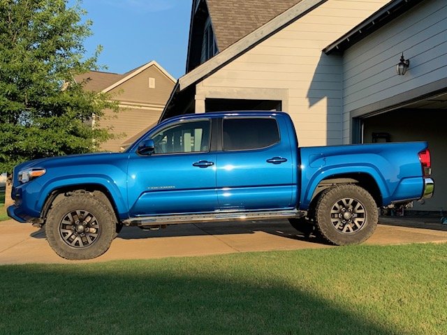

    Been researching a ton of ways to lift my truck over the past couple weeks. It seems you guys have a lot of positive things to say about the 6112s. My understanding is that on the 6/5 setting you get 2" of lift. Is this what most are seeing? If I go with the 6112s, I will do 5100s in the rear with a single AAL. Also is this the best bang for my buck? My truck as it sits right now

    Sounds like it would be a good set up. I've heard the 3 leaf AAL is better than the single. Regardless the truck will handle/drive much better with the 6112/5100.
