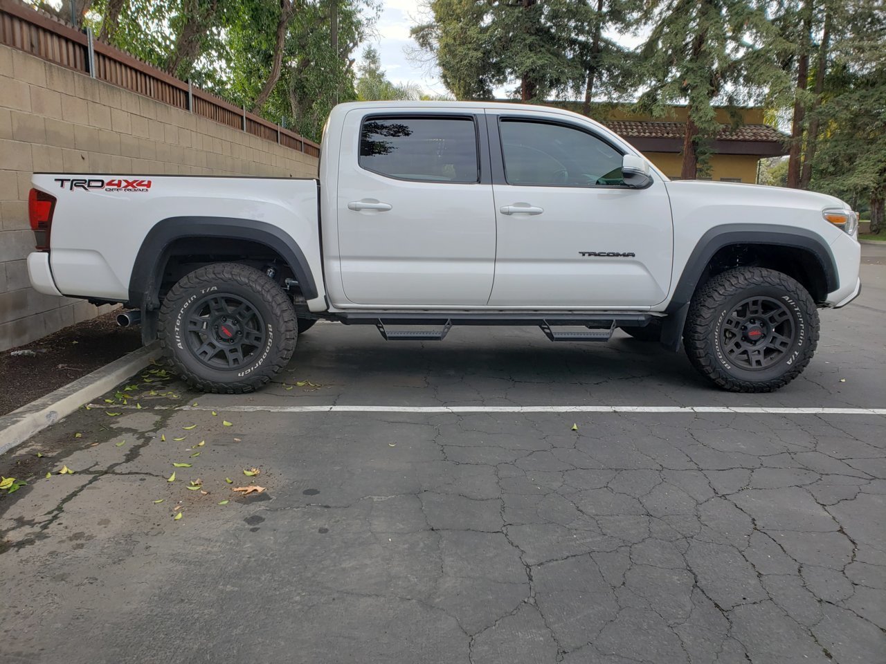

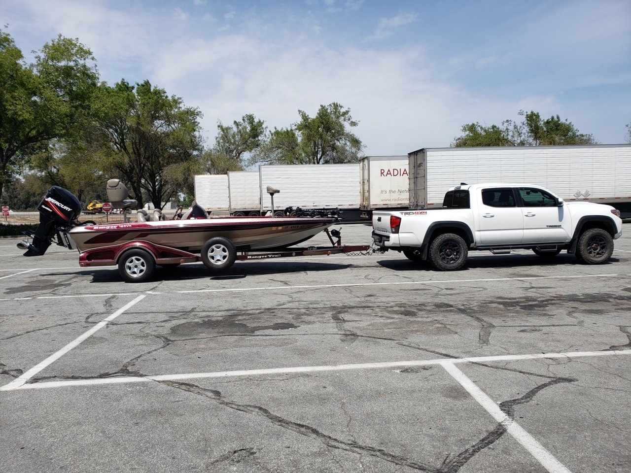

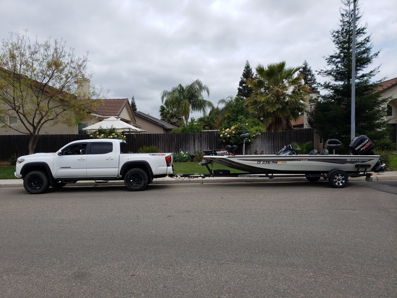

    It's been awhile since I've posted as I achieved a leveled stance back when I first received my 6112/5160, 20-25k ago. I am now having the urge to lift a little higher, do a little future proofing, as well as fix the rear from sagging so much when towing my bass boat. What do you guys think of the following to achieve no more than 1 inch of rake?
    Currently:
    6112 set at 3/4
    5160 with stock leaf springs
    Plans/Changes:
    6112 set at 5/6
    Bilstein 650lb coils
    Camburg UCA
    Dakar HD with 1 overload removed
    Diff and CB drop
    Here's how the truck sits leveled with stock leaf springs and how it sits towing my old aluminum and my current Ranger 185vx.

    Quick search turned up this:
    Also I don't think you will need the diff drop, but 2.5" in the front you may need UCA's and the ECGS bushing swap. Also maybe 3 degree shims in the rear because of the added 2" lift from the Dakar leaf pack. If you still sag with the trailer consider a weight distribution hitch. Just curious what the tongue weight of the trailer with the ranger 185vx is?

    Thanks for that. The search function can get pretty extensive. I didn't come across that for some reason. I actually quickly, throughout today, flipped through all 197 pages stopping at each picture I saw suitable and tried reading the comments before and after it. ECGS was actually done when I did the 3/4 lift. Oddly, I got the vibration the needle bearing is infamous for. ECGS fixed that up. Thank you for pulling that up for me.
    I'm going to assume tongue weight is rough 200-250lb from what similar rigs are posting online.

    Don't use a diff drop - they cause more problems then they attempt to solve. And they don't solve anything. It's a non-issue.
    You may or may not need to drop the CB - wait and see if you have any issues before doing anything.
    As for rear lift, have you considered air bags? My truck is rather heavy, and I tow several different trailers (each a different weight.) I use the air bags to level the truck - they work quite well. Easy to adjust, they don't increase ride harshness. I am very happy with them.

    I have not used airbags. I have some Sump springs as of now and while they help some, it still doesn't fix the problem completely. I am using the 3rd gen specific so they're a little shorter so there's still some sag. I contemplated going to airbag route but then grew to itch to just go ahead and lift the truck and have some heavier leafs.
